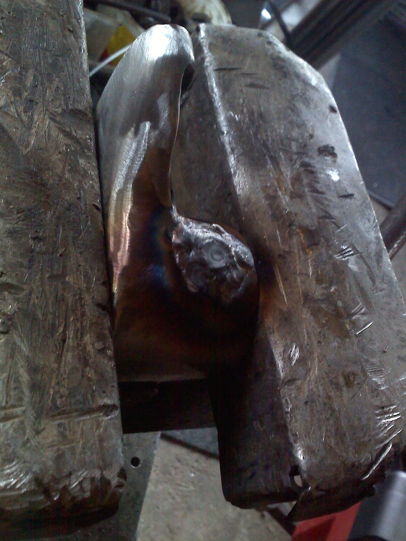

    The only tricky part were these divots.
    I experimented with some 309 TIG rod and it blended very smoothly.

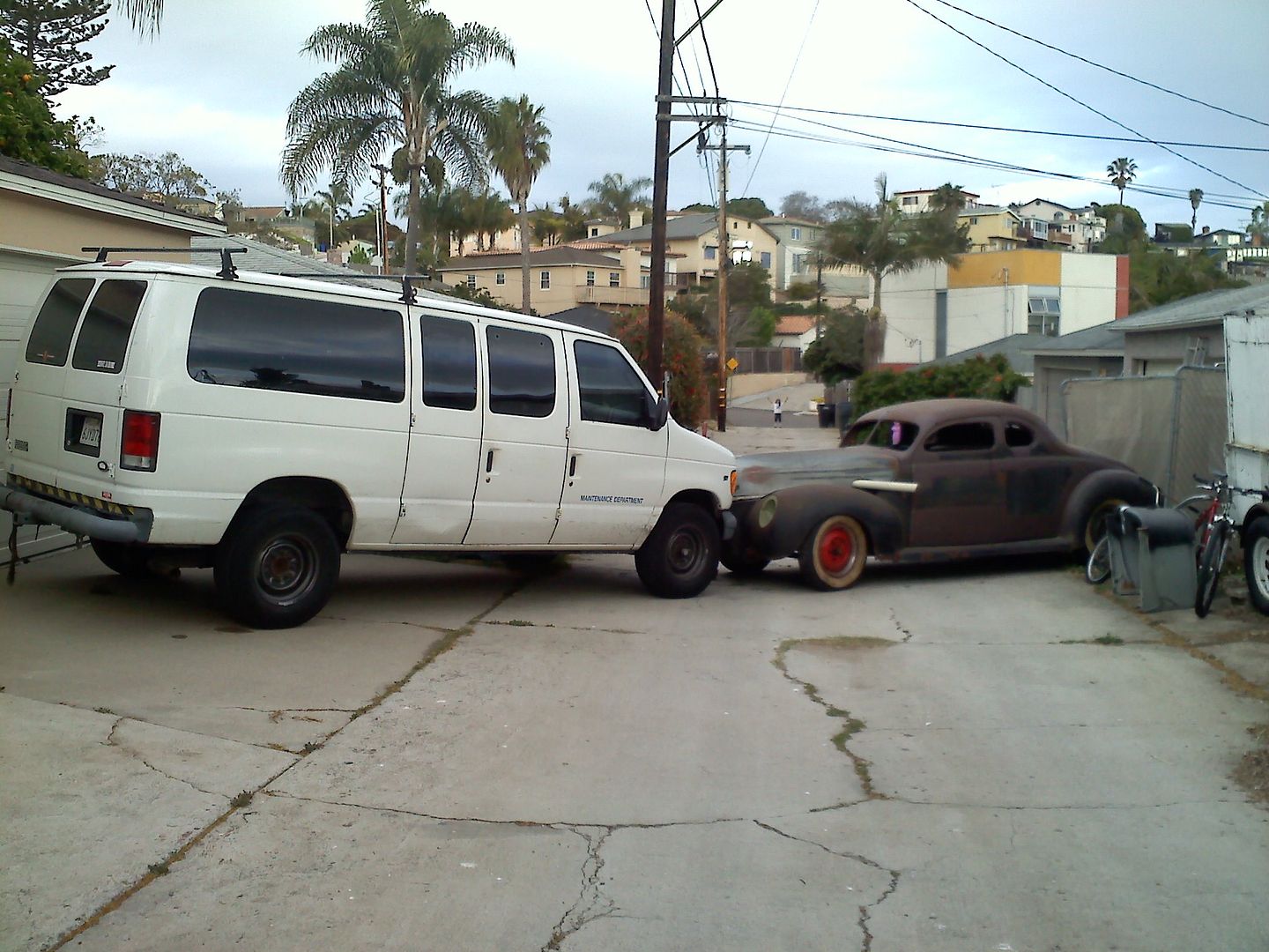

    Here's a long awaited update!
    The kids and I pulled it out of the side yard,
    and got the van stuck between the neighbors garage.
    It would have been easy to push it back,
    but we just used the old jack sliding trick.
    From here it's hard to see,
    but there's a bunch of unfinished welding and gap issues.
    Now the TIG can reach the car.
    ][​IMG]

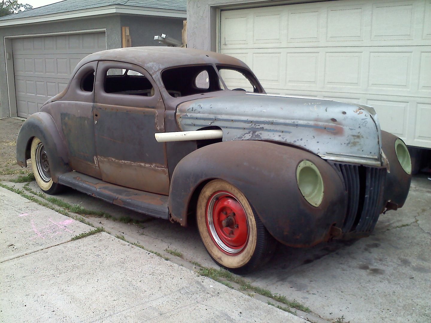

    It sat in the alley spot for a month before I got my act in gear.
    Here you can see the messed up spots on the door, the big chop seams and right above the decklid.
    This is like the only **** I see sometimes,
    and it's been bugging the heck out of me.
    After 4 years,
    it only took about 3 or 4 hours to weld up those spots.
    There was definitely a synergy going on it was like I was on autopilot.
    Basically it was tig hammer-welded,
    so there's a weld-hammer-weld hammer rhythm going.
    The inside is almost as smooth as the outside.
    Now if I ever get to work on car that's not rusty...!

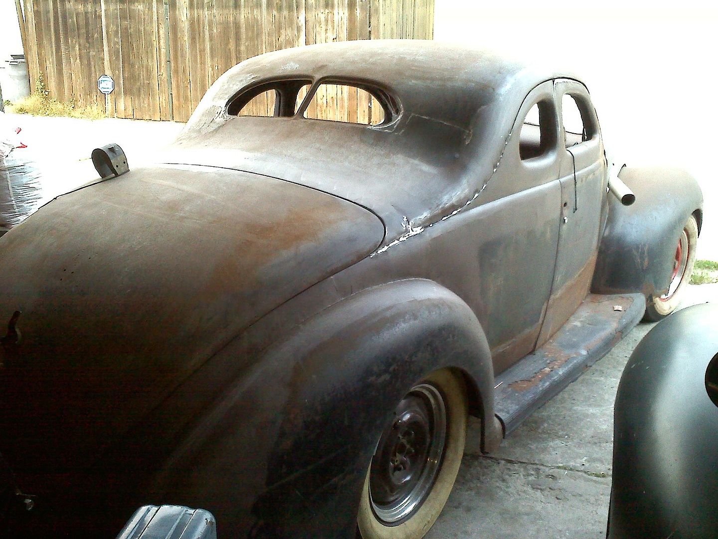

    The one issue I did have was with the door top.
    There was some serious gap filling if you compare the pictures.
    The door top kinda wedges thicker to the back now,
    but i'll have to accept that for now.
    This all happened over a couple early evenings,
    and out here it'll get windy in the middle of the day.
    I've got this custom windscreen to help out in those situations.
    Here's a before on what's been bugging me all these years.
    Remember this was a rough chop when there was a partial shell on a makeshift dolly!
    This corner was the one with the big dent.
    There are still some crease marks visible above the cut line.
    Now it's almost presentable as is.
    Funny I never noticed that little dent right inbetween the rear windows!
