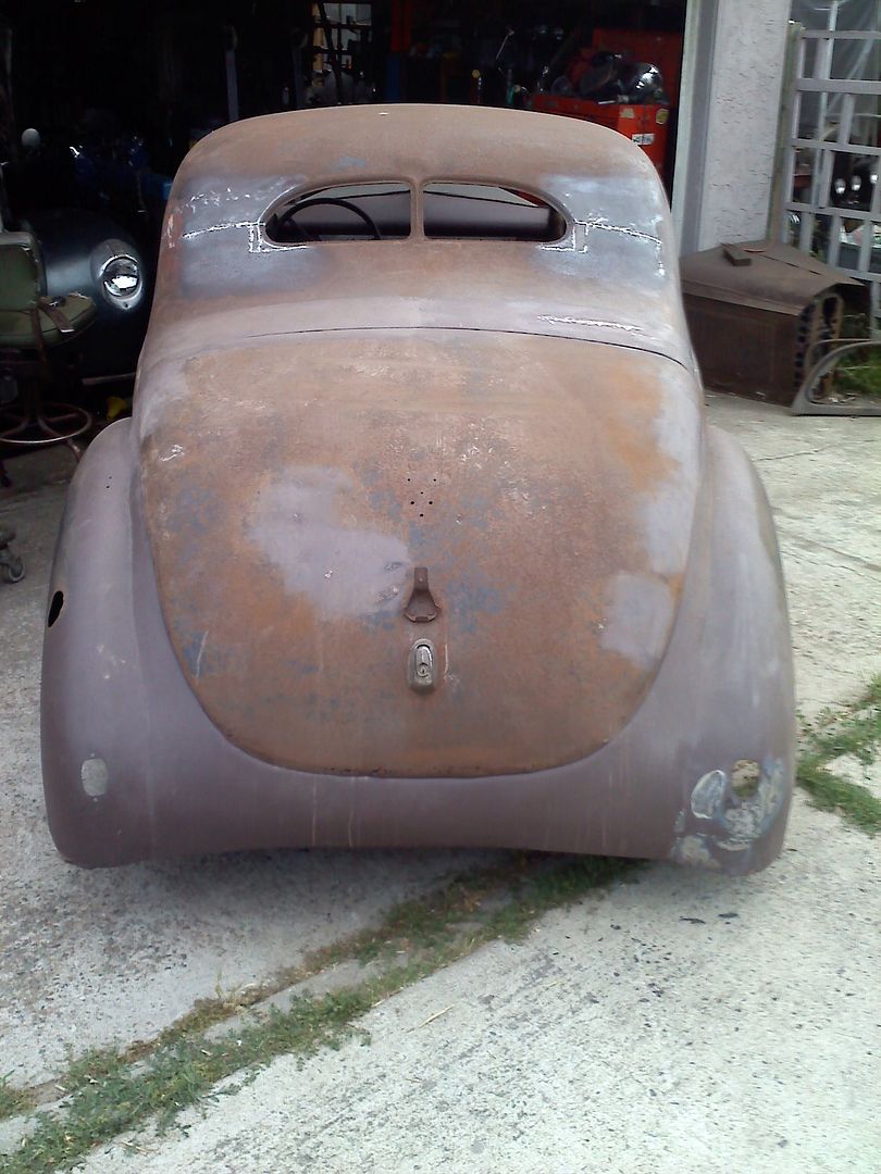

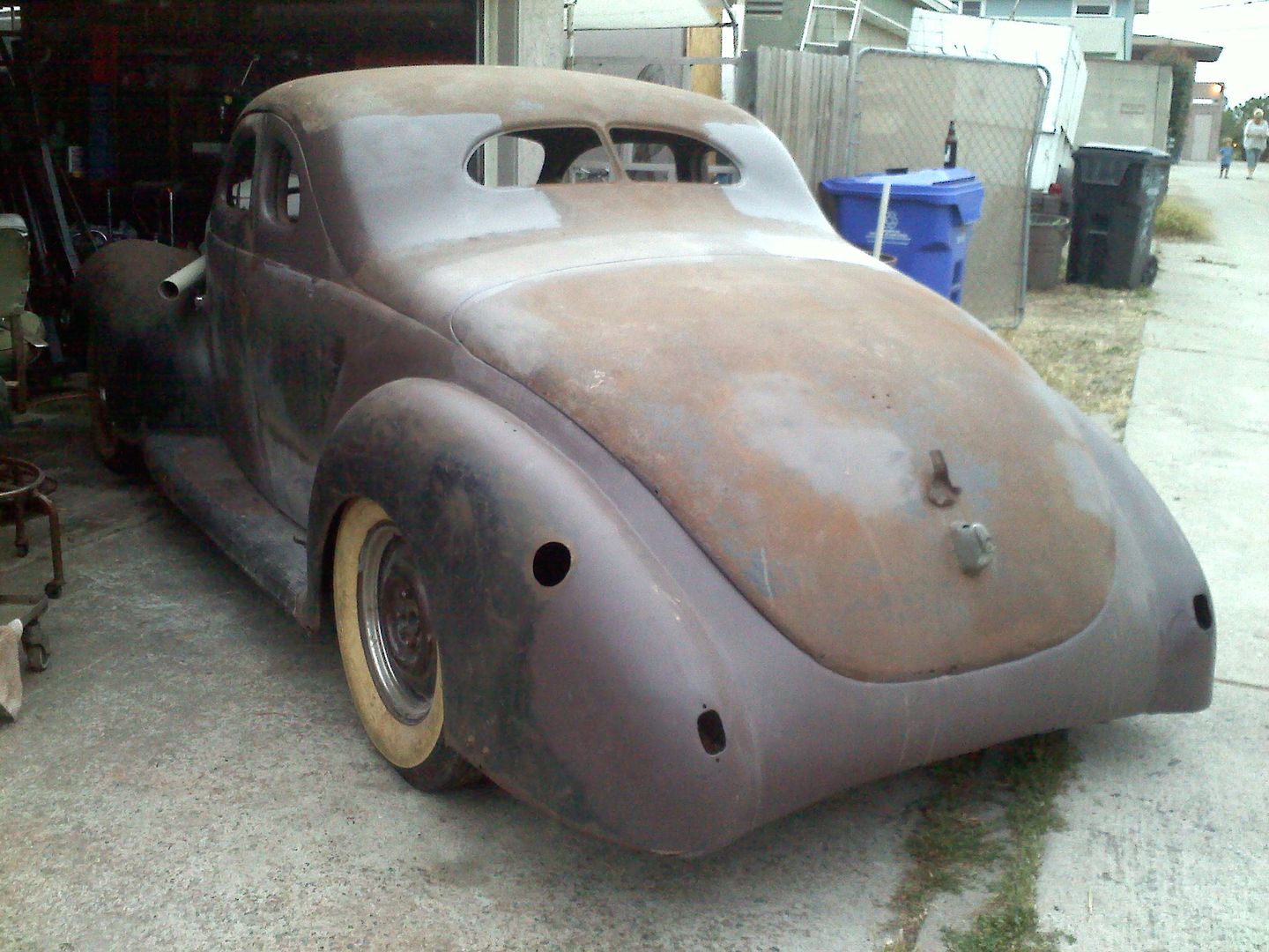

    Got a little done yesterday.
    First was trying to fix this bad sink hole.
    Not perfect but it came out a bit better.
    The tough part was the hammering position,
    and also the decklid hinge brace is right underneath the seam.

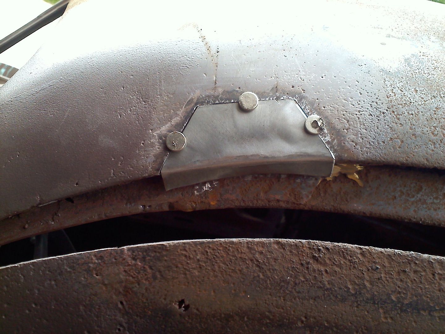

    Next was filling in those open corner spots on the doors.
    This was kinda hacked in with a piece thicker than sheetmetal.
    Everyone that sees it points to that spot,
    and asks if I am going to fix the door!
    It's still roughed in but looks good from where your sitting!
    ][​IMG]

    Next thing was to flip the car around nose first,
    enlisting the help of the original tres huevos team. (3 eggs)

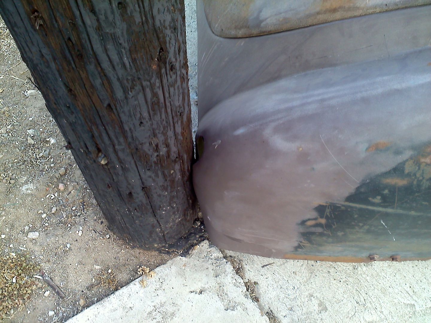

    After sliding it around on the jack,
    of course we hit the only telephone pole around.
    The kids were more bummed than I was,
    or maybe they were scared I'd blow my top!
    No problem after a couple minutes with a hammer.

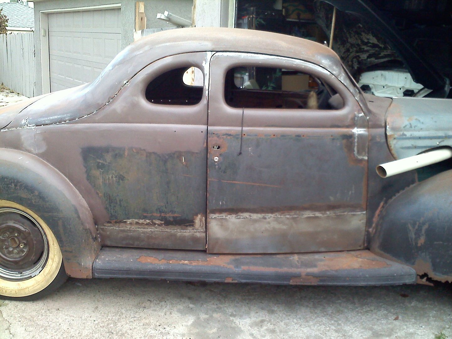

    Perfect time to pull out the chemicals.
    Had saved this beer since christmas time.
    Yeah it's a glorified budweiser product but it's tasty!
    Some sanding, wire wheeling and some rust converter,
    enough to slap on some of that epoxy.
    Not trying to hide the fact that this is rusty body.
    I don't have the funds or interest to bead blast or dip it,
    so this is getting the commercial boat treatment of OSPHO.
    It's great stuff for this type application.
    The idea is to blend in the painted parts with the rusty parts.
    Yes in other words a patina.
    Yeah I said it!
    I will be taking paypal or cash deposits for proper paint prep in the future!
    Maybe 1/2 done can come out here from OHIO!
    Anyway now it's ready for some work on the front half...

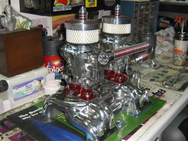

    I had a little time to think about the hood,
    so popped on the mini hoodlet.
    Then realized the hood project will have to wait.
    Looking at this picture I've got to scrounge up a 2-carb intake!

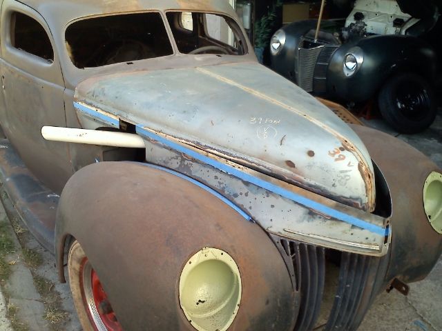

    Finally started on the hood last night.
    Opened a big old can of worms.
    The perfect father's day present.
    Earlier in the week I had removed that overlap stainless trim,
    which was propping the hood higher than needed.
    Mainly because the fenders and grille are almost 2 inches too far forward!
    Without the nose ornament piece,
    the hood had a much rounder line.
    In person the hood is very large looking,
    and I was still intent on a pie cut.
    After some careful measurements,
    the first cut split the hood in two pieces.
    Now it will be easier to get the bottom section to fit right.
    It's going to be a bunch of work.
    After looking at the pictures last night,
    the conclusion is to not section it nearly as much as I thought.
    Glad the pie wasn't cut out!
    What I think happened is sliding the hood forward that 1+3/4",
    also slid the nose down the angled grille top.
    So in addition to losing the 1/2" of the trim,
    the hood is down almost 1 inch just in a normal position.
    Now it is more a matter of getting it lined up with the body reveals,
    and then the fender gap.
    Maybe 1/2" will be pie-cut but we'll see in the next couple hours!
    Anyway hopefully some metal time over the weekend will help solve things.
    TP

    I saw the end result but never any of the dirty tricks involved!
    Most likely any added sheetmetal will be at the cowl line.
    This will be easier t******* a 1/2" or so and then re***embling it.
    That would be great!

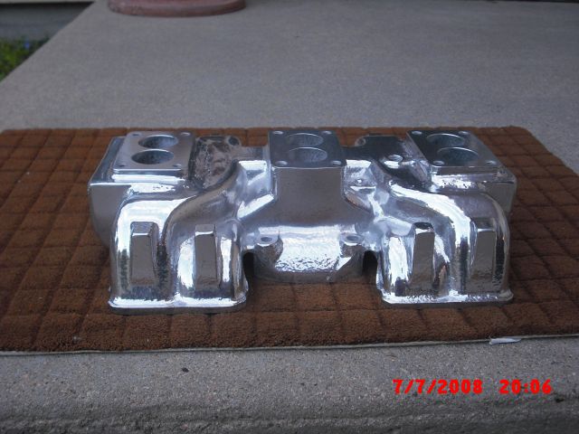

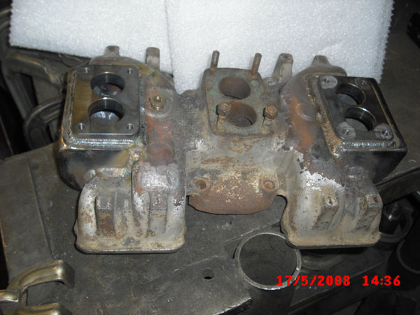

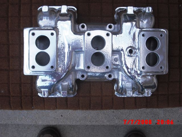

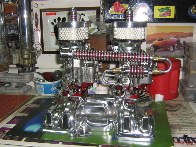

    What do you think about 3-bolt 94 style,
    vs the 4-bolt GM style carb?
    I'm on the fence to do aluminum or steel.
    I've always thought your stock mod was cool.
    You've came along way Buddy!

    Travis, I think the 3 bolt will give a little edge on the cool factor, but the 4 bolt give you more air. More air= more HP on these engine, and still look pretty cool. Here is a Burrell 2x2 I had with the 4 bolt carbs, and I think they look cool!
    Aluminum looks cool, and is lighter, but steel is easier for me to work with. Here's a couple of pics of the tri-power with Cermachrome on it, for an idea. It's not perfect, but it's functional!

    Ok guys here's a quick update.
    Don't have much time on here so may be in 2 pieces...
    One of the most important things was cleaning out the inside.
    It had become a stash spot mainly for parts for the car.
    Finally the seat could be installed.
    It was a PITA to locate the frame holes and drill the floor holes.
    I was trying to do a mechanical push,
    which as you'll see didn't last long.
    The brake parts from the green 40 were going onto this rusty 40.
    The spindles needed some modifying to accept the f100 brakes.
    This was a bummer,
    I should have replaced them with later square spindles.
    Was easier to grind for now.
    A chance internet find of (hopefully) the right window rubber totally changed my plan.
