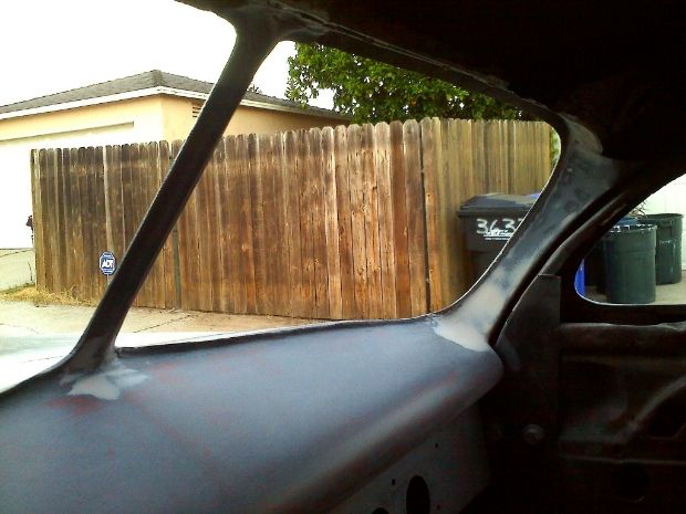

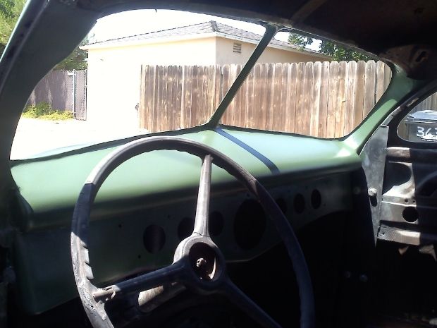

    Okay here's a the lowdown on what's been going on with old rusty.
    First off this will for sure get some shock and awe.
    I'll admit this is definitely hack compared to high end work that is posted up here,
    but this is something I've experimented with for many years now.
    I've used this same method in a salty work boat marine environment,
    and over time and abuse it has worked wonders.
    The worst case is everything flakes off and I'm back to old rusty!
    So the window rubber pushed me to figure out what to do with the surface.
    The least I needed to do was coat the frame area.
    At the old shop I had tried some sandblasting,
    and the amount of media/sand needed was way too much,
    and the rust seeded way too deep.
    A quote of $1200+- is definitely not in my budget,
    and even then I wouldn't trust them to not get lazy in certain spots,
    or warp the heck out of the panels.
    Dipping was probably the best answer but too late for that.
    Instead hours were spent wire wheeling, sanding, scouring etc. the whole top.
    After that a OSPHO rust converter was brushed on,
    and then this very liquidy wipe on sealer.
    Now it was time to cross the line.
    My favorite epoxy sealer was rolled on.
    The first batch is thinned out,
    helping it to seep into the grain.
    I did say rolled on!
    These little rollers work wonders.
    The trick is to roll right before dusk,
    then there is less chance to get the rolling ridges.
    Also this slows down the epoxy kick and it seems much stronger than a hot batch.
    After that the majority of the primer was sanded off.
    Basically it's a filler primer.
    A different color coat rolled on after that.
    This is an unthinned layer.
    After some sanding,
    I filled some minor pits and dinks with this crazy epoxy filler.
    Totally different then polyester based it takes 3 hours to harden,
    and a batch doesn't kick off on the plate.
    The idea is to get the epoxy to completely suffocate the steel so the rust doesn't grow.
    The rain gutter area had been basically tacked every inch.
    Very difficult to do as the gap was quite large.
    My first thought was to use a soft filler that would give a little,
    but this stuff is super strong and if it cracks it cracks.
    Again the majority of the second coat was sanded down,
    and the third grey coat rolled on.
    Supposedly this stuff takes 3 days to cure,
    but is sandable the next day.
    Each coat was slapped on as close as possible to keep the chemical bond.
    Crazy chit this stuff is.
    Earlier I had mixed the grey and red to make the brown primer that was rolled on the back half.
    Now I'll let it cure up and not think about it.
    We'll see how long this lasts!

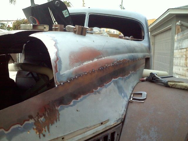

    Now for some metal cutting.
    These were the last gaps that needed to be filled,
    especially before the window install.
    A couple templates and some 1/16 sheet was cut out.
    the disintegrated seal lip needed rebuilding as well.
    both sides were welded up,
    burning off all the new paint!
    At least it was all steeled up.
    Then some primer coated to match the outside.
    TP

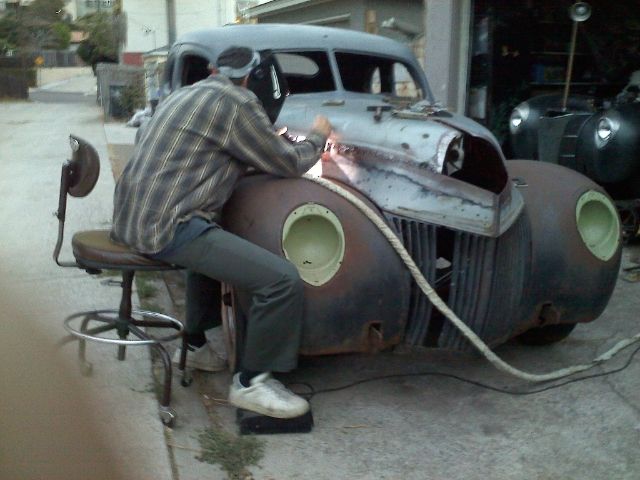

    Here's a kid pic of my high-tech facilities.
    Yeah work right on the edge of the alley!
    This fancy wind-block also shields any blinding light from p***ers by.
    Also kinda adds a little upscale chic to the whole situation.
    So every evening I'll try to get a little welding done.
    Really I'll end up removing and weld it off the car.

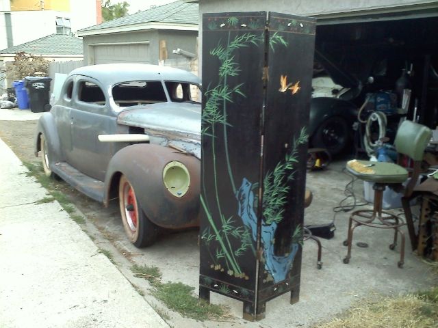

    Ok guys here's the august update.
    Again progress is slow an steady...
    Last time I updated the hood was in pieces.
    It still is.
    I had a little sound concern as the neighbors just had a new kid.
    Instead the filler that I had burnt off doing the windshield welding was replaced,

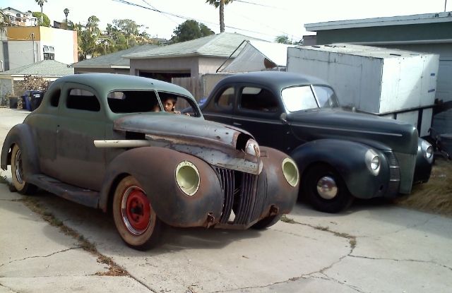

    For some reason I decided to swap the cars around,
    which meant putting the kids to work.
    Cool to see the side by side differences in a chopped and stock body.
    I'm really surprised how low the green 40 is in comparison.
    I may need to s****e up a dropped axle for the rusty one.
    Only small stuff done.

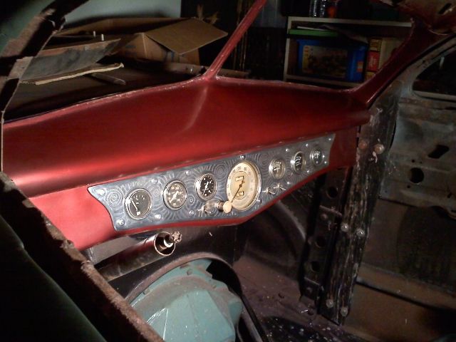

    After almost 2+ weeks of cure time,
    that green paint had finally dried up enough to sand.
    A slew of rattlecan coats ensued.
    After a couple test coats of metallic brown primer,
    the final color was this metallic cherry red,
    covered by a ton of clear coats.
    Another week went by to let things harden,
    and then some wet-sanding and hand m***aging with rubbing compound.
    The finish was just shiny enough to look good,
    and rough enough to hide any flaws.
    While I was rubbing it out...
    an idea popped up that I couldn't hold back.
    There was no turning back on this little project.
    Over the weekend I sketched out a simple pattern,
    and went to town annoying the neighbors like a woodpecker.
    I've never done any hammer engraving,
    but this was the perfect time to try it out.
    Definitely a beginner hack job.
    The idea was to not get too much detail as the insert is so huge,
    I didn't want to leave it half done.
    This took almost 4.5 hours over 2 evenings.
    Some aluminum 1/4-20 fasteners were made into ****on heads,
    and everything bolted together.
    This will be over-gauged that's for sure.
    I'm glad to have spent the time tapping that insert out.
    Way better then watching a couple movies!
    TP
    falcongeorge likes this.
