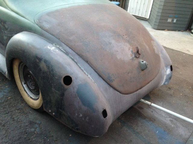

    The first thing I wanted to tackle was the rear fender seam.
    It is welded not bolted,
    and parts of the line somehow werent as straight as they should have been.
    The bad spots were cut hammered and rewelded...
    and yeah some filler was added to smooth things out.
    alot of the white was sanded off!!
    The brown is an special color mix of epoxy primer.
    Good stuff.

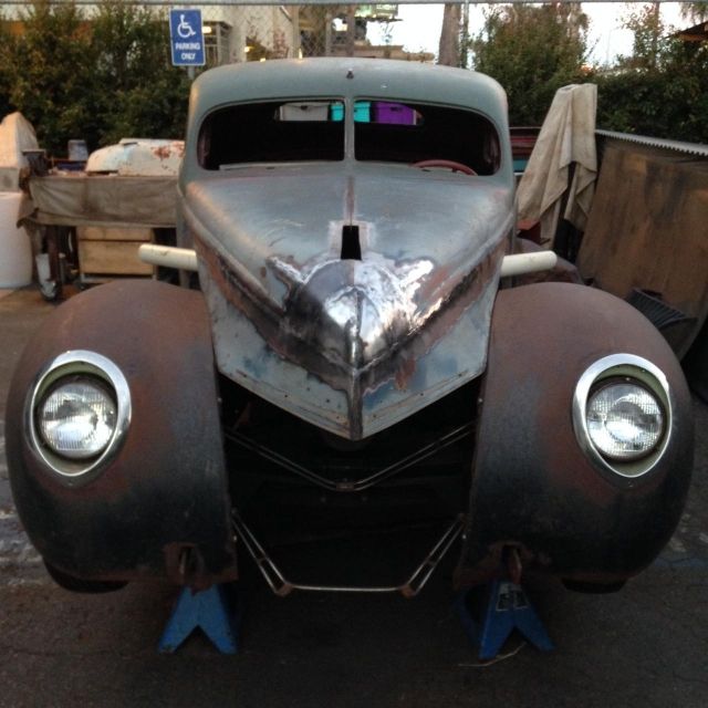

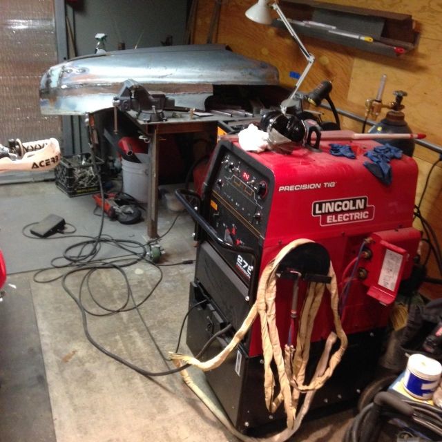

    After that it was time to start on the hood.
    Finally.
    The dang hood was bolted on,
    so there was no way to get to the engine this whole time!
    One night I figured out the plan,
    using the original cut off piece,
    only recut and welded to get rid of the center bolt flange.
    Of course this is the night it rained!
    Soon after one side of the hole was filled using super secret patch panel donor.
    Than the other side followed.
    The friend that owns the shop has a brand new transformer welder.
    Very different then my inverter Dynasty.

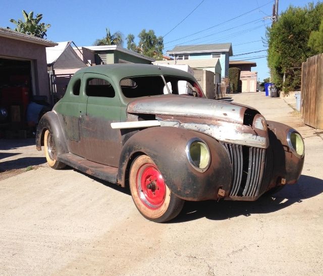

    At this point instead of going forward,
    I went a little backward.
    The grille that has been in place was a beat up wall hanger.
    It would have fit the idea for the car a couple years ago,
    but things have changed.
    The grille also was really crooked and made aligning the hood a nightmare.
    This is where I'm at now,
    even though it was a couple weeks ago.
    Still haven't made the missing center peak.
