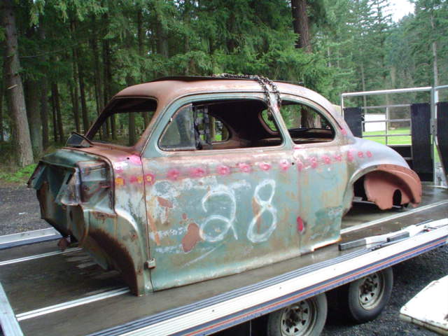

    Thanks for the update! This is one of my all time favorite HAMB threads...curious though ,when you have all in one piece are you gonna attempt to blast the rust and clean up the body or are you gonna leave the "patina"?

    Blast it,,,patch it up some more if it needs it , do the body and make her shine !! You've gone this far with it now it would be a shame not to finish it right...
  21. zibo
    Joined: Mar 17, 2002
    Posts: 2,361
    zibo
    from dago ca
    There have been thoughts of coating this thing in some kinda paint.
    I never thought it would get to that point, Just cause it would be neat as the rusty sleeper.
    I've been considering some kinda sealant/paint though just cause I live in san diego.
    The fog is thick and salty, every morning everything is wet,
    and if it ends up being an outside car (probably) it just won't last.
    The bummer is I don't know if the original steel would survive a blasting,
    without creating more patchwork, or just warping whats already there.
    So most likely I'll give it a good sanding-scotchbrite to clean it up,
    than use OSPHO, that rust converter/controller stuff,
    than shoot some marine epoxy stuff over it.
    We use it at work, and the stuff bonds to badly rusted steel that is just nail-gunned.
    On the inside i can just brush some Linear Polyurethane to seal it up.
    We'll see though...
    there are too many hours of finish welding to get to that point!
    TP

    Hey Zibo, that car is no worse, actually, it's a little better (better being relative...) than my '36 body was. I sandblasted it with my little pressure blaster and hardware store white sand at 80lbs pressure. Didn't warp anything, and cleaned up the (very badly) pitted areas that'd been paint free for 60 years in Michigan. Painted (with real paint) it looks like somebody cares.
    You've put too much work into it up till now to leave it nasty, the "patina" thing is done to death already. Please paint it.
