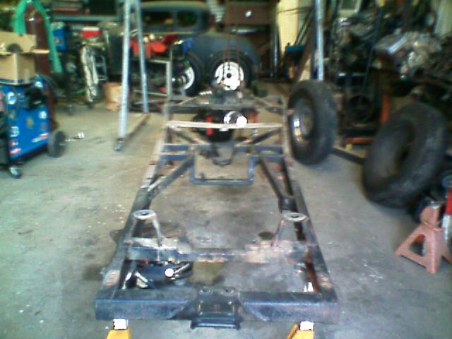

    Ok so I had to pull the 40 out of the shop to get motivated on some other projects.
    The last week or so I bailed on the sheetmetal work,
    and tried to ****on up the suspension.
    (it was never on front wheels)
    After a couple brain-farts the front-end finally came together,
    with a temporary fake spring anyway.
    Also put some steering in to make it easier to move.
    Fortunately there was plenty of clearance , just shortened the drag link and column/shaft.
    The engine looks crazy, it hadn't been out since the headers were made.
    I was really stoked cause there are no clearance issues with the scrub line,
    so it could go lower later on with some reversed eyed springs.

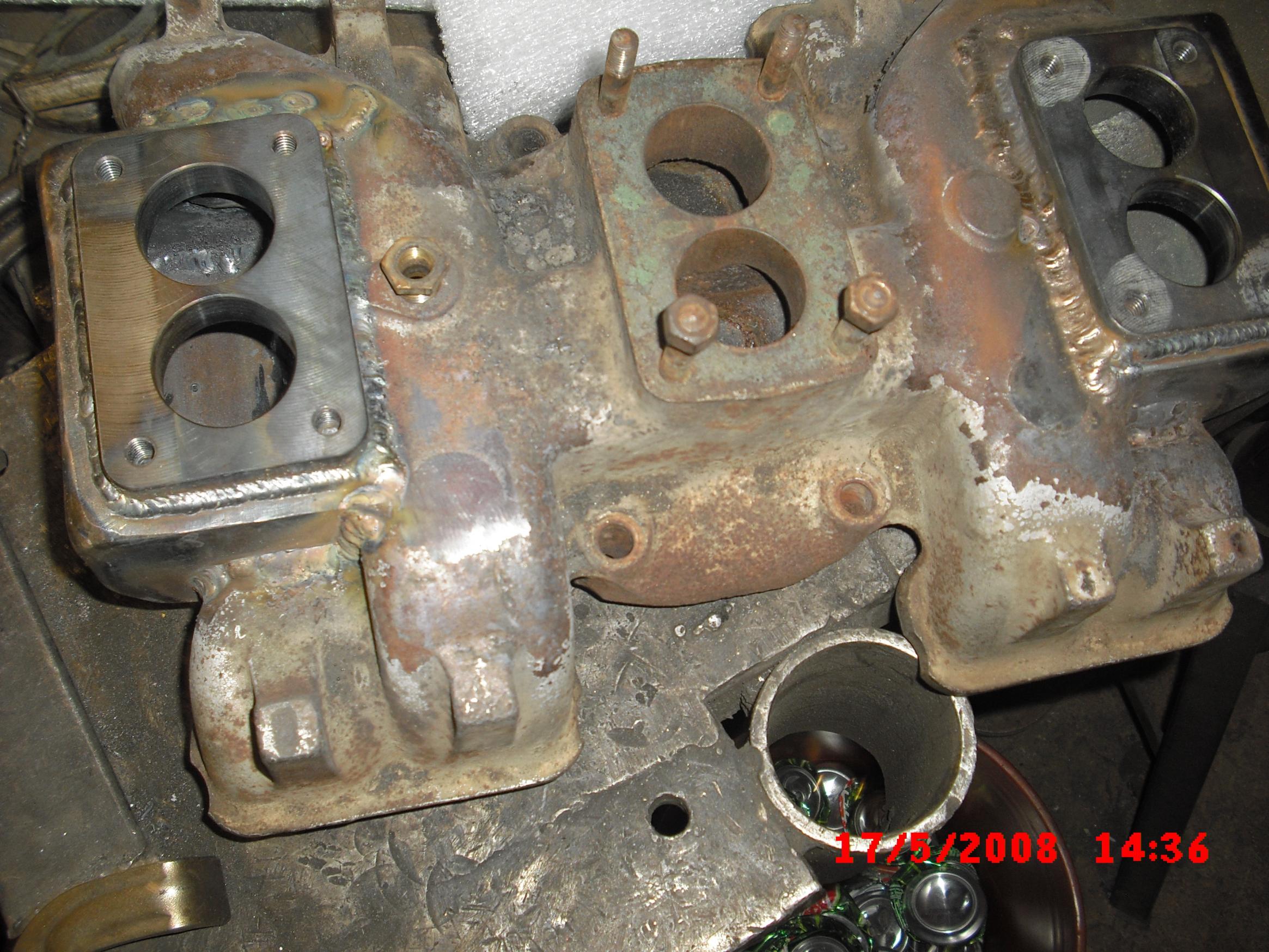

    Travis, all of a sudden this thing has 3 carbs! Or maybe that's Neal's work???
    Show us the tri-power!!!!!

    I was busy while Travis was out...copy, paste, copy, paste...:)

    I thought you made one! If you decide too, I still have two carb bases that can be welded in.

    I was hopin' someone would ask that question. I noticed it too. A log manifold for 3 carbs should be easy for someone that can make those headers.

    Yeah with a couple mouse clicks Neal has added about 2 weeks of work for me!
    (ok with the front mounted distributor about 4 weeks)
    I was thinking of a log manifold but have always heard they didn't drive well on the street.
    Any thoughts about that?
    I think it would be cool to make one out of aluminum,
    thicker 1/4" plate though not the sheetmetal kind.
    (but 38's blower would kick ***!)

    A log manifold would be easy, but unless racing, not that user friendly. Modifieying the stock intake is easy, and will probably work better!
    Travis, I have the two end carb bases cut, if you need them. You would just have to tap the threads after welding them in!;)
