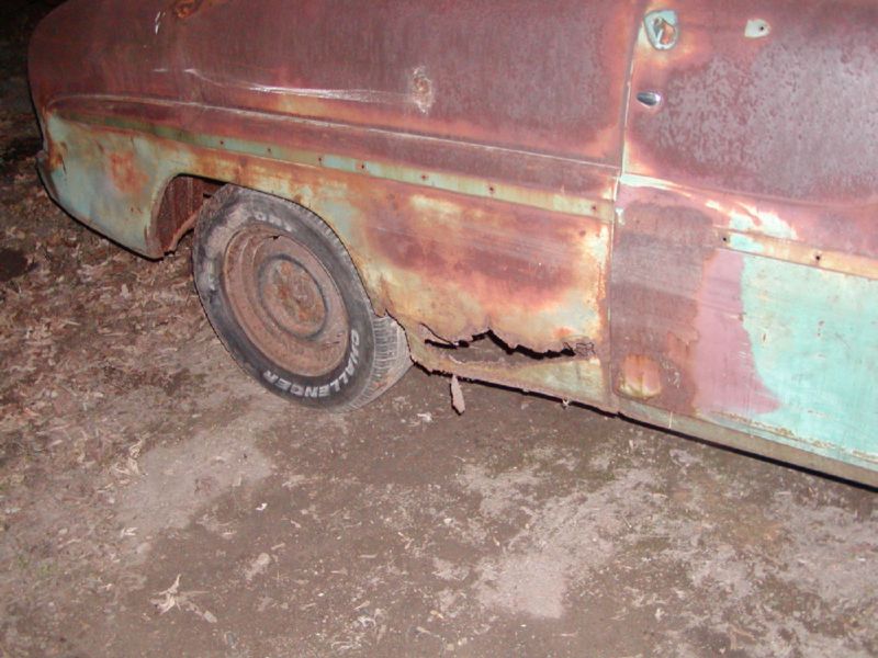

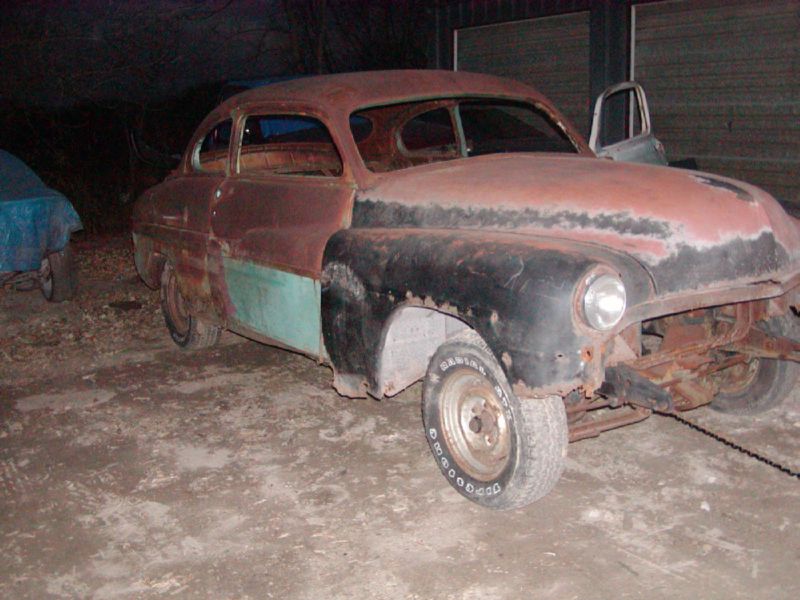

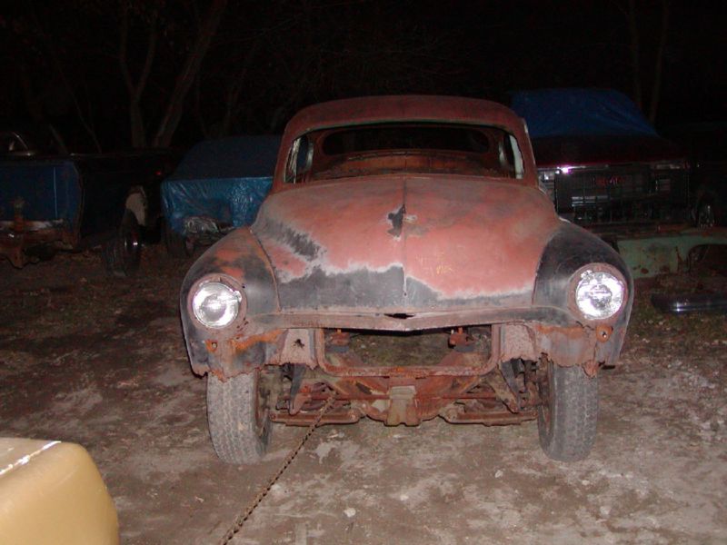

    So, I've been kinda scarce around here for a while....had good reason...been out in the shop pluggin away at this '50 Merc that everybody and their brother told me to throw out...Well now I've got some friends that keep askin fer some progress pics, so I figured that I'd oblige...been takin pics for quite some time on this with my camera phone and I don't think they turned out too terrible.
    So, first off, I pulled this car out of a field about 4 years ago, no front end, no running gear, no suspension, lotsa dents, lots and lotsa rust. I got a '51 Merc 4 door parts car for the front end, and a '51 Lincoln rolling chassis (had to cut the Lincoln chassis and shorten it 2 inches...a Lincoln is 2 inches longer from the firewall forward...welded it back together and plated it too) I wasn't quite sure if I had the time or space to take on this project, so I tried to sell it for a while with no takers, so I figured screw it, let's get started.
    So these pictures represent the starting point:

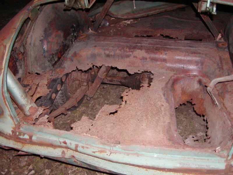

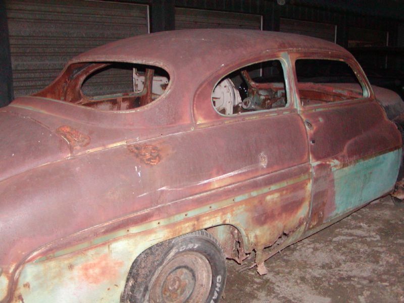

    A couple more starting point pictures:

    So I rented out some shop space from a good friend of mine (welding shop...he's in the Army and not around very much so we don't really get in each others way) and started to replace things...this is how she looked when I brought it into his place...took her apart and started replacing the floors...

    I started to replace the passenger side outer rocker, most of the passenger side rear wheel well inner, and began recreating the outer bottom lip of the rear of the car (the part that the trunk floor pans spot weld to)

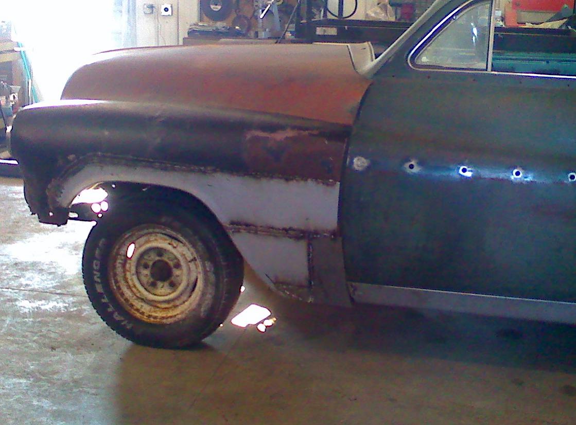

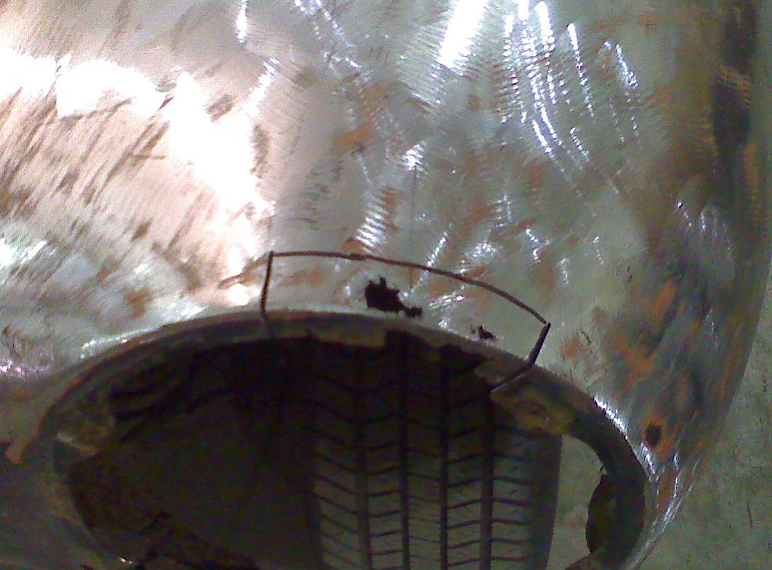

    So I also got this crazy idea to graft '55 Chevy wheel wells onto the Merc front fenders...so here's the driver's side...

    a couple more of the driver's....also started fixing the headlight opening...
