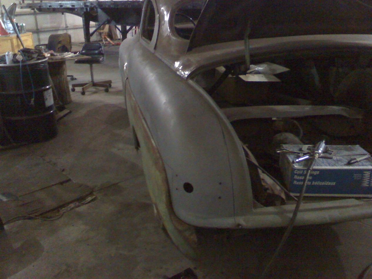

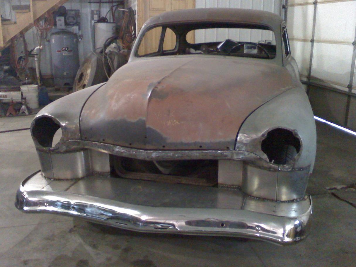

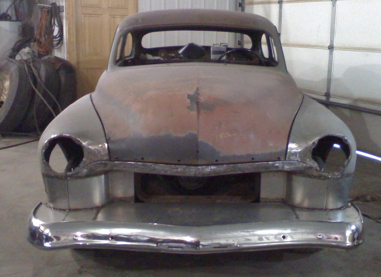

    Okay, so here's some updated pics....The front end is almost done!
    Front bumper is on after making new brackets for it (it is lowered about 4 inches from stock and brought forward about 6 inches), and I custom fabbed the new grille pan.

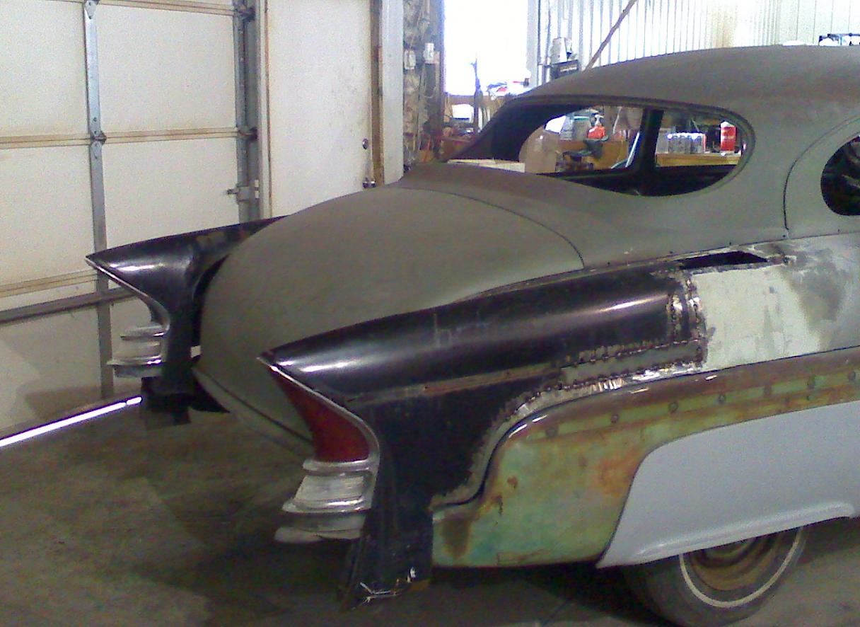

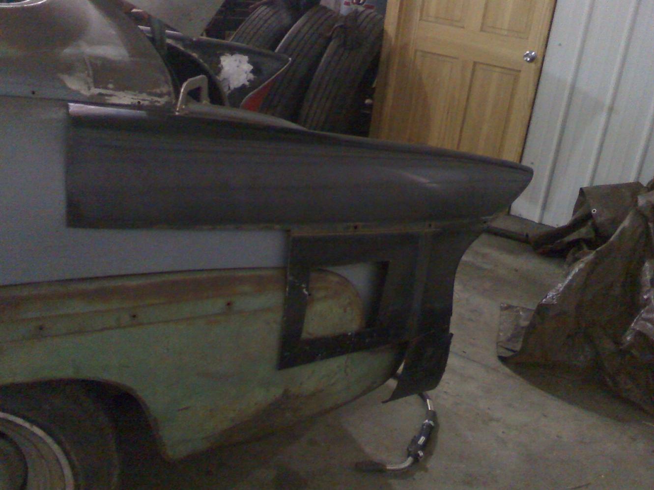

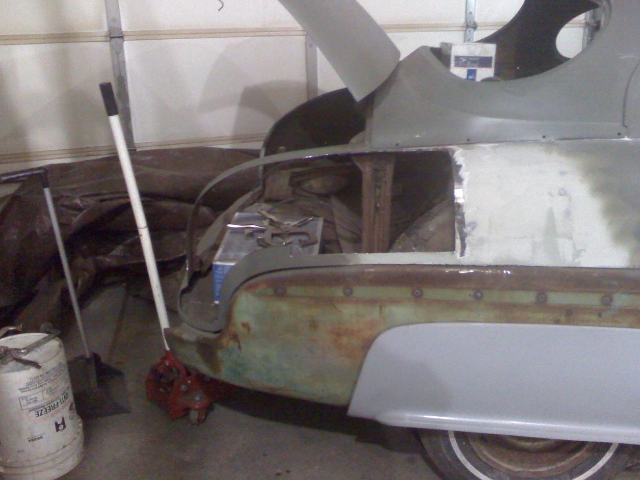

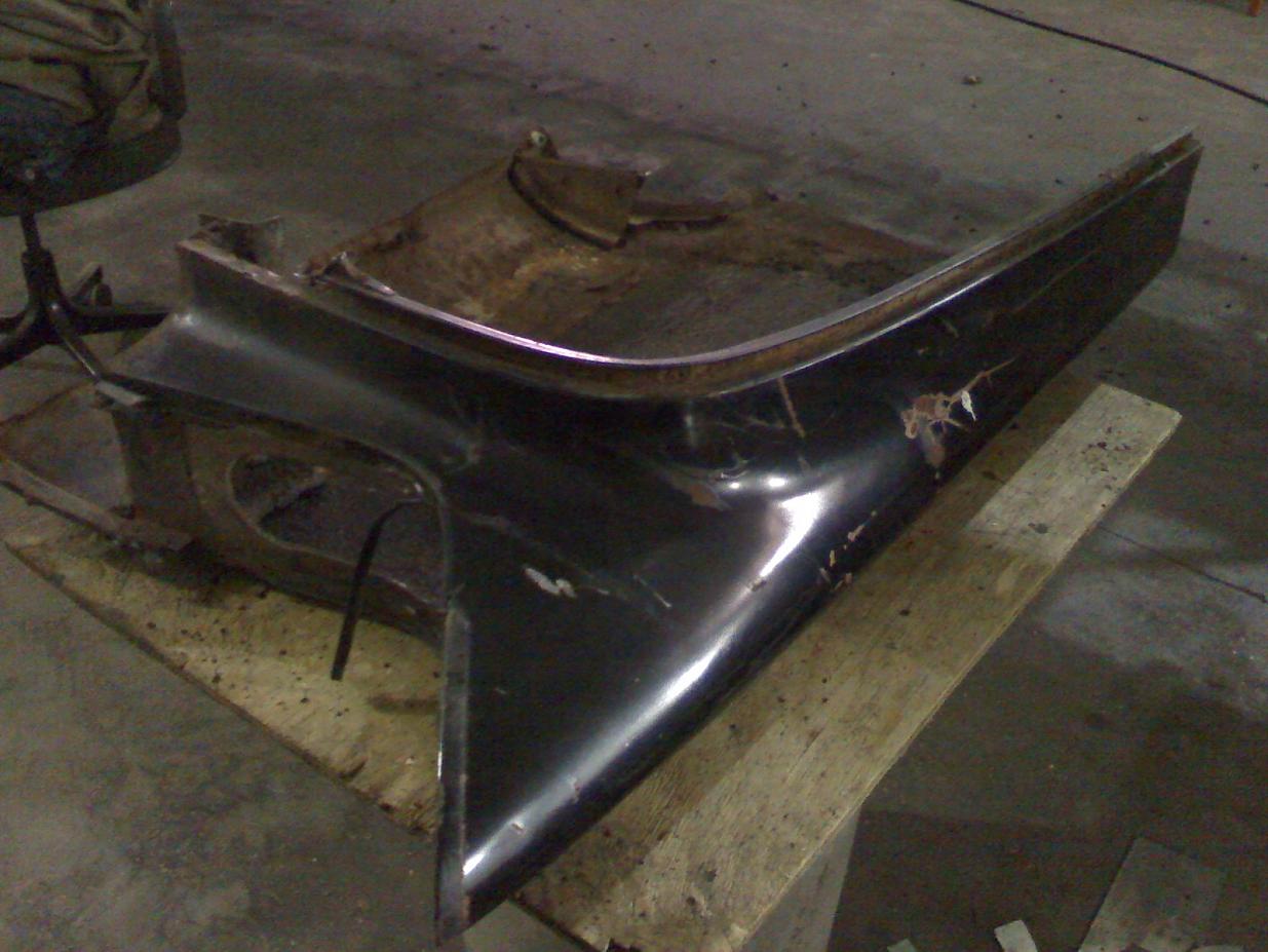

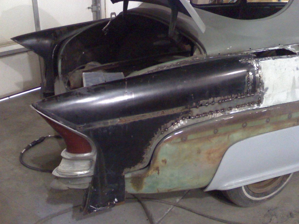

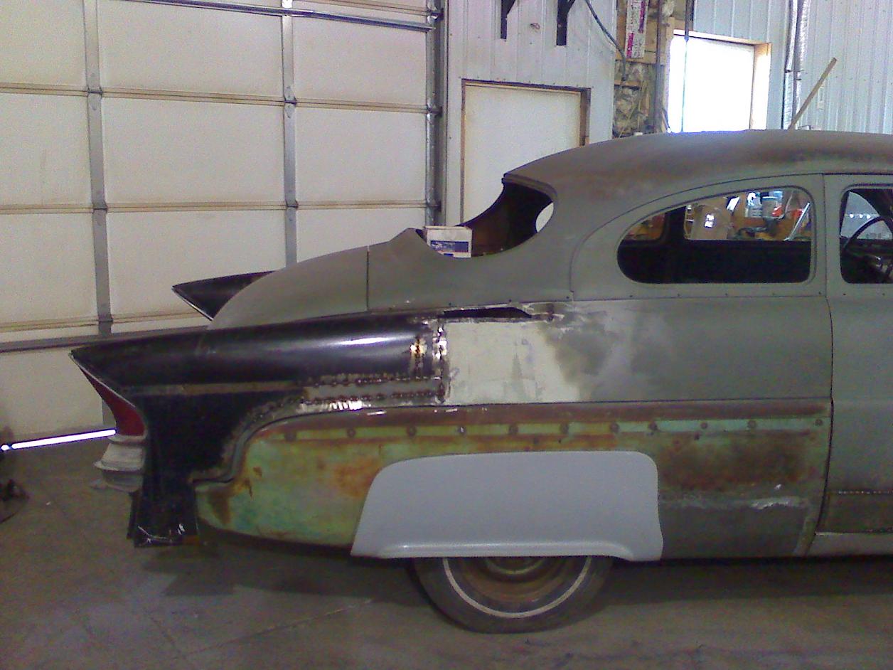

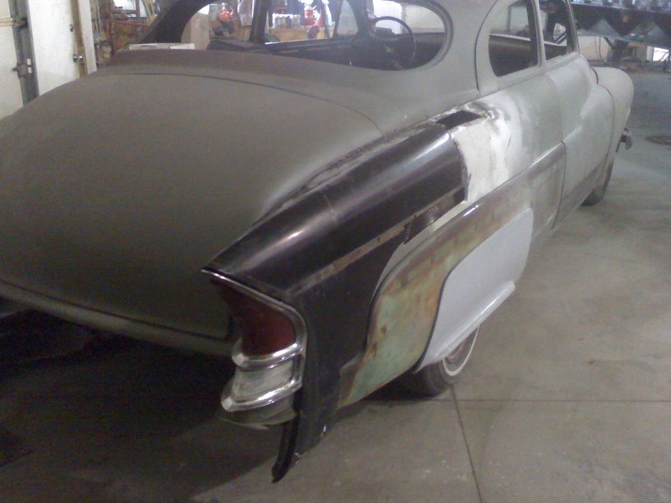

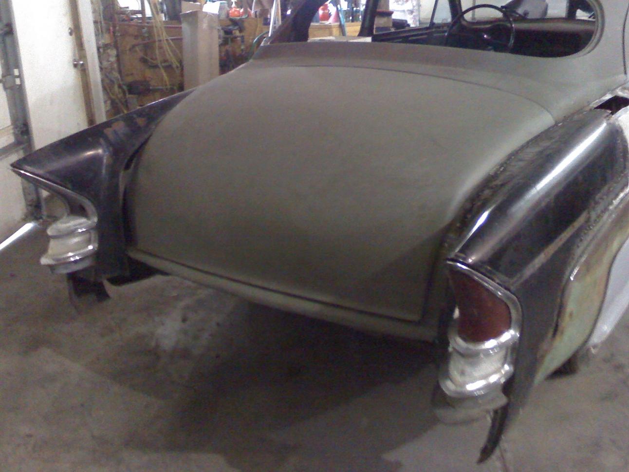

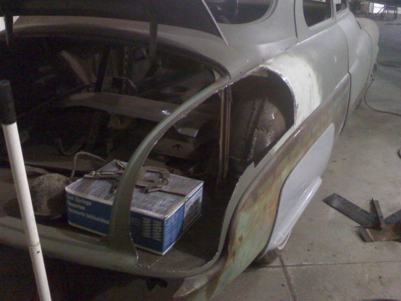

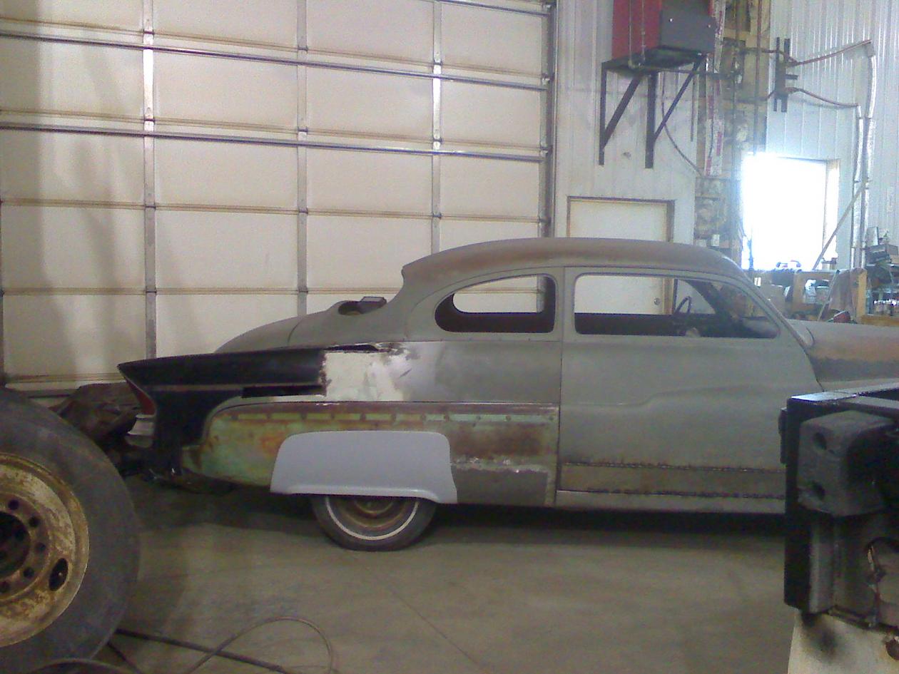

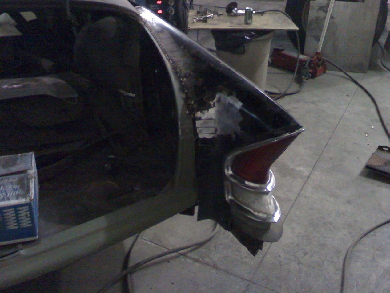

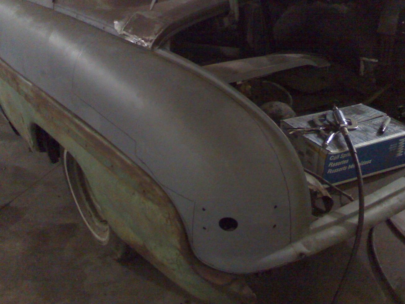

    Here's the super secret rear quarters....I got thinking about the chop that I want to do on the car - I really like the chop on Dave Paras's car - Gl***guy on the Hamb - so I'm gonna try to duplicate it - but his car is a '51 with the extended factory rear quarters, and the chop looks great on his car, but it would make the rear of my '50 look too short in my opinion. So I dug into the secret stash and now have it about 70% done....'56 Packard Clipper quarters! Here's the progress pics...First the original quarters, then the big hole that I had to cut (that one seems to make everybody nervous :) ) and then the quarters as the have gotten so far. I'm gonna use the '56 packard bumper on the back too if possible....more updates to come!
