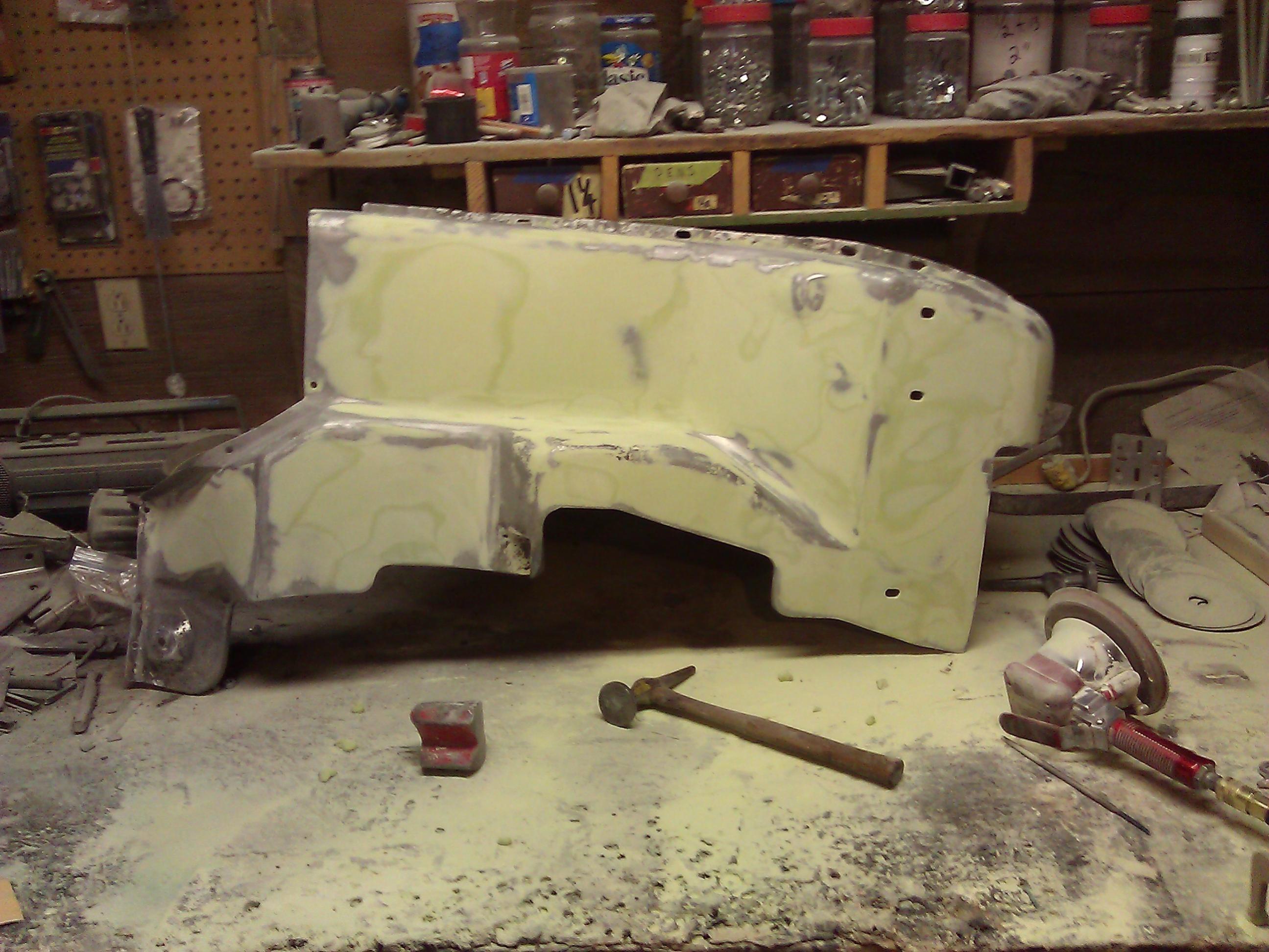

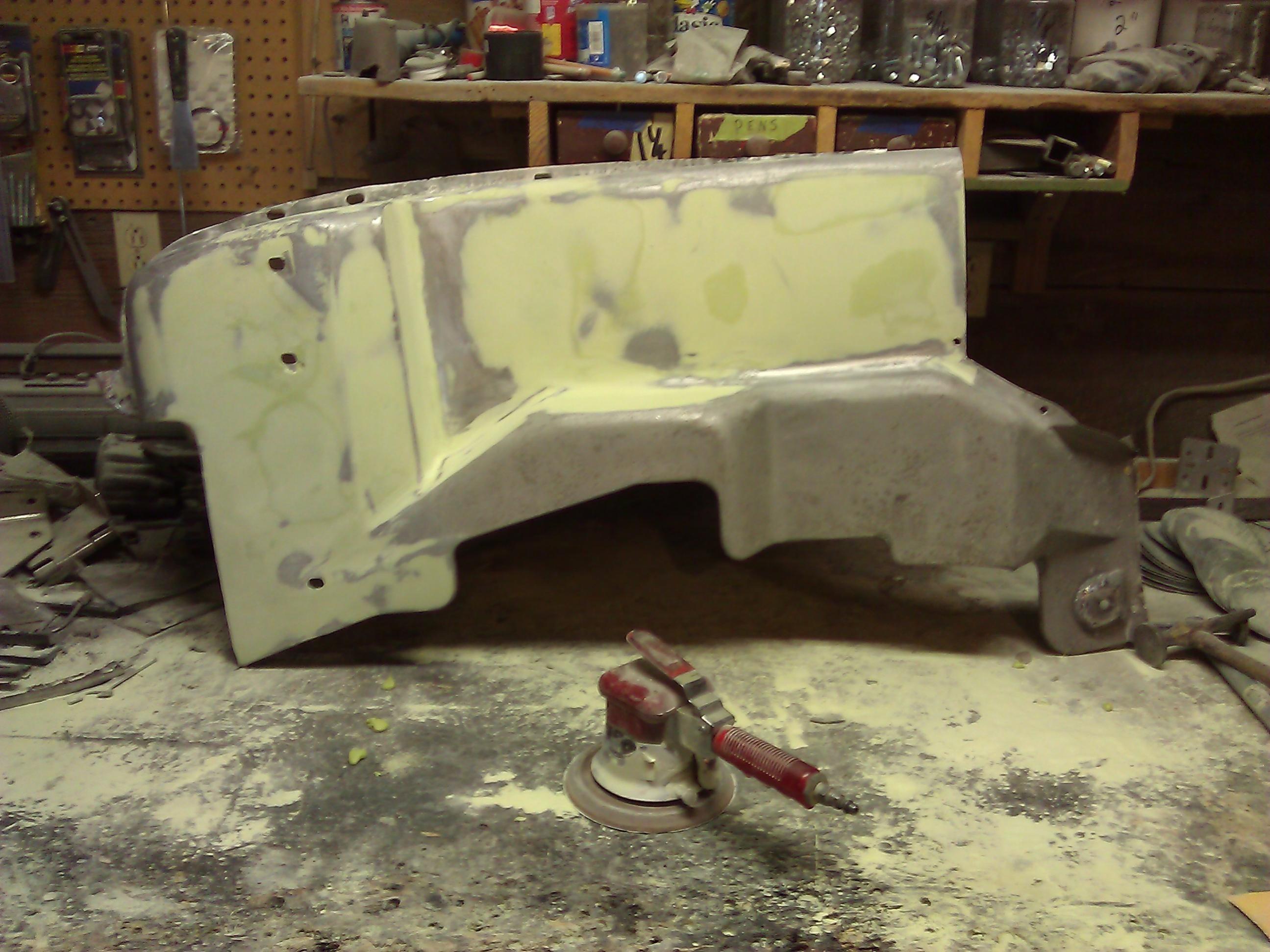

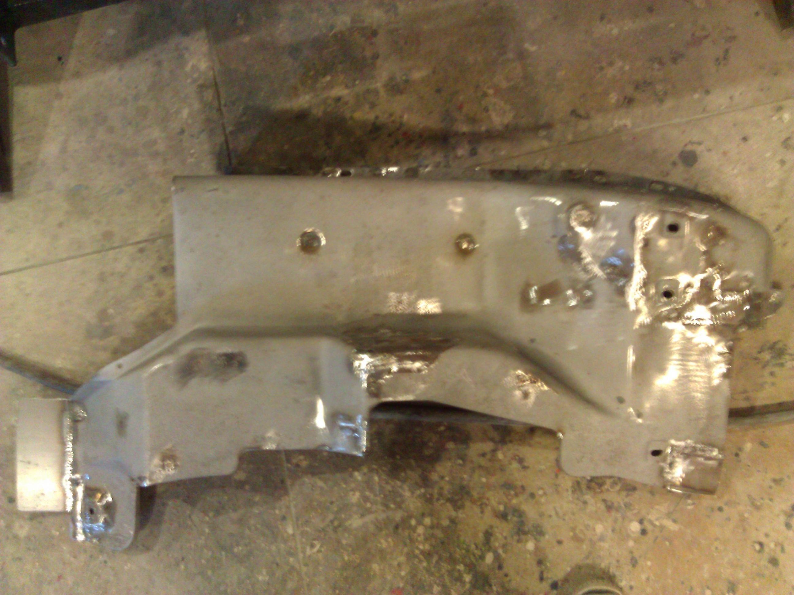

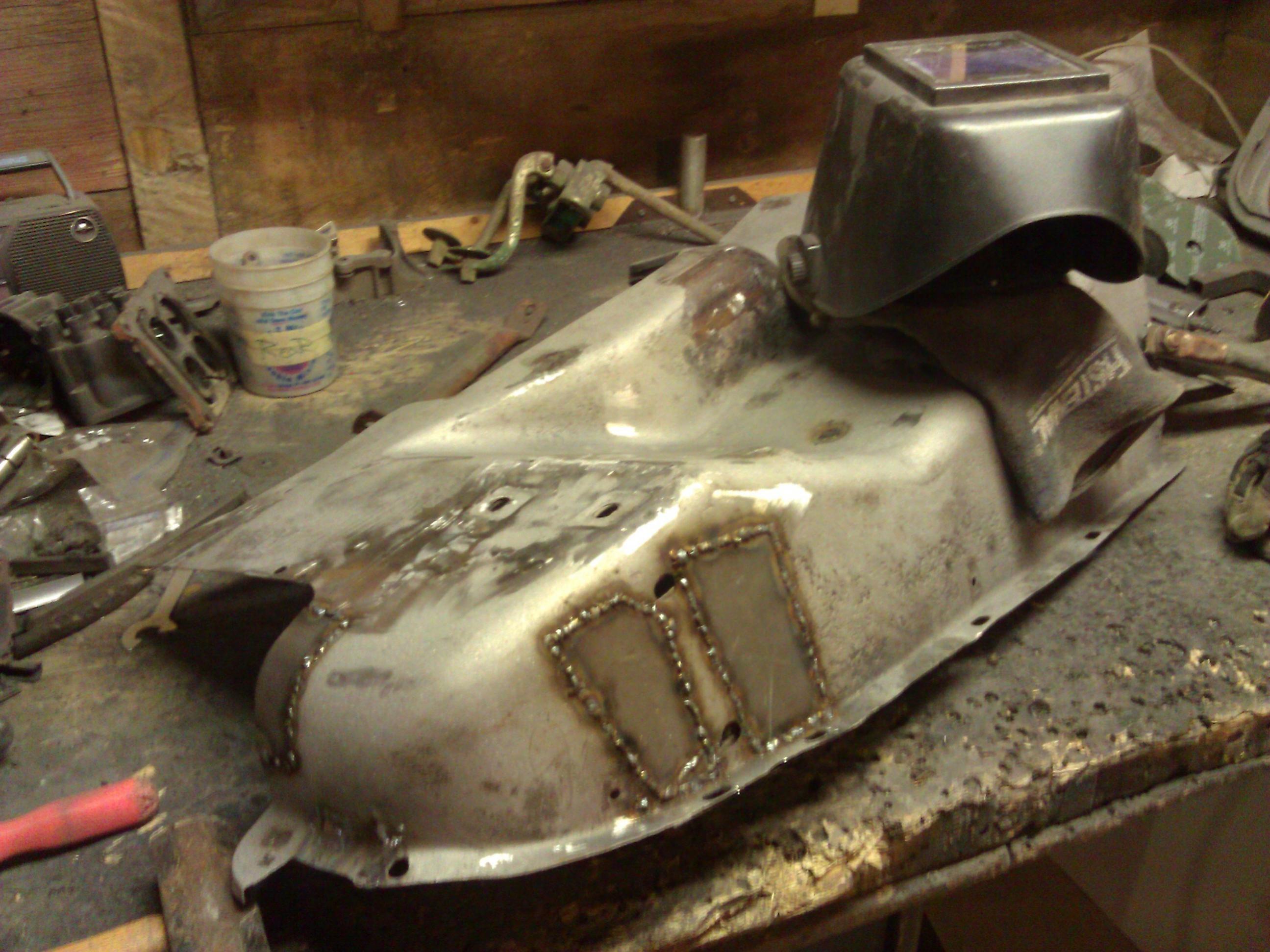

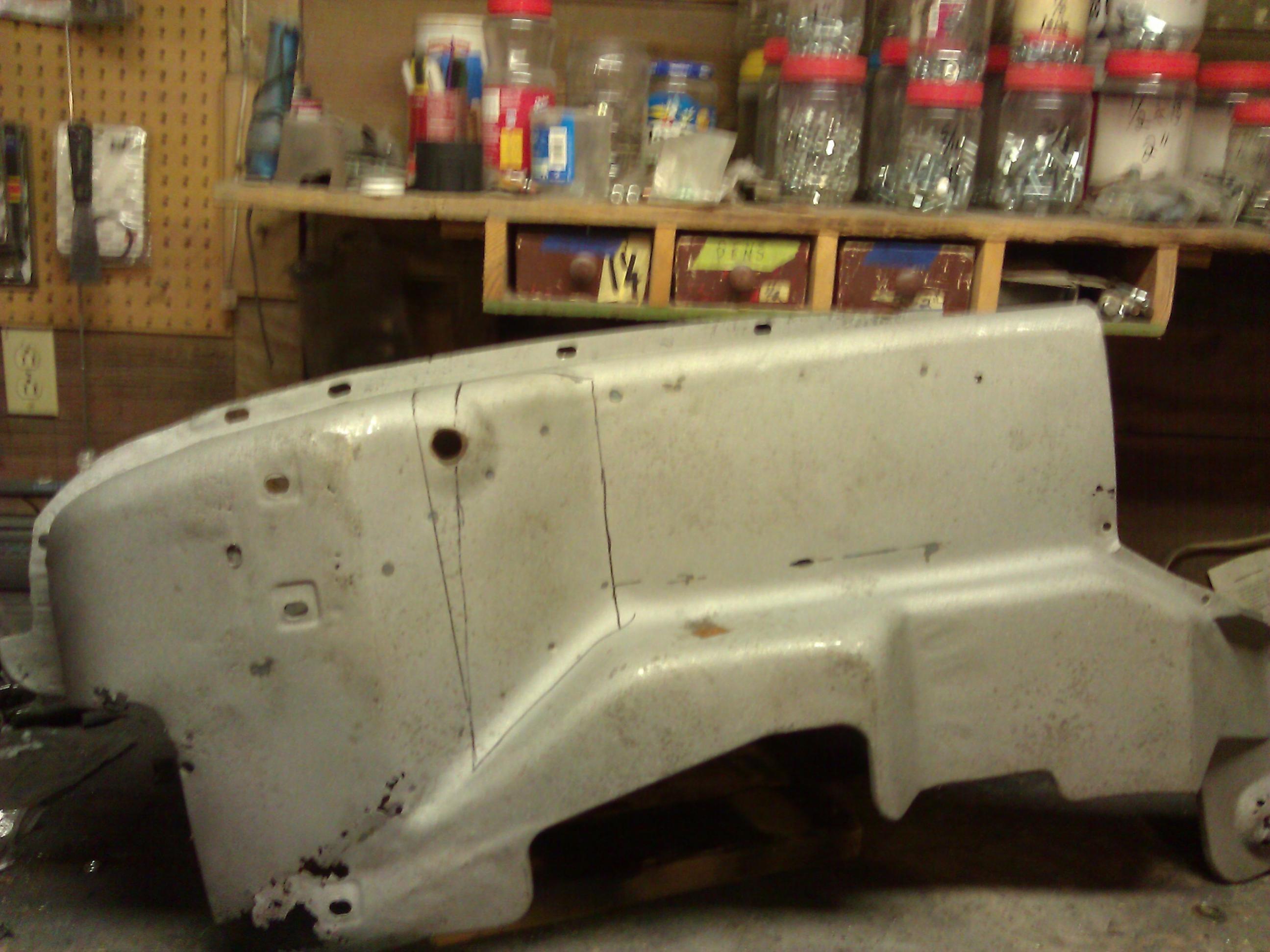

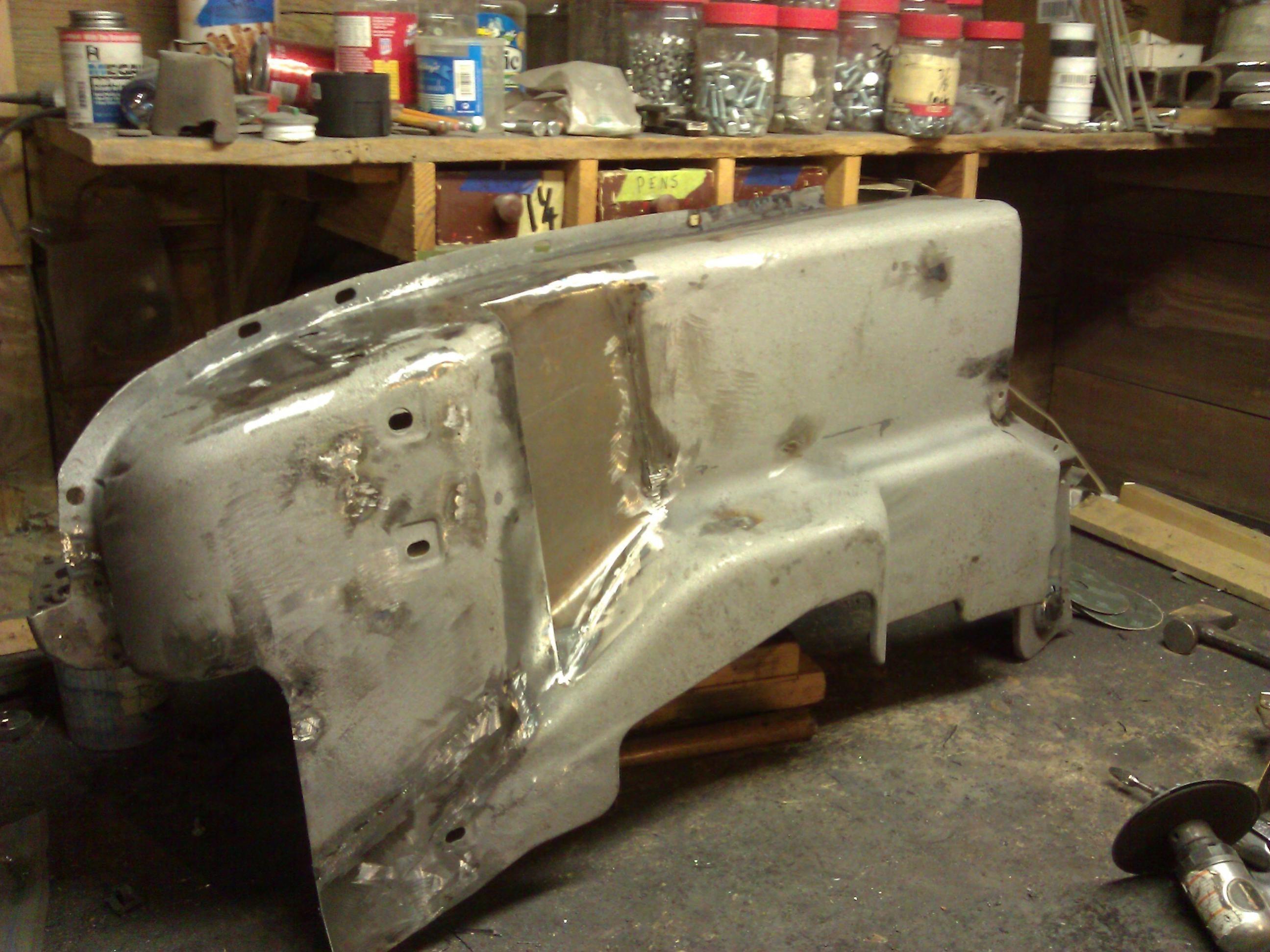

    Well I promised more pictures, so that's what I've got fer ya! haha...These shots show the next step...fixing the front inner fenderwells...There was some major swiss cheese going on here that needed to be addressed, factory bolt holes that were no longer required, the battery relocated from the driver inner fenderwell to the trunk, and the p***enger side inner fenderwell needed to be relieved to make some room for the alternator on that 390 cubic inch Cadillac :)

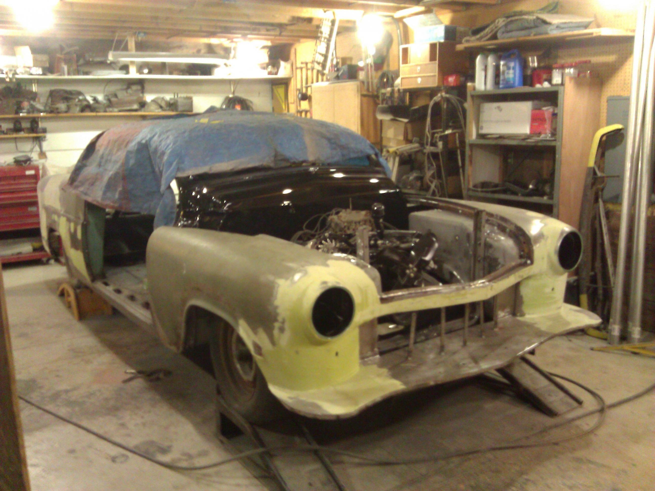

    Next I mocked the one piece front end back onto the car (it's steel, I just welded it all together) and did the filler work on the front inner fenderwells...

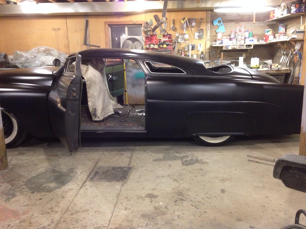

    Here's a side profile shot from 2 nights ago, and you can clearly see even with the rear window out that it's not right...I figured out that when I chopped it initially, I actually dropped the front of the rear window too much...I got it to look right for the first summer with a LOT of filler...not the right way, and I learned the hard way... ImageUploadedByH.A.M.B.1398604546.149646.jpg
