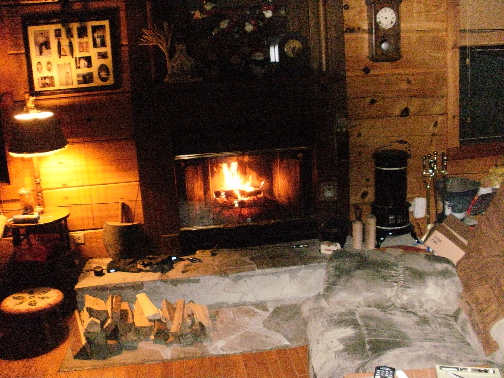

  25. Now that is a kool lookin heater. Like mine next to the fire place. 001.JPG Bruce.
