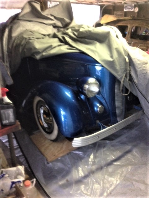

    My 36 is stored over the winter in my dad's unheated garage which is more like a dark dank dungeon than a garage. I make sure the gas tank is 3/4 full and I put in a bottle of Stabil and run it through the tank and carbs. I also pull the battery and store it in the heated house. I put a sheet of plastic on the cement floor. A friend sold me one of his old zippered car bags and I put it down on the plastic, ad another plastic sheet to catch any drips (the alpha flathead likes to mark its territory) and then I push the the car onto the plastic sheet on top of the bag. The car has bias ply tires so I put it up on jack stands so the tires don't flat spot. Before putting the jack stands on the plastic on the bag I put down pieces of carpet and a square of plywood and put the jack stands on the plywood. The carpet s****s are so the plywood won't damage the car bag. I put tin foil in the exhaust pipe ends and cover the car with a cloth car cover. The last step before zipping up the bag is to cook up some desiccant. One tray goes under the car and the other tray goes on the floorboards. I also have a 5-gallon bucket / anti-freeze mouse trap that built that sits just outside the bagged car. Ever since I started doing all of this I have not had any problems with moisture or with mice or chipmunks getting in the car. It may seem like overkill but it seems to work for me.

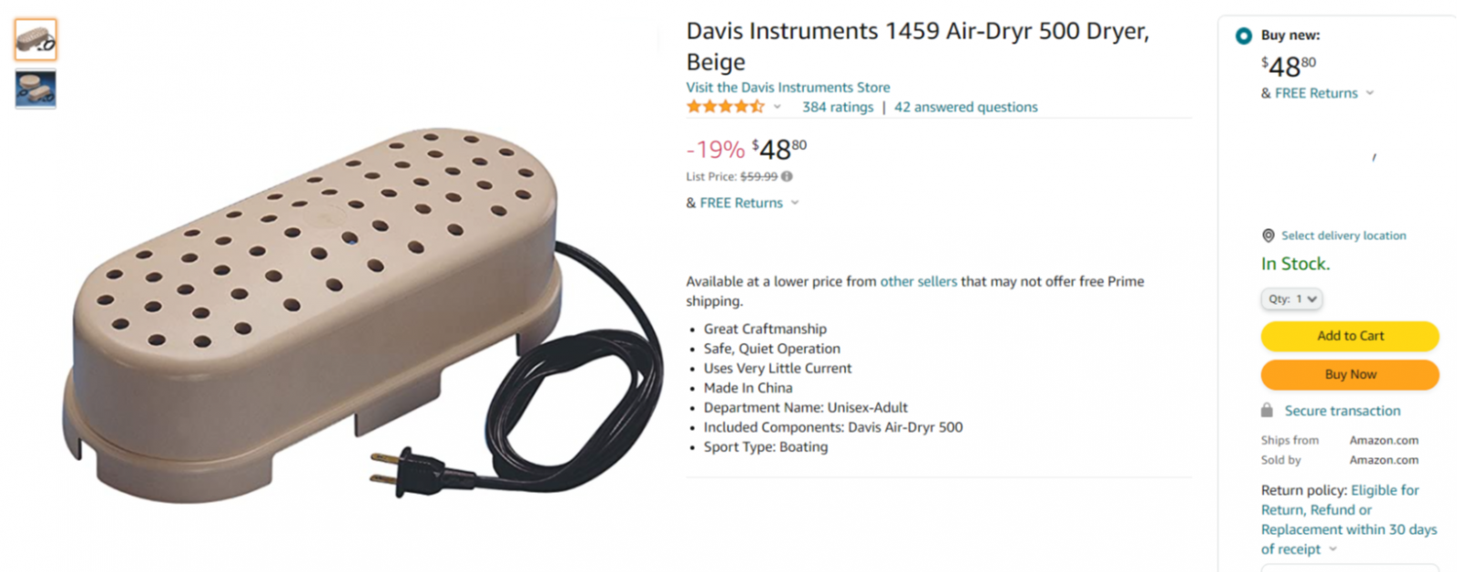

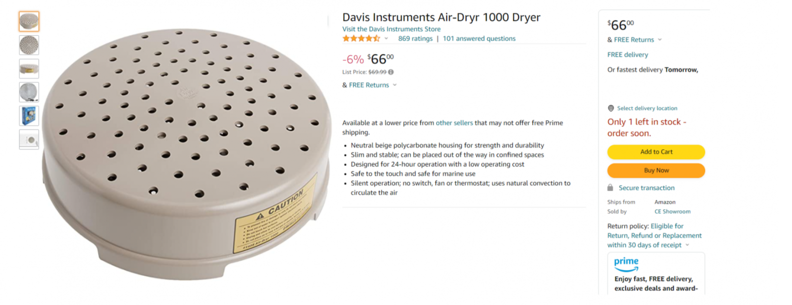

    This sounds odd coming from a lifelong So Cal person with as mild to not so mild winter situations. But, we do get cold weather out here, cold enough to hail in our back yard on the coastal areas, deep snow in the local mountains and freezing, (we think and feel like it is freezing) winters. On the water, sailing in cold weather feels like someone is biting your skin as the sailboat cuts through the big swells and even on the bay sailing, it feels frozen when we are sitting inside the cabin trying to warm up after a good day’s sail.
    So, with that in mind, the thing we have used at home and on our sailboat(s) is this product called Davis Company Air Dryer.
    We also used it in our garage area where there was some moisture and the “air dryer” kept it dry and warm. Oh oh..a warm garage is recipe for critters of all kinds. We live on the edge of a huge open field and mountain slope. So, there are plenty of critters outside and running around free. We keep them at bay with Ultrasound devices placed inside of the garage and house. That in itself is an invisible barrier to keep those critters out of our house or garage.
    When we moved in 20 years ago, we had critters on our roof, inside of the cracks in the roof tiles and in the garage. So, what made the difference after trying poison, not good if you have pets, small dogs or it gets out of the yard into the community. Traps worked once, but once was enough, since I had to clean up looking at a pair of small bulging eyes staring at me as I disposed it in a sealed bag. But after a series of listening to critters running freely, we got some Ultrasound units near our bedroom. From that point on, the sounds of little feet in the attic disappeared and no signs or deposits anywhere to be found.
    In the garage, cleaning traps after hearing the loud “SNAP” was not pleasurable, although I did catch several critters. I installed different frequency Ultrasound units and the critters just did not like the garage during the day, summer, winter or any time of the year. All attributable to the Ultrasound devices installed. In the attic, we also installed several Ultrasound devices as we have some boxes up there and it leads to the inner walls of the house.
    But, for all of the bashing the Ultrasound devices gets from people here on the HAMB, our house is critter free for 20 years and we have critters out in the fence line, where they are supposed to be running around free. Our two neighbors always ask me about catching those critters. The critters brains are wired to hate Ultrasound devices and we do not have to deal with critters in traps or poisons (no children or pets in either house) But, the neighbors are insistent on their way of taking extra time to deal with those little creatures.
    Desiccants are not necessary as they absorb and the containers fill up with water (moisture) and you need to dump it someplace. Not the most enjoyable job.
    Jnaki
    For the garage, you can safely place one of the Davis Air Dryers in place and shut the door. It heats up the whole area without a flame or hot coals, slowly. You can leave it plugged in overnight as long as the top and bottom are not clogged up with combustible materials. Air flow is a must. We had it sitting on a large piece of floor tile and it worked well. Always wipe off the top surface to keep the dust and other combustible stuff out of the holes.
    13.66 x 13.39 x 4.69 inches The small holes do not allow creatures to get inside the mechanism.
    The Davis Air Dryers can be left in the car hulk and left overnight in the garage. It will take awhile, but these (no flame or hot, exposed, heating element) dryers will just soak up the air with heat and cause dryness. Just leave it in there and go watch a movie.
    13.58 x 5.98 x 4.37 inches For smaller places and areas in the garage/closet, etc.
    It will not dry any wet upholstery or other material, but in time you would want to replace those anyway. This dryer is a heating element and will get the hidden water or moisture out.
    The Davis Air Dryers have done a great job keeping the interior of boats pretty moisture free because of the low level heating. It is not a heater, but a long range drying element. In our series of sailboats, each single wall boat got moisture almost from sitting inside, breathing. But our last sailboat was double wall construction and that gave us a drip/moisture free side wall inside.
    The Davis Air Dryers are not direct heat dryers like women's hair dryers. As far as the smell, inside of small fibergl*** hull enclosed boats, if left over time, it will create a warm fibergl*** smell. But, most people use their boats weekly, so the smell goes away fast. If left "on" inside of a closed up boat, it will make the fibergl*** smell stronger. The moisture will be gone, but that is this dryer's function.
    Note: If you want to spend your whole winter trudging out to the garage to empty dessicants, look at dead little mouse eyes staring out at you and if left too long, try to get rid of the dead animal smell is a worse problem. The Ultrasound units are available everywhere and they all work well, it becomes a style function. Color, size and amount of low level light is a choice you have to make. "There is no.. one best."
    (We do not have any Ultrasound units in the outdoor plugs outside, as the critters are supposed to live out there and not inside of the garage or house. The Ultrasound units inside of the garage and house do not affect our little dog.)
    But, our free and easy way of living seems good for us and if you want to make life more complicated, go for the dessicants, mouse traps, poisons and other forms of critter removal including “smelly cats” and their residue. YRMV

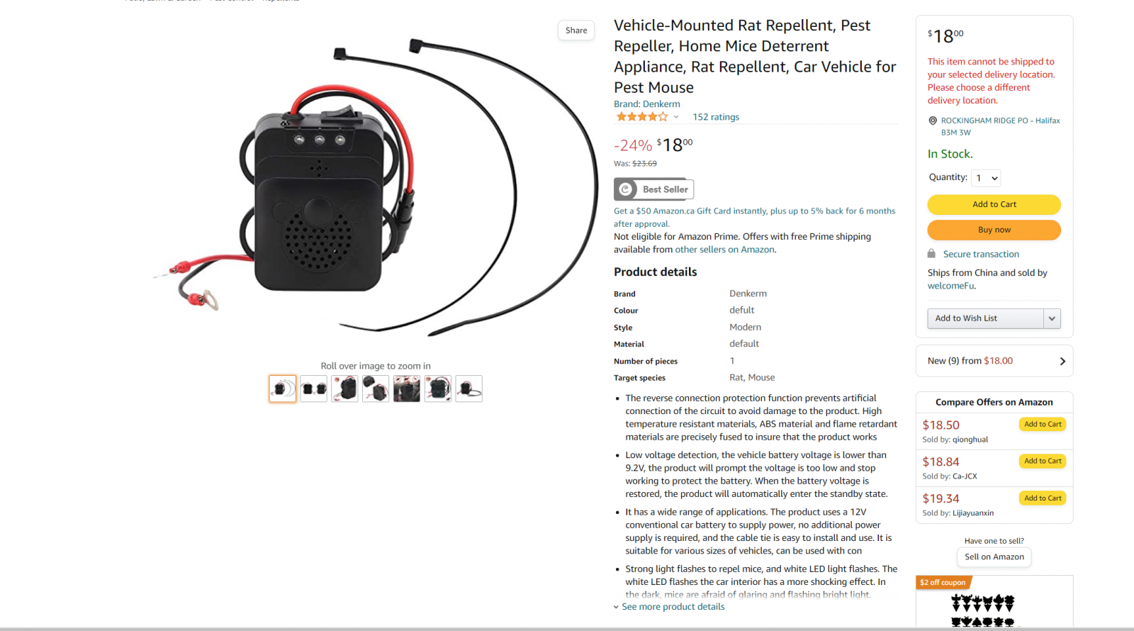

    JNAKI - is there a specific ultrasound pest repellant you can recommend?
    Thanks kindly....
  21. I'd like to know too. Does anyone know if these ultrasound repellents actually work?
