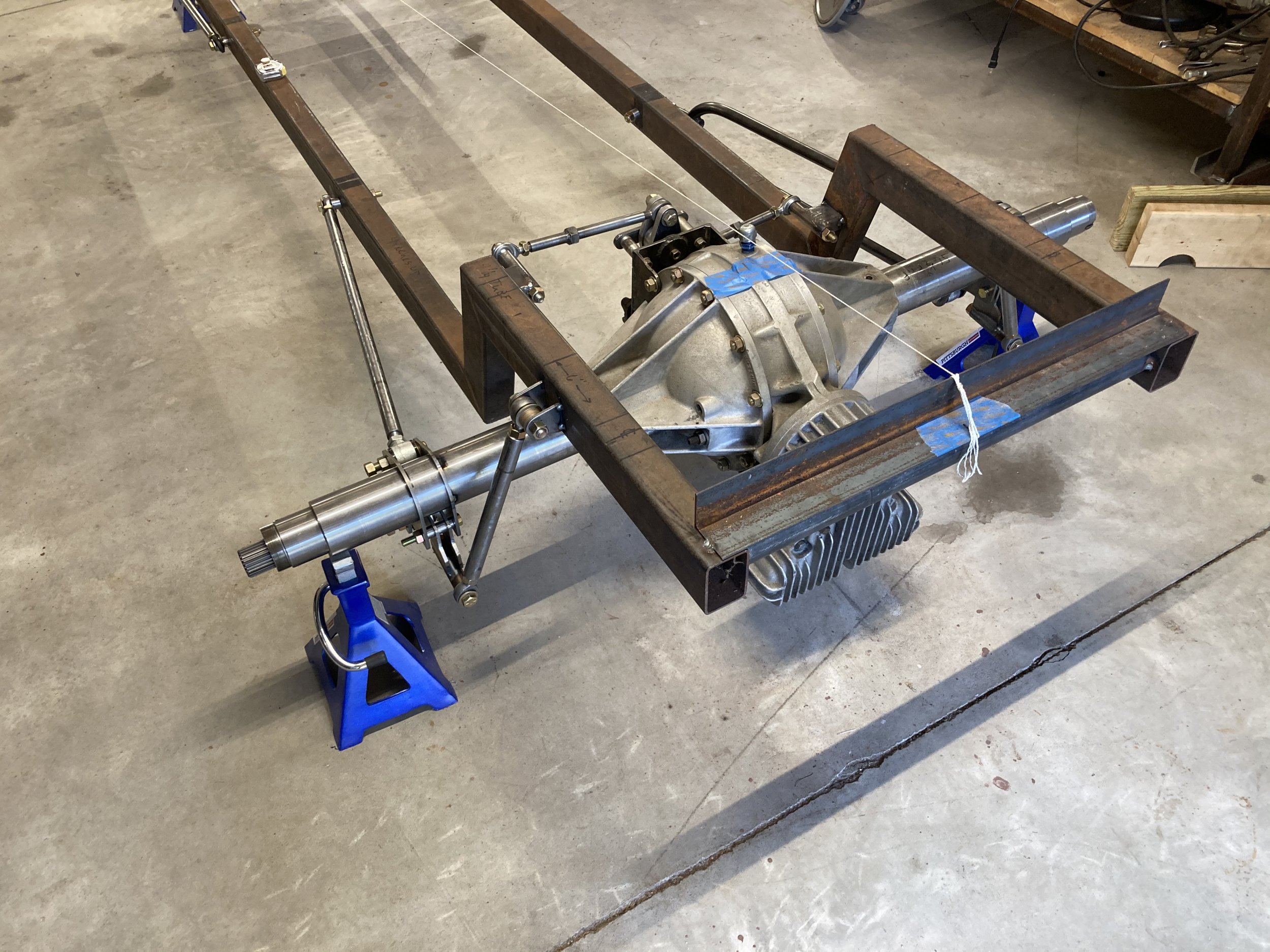

    Just found this local, $750. Definitely doesn’t look like a normal quick change to me. Any info would help tons. Looking for a rear for the 28 roadster

    Same bells as my Winters Champ. Different cover.

    The cover is a Winters K5160 Super Cover.

    It looks like the cover is designed with reservoirs to retain gear lube during changes?

    Not sure......the bottom lip of the cover flange is down at the bottom of the jugs, so looks like you'd still lose a good amount of lube during changes??....but definitely reservoirs for extra capacity.

    Just some extra capacity to help keep the oil cool under hard conditions. If it's in good shape that's a good deal (as long as it has a diff, not a spool).

    If it has 5x5 bolt pattern it’s an older late model stock car rear axle, like this one was. This one has a locker, some say not ideal for the street, however it’s still a differential, not a spool. And yes it’s a good buy at that price if not damaged inside. Easy enough to check out. Ask the seller if he has a wheel for it, and bolt it on the right side. Stand it up on that end, and pull the thru-bolts out and take a look inside, if the seller will allow it.

    Just went back and looked at the picture more closely and it already has a wheel on the right side, and is standing up on it. Those bolts are 7/16 and easily removed.

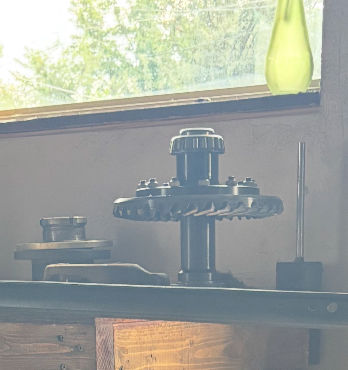

    Spool or locker? You got a good one there…

    I think…. Noob I’m not sure. But here’s a photo. If I keep this one it’s going to be a lot more work then it would be worth for me. I’ll never use it to its full potential. I only traded a couple hundred dollars worth of model a fenders.

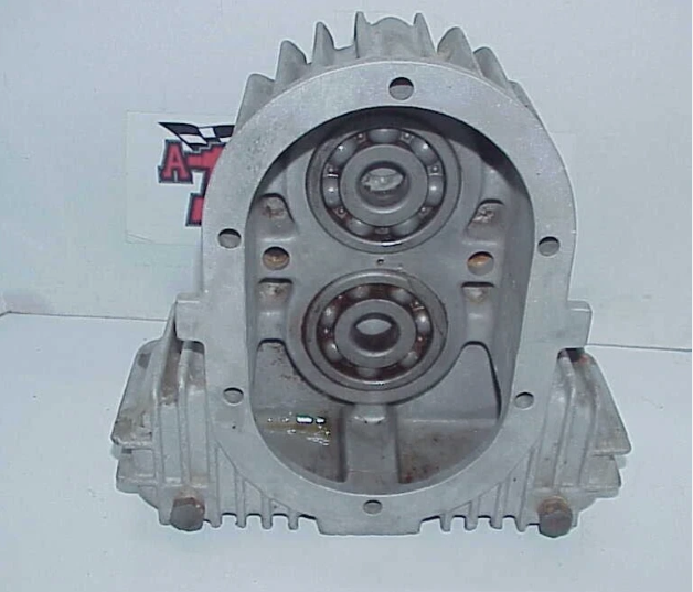

    I did find another quick change. An older guy has it and knows absolutely nothing about it. I can’t tell if it’s a Hali 301 or what. The lower 3 photos are of the new find. Any clue?

    Xtremeliner winters……. Hmmm
  16. To hold more gear lube for which also aided in cooling for long distance races and on Speedways One mile and bigger tracks- Like Trenton NJ, Nazareth PA, Langhorne PA, Syracuse NY etc...
    Some Super Covers also had a provision for a rear end cooler pump.
    For some reason many people overlook or seem to forget these are racecar parts!

    Both rears are essentially the same thing, just one has full floating huds and the other has Ford 9 inch style axles, would be my guess from the pictures. Your first one has a super cover, the second one has the normal cover. Good score on both ***uming the cost was reasonable
