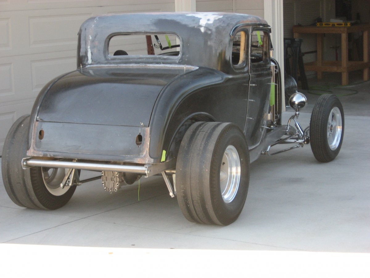

  6. I have been using the Winters V8 with no problems in over 35,000 miles so far. Body & Frame # 3 002.jpg

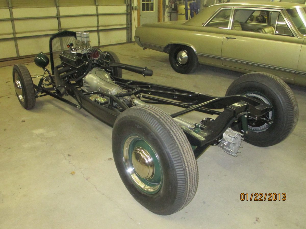

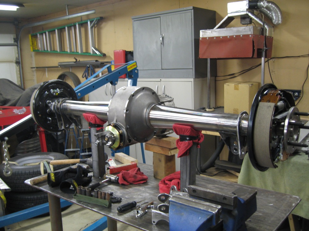

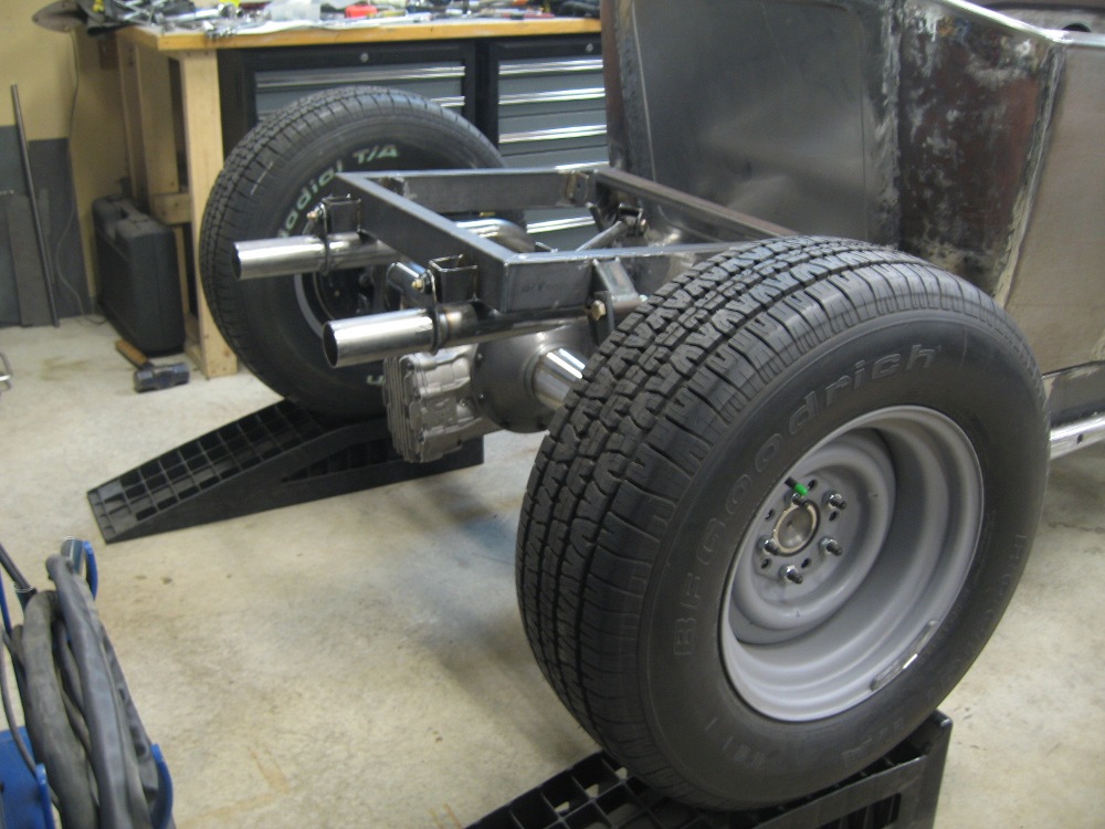

    I have a Winters champ style under my 34. Local roundy round race shop sole me a good used posi carrier...don't remember the brand. Mine uses a 4.86 R&P with axle tubes from another stock car race shop, "cut to fit" 31 spline axle shafts and brakes from a 68 Merc monterey sedan. 34QCcleanedup7_15.jpg 34QCcarrier2.jpg 34rear12_15.jpg

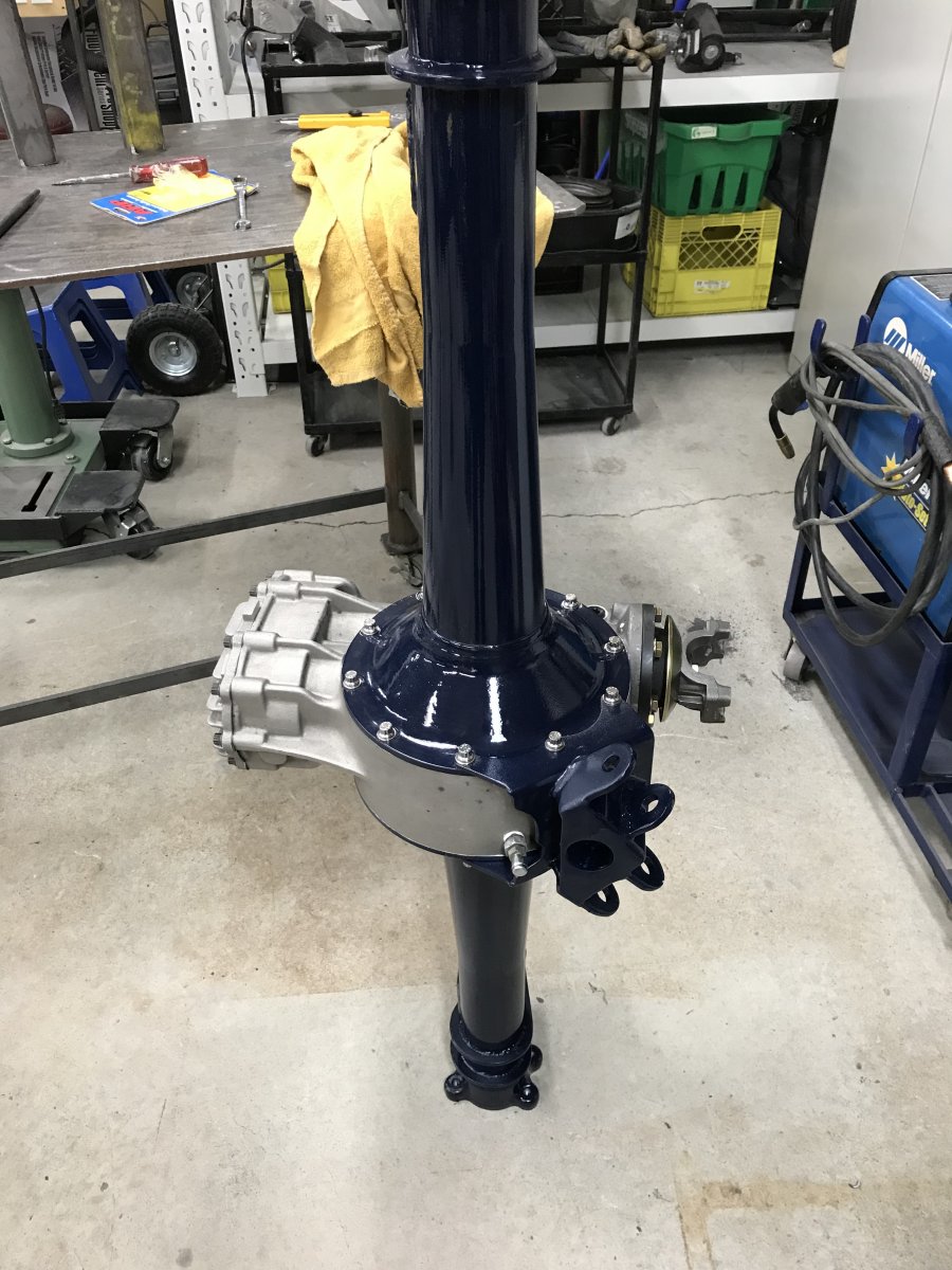

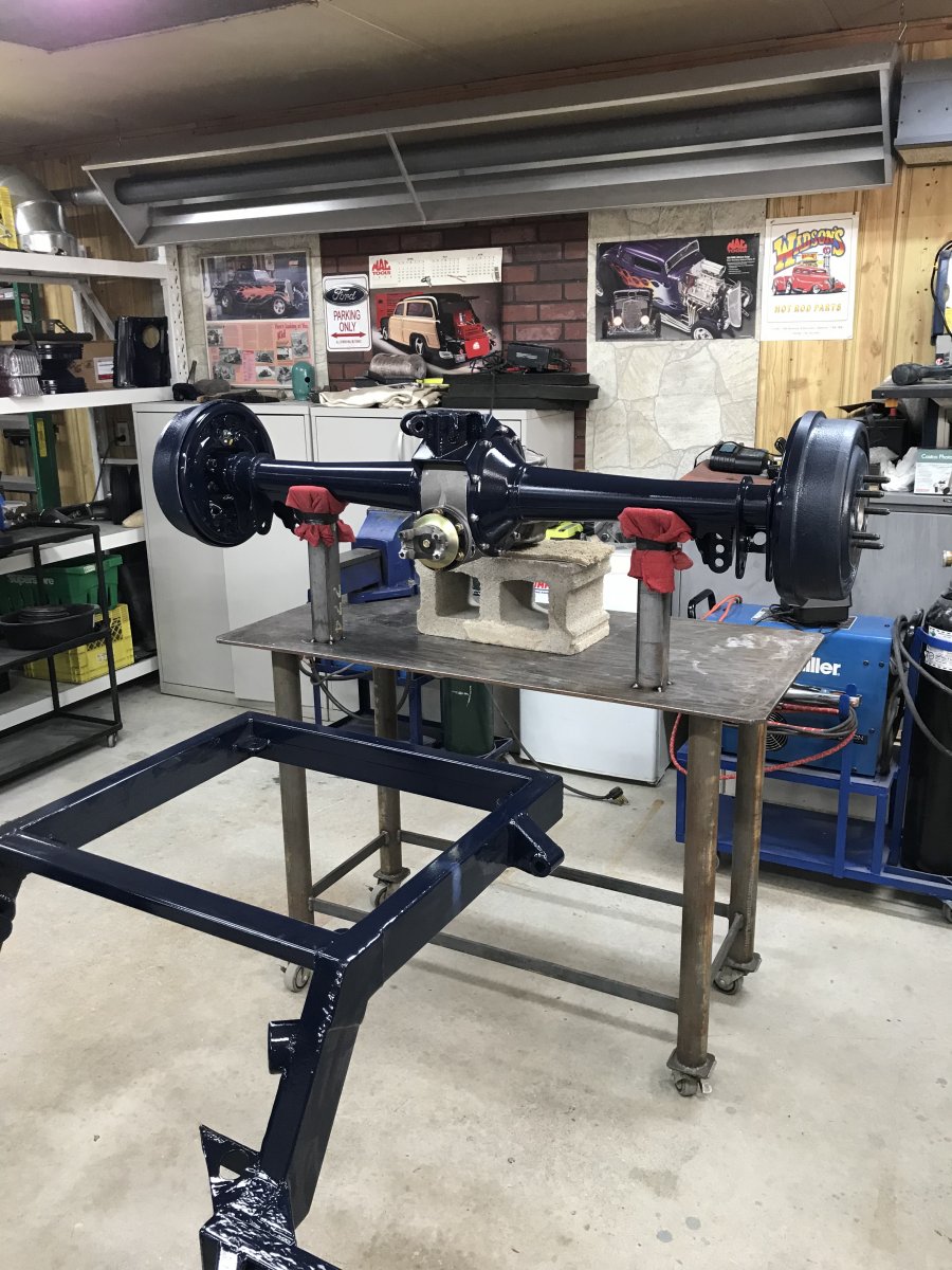

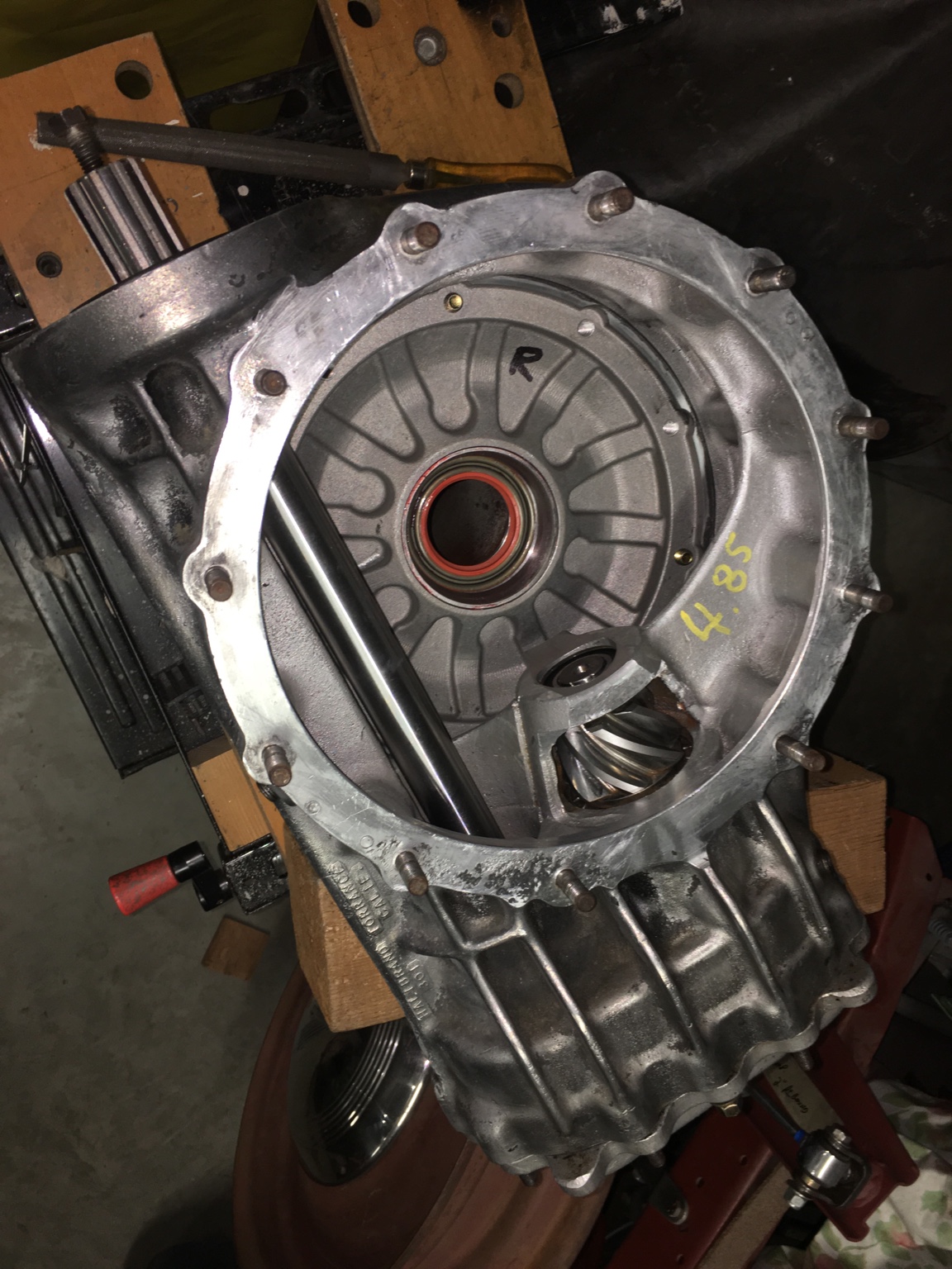

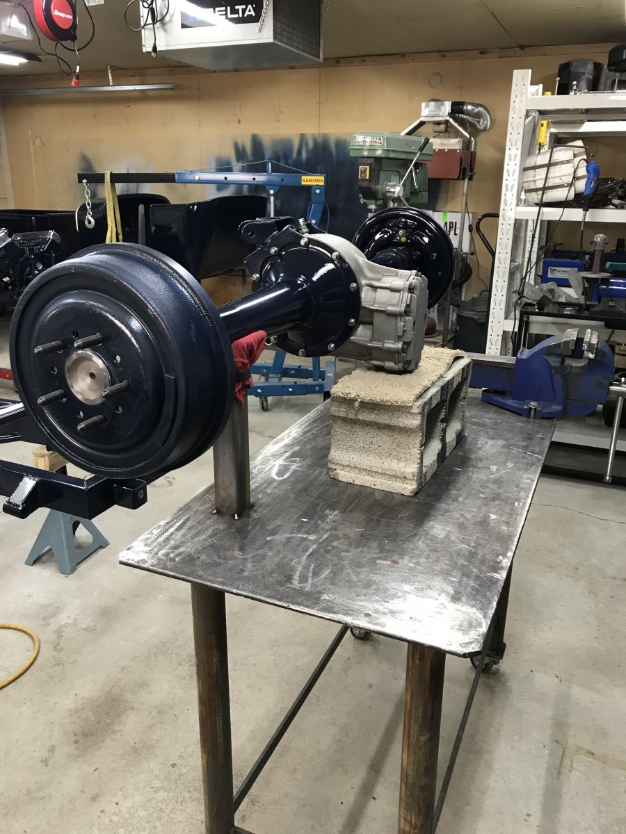

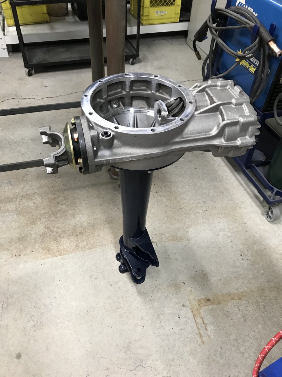

    IMG_2561.JPG IMG_2431.JPG Decide it was the only way to go, plus Summit had a great deal on the nostalgia V8 quick change, plus the width was just what I needed.
    ls1yj likes this.
