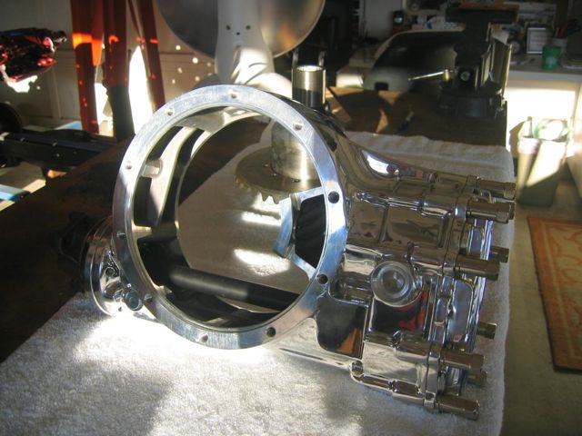

  11. Pewsplace
    Joined: Feb 10, 2007
    Posts: 2,795
    Pewsplace
    It has been a while but I used 2 qts which filled above the lower shaft.
