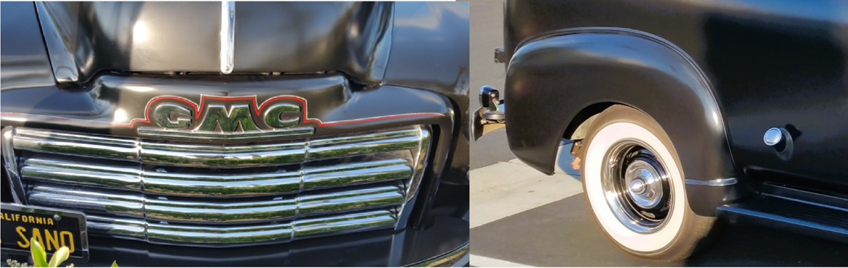

    A little bit of polish on a dull surface, even black primer, will give it a semi matte finish, similar to the popular “frozen ice” paints that cost $$$$$.
    Note 2:
    Black primer with a nice polish application…
