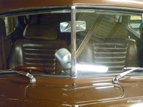

    I used one of these on my '36 Willys. It is in the headliner. I think they were originally for Jeeps. available on ebaY as are rotary switches. One-wire hookup, can't get simpler! I keep the wiper arm and blade under my seat, only put it on in rain.
    Wiper switch on left.
    Wiper installed.
    Removed.
