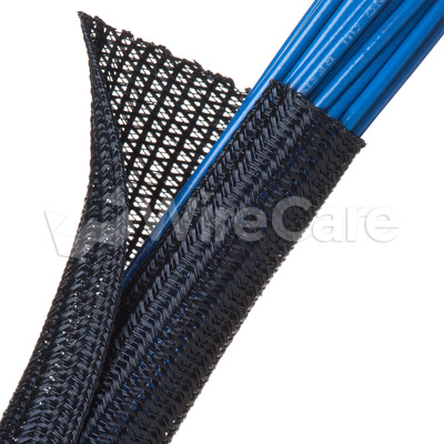

  11. blowby
    Joined: Dec 27, 2012
    Posts: 8,663
    blowby
    from Nicasio Ca
    Yeah the asphalt looks great, too bad it's not slit and self wrapping like the modern disgusting corrugated plastic crap. Speaking of which, while not correct, this would at least be a step above that stuff.
