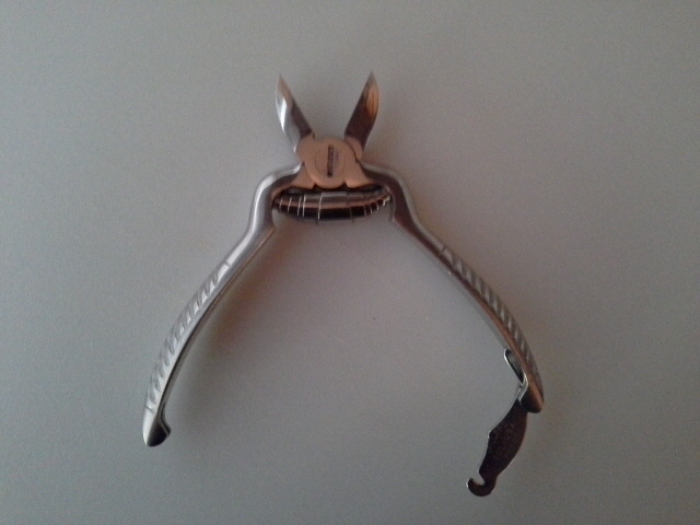

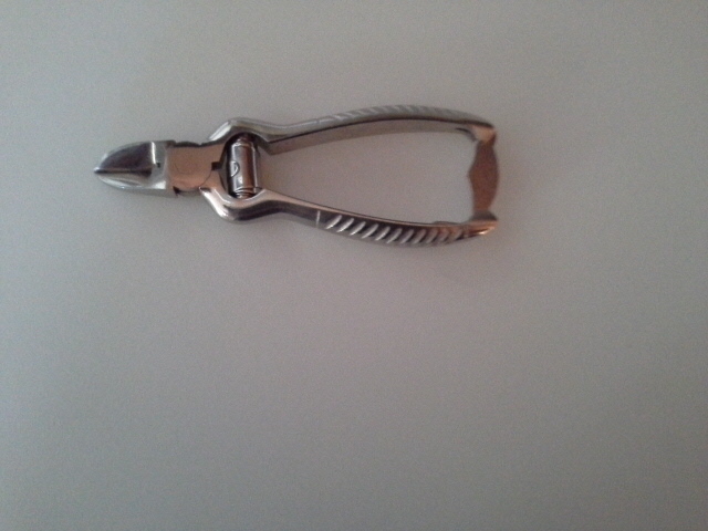

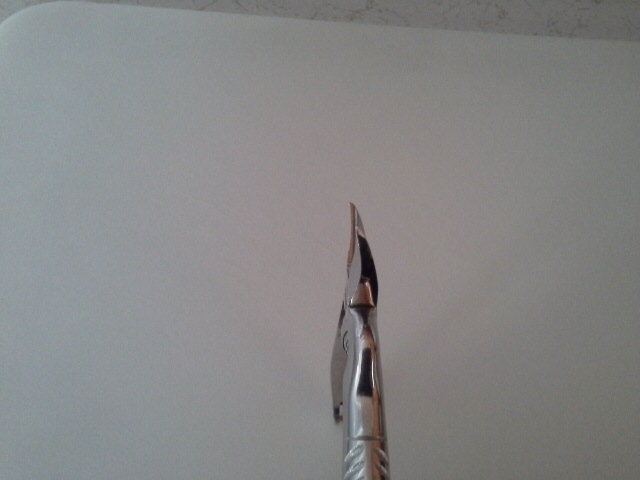

  19. DDDenny
    Posts: 23,422
    Don't tell the wife but I use her toenail clipper.
    Cuts closer and works better than any sidecutters you can find.
