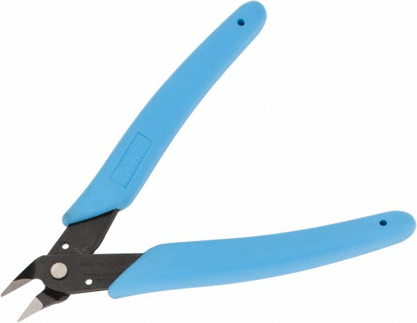

    This style of flush cutter is available from Walmart in the crafts department for about $3. I only use them for cutting ties and they work great and last a long time. My old skin is thin and I bleed easily. These cutters do not leave the sharp edge that hurts me.
    John
    hrm2k likes this.
  13. hrm2k
    Joined: Oct 2, 2007
    Posts: 5,510
    hrm2k
    the back side of the clipper is completely flat so it does a great job

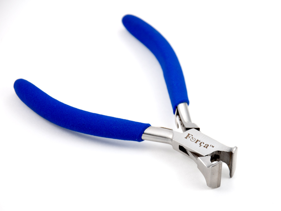

  14. I use a big pair of nail clippers. I got some from a medical supply display at a swap meet that had concave blades instead of the usual convex shape, but they all work to get rid of the sharp tabs.
