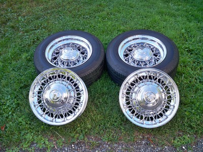

    I've purchased a set of aftermarket wire wheels. The fella I got them from says they came on a car that was built around 20 years ago and thought the were Coker. The front are 5x15 and the rear are 8x15. They are factory chrome and in very good condition.
    After buying them and putting 2 and 2 together along with what he told me, he basically got sick of losing air with a tubeless radial set up. I'd say, judging by the way he claimed his car was unstable over 60 mph, he didn't dare try bias ply tires with tubes. He replaces them with one piece aluminum wheels and radials.
    I didn't realize it at the time but putting tubes in a radials doesn't work all that well. The extra flexing together with the ribbing inside a radial causes to much heat and friction resulting in tube shifting and failure. He managed to seal the rears as all of the spoke come through the relief part of the wheel. But on the front, half of the spokes come through on the bead portion of the wheel. Between the outer rim edge and the ridge about one inch from the outer rim. He tried unsuccessfully to seal them with some sort of bitchathane type wrap but ended up using tubes on the front.
    So my question is, can these wheels be sealed with a urethane or silicone around the spoke holes or should I plan on bias ply tires with tubes. Or maybe there's a radial tire out there that is designed to work with a tube... Or maybe abandon them and go with steelies... My plan is to paint them black and put them on my 1920 Hudson pictured in my profile pic. It's actually my sons car. I just do all of the figuring...
    Thanks for your time, big"D"®,

    Have run tubes in many brands of radials for over 40 years. Buy radial tubes, no problem. Also, radial tubes work in either type tire.

  3. If you want to run radials, tubes work just fine, you use a radial tube with a radial easy peezy.
    My bike has radials and tubes and I don't have a problem and the early radials (before steel belts) ran tubes as well. I have run steel belted radials with tube for many miles as well. The trick to running radials tubes or otherwise is to run them hard most people don't watch their air pressure and have problem prematurely. With tubes it is real important that you watch your air pressure.
    or you can run bias ply tires, you just drive a bias ply different then you do a radial.
  4. Just make sure you use innertube rubbers to protect the tube and a copious amount of talc powder to prevent chafing.

    Big 'D': Pretty sure those wheels are McLeans. Front are 'lip laced', (spokes on outer lip of wheels, a McLean trademark around mid-'70s. Gary and his son sold the biz (and the name) continuing business as 'Rally Sport', until a fire closed their doors. Gary's son has been on here as 'Wheelkid'.
    Speaking of radial tube woes, I have a set of Romeo Palemides 2 piece aluminum wheels on my F100. These were made just prior to the Torq-Thrust, which Romeo sold with his wheel biz to American Racing.
    I found a set of Uniroyal Tiger Paws for them, 205/60 X 15 front, 235/70 X 15 rear. As they are 2 piece wheels, it's necessary to run tubes: Coker radials.
    Problem: The inside of the tires have radially-molded 'ribs', running from side to side...1/4" apart, these ribs are 1/16" cross section, and kind of 'sharp'.
    When installing the tires/tubes, the wheel halves are separate, allowing the tubes to be partially inflated. This should ensure the tube to expand smoothly, after torqueing the wheels together.
    But that's not always the case. Two pinched tubes, one suddenly losing its air on 99 coming back from Billetproof...Lucky for me, the truck is stable...Able to stop, not a scratch on the wheel; the second one was on the left rear. (I thought someone let the air out, but careful enough to suspect the worst, opened it up. Damn! Another big pinch!)

    What you are referring to is called a flap. It's like a very big and wide rubber band.
    It should fit into the drop center of the wheel and cover the nipples and spoke ends.
    Failing being able to obtain these, wrapping that area with several layers of duct tape or wide electrical tape will suffice.
    Radial tubes are a must when running a tube in any radial tire.

    They are stamped 4 10 91 2302 JJTB then under that it says Made in USA 15x5... I assume that is the date followed by the model number 2302 but I'm not sure. I would really like to know what the JJTB stands for. I obviously punched all this into google but didn't get much info back. I did find that the bead laced style is more common with front wheel drives when a greater back-set is needed.

  14. Tube-style radials used to be fairly common as European sports cars used them starting in the late '50 to the early '70s, although probably not in the sizes you'd need and they were all imported (Dunlop, Pirelli and Michelin mostly). They've pretty much disappeared since the wire wheels did the same as OEM because of the mentioned weight/horsepower limitations. Exceed those limits and out-of-round wheels will result. You can still get the tubes however.
    You can run tubeless tires with tubes, with one caveat; you need to downgrade the tire speed rating by at least one notch. Tubeless tires have an inner liner that functions as the tube which tube tires lack, adding the tube increases the sidewall thickness and causes them to retain more heat.
