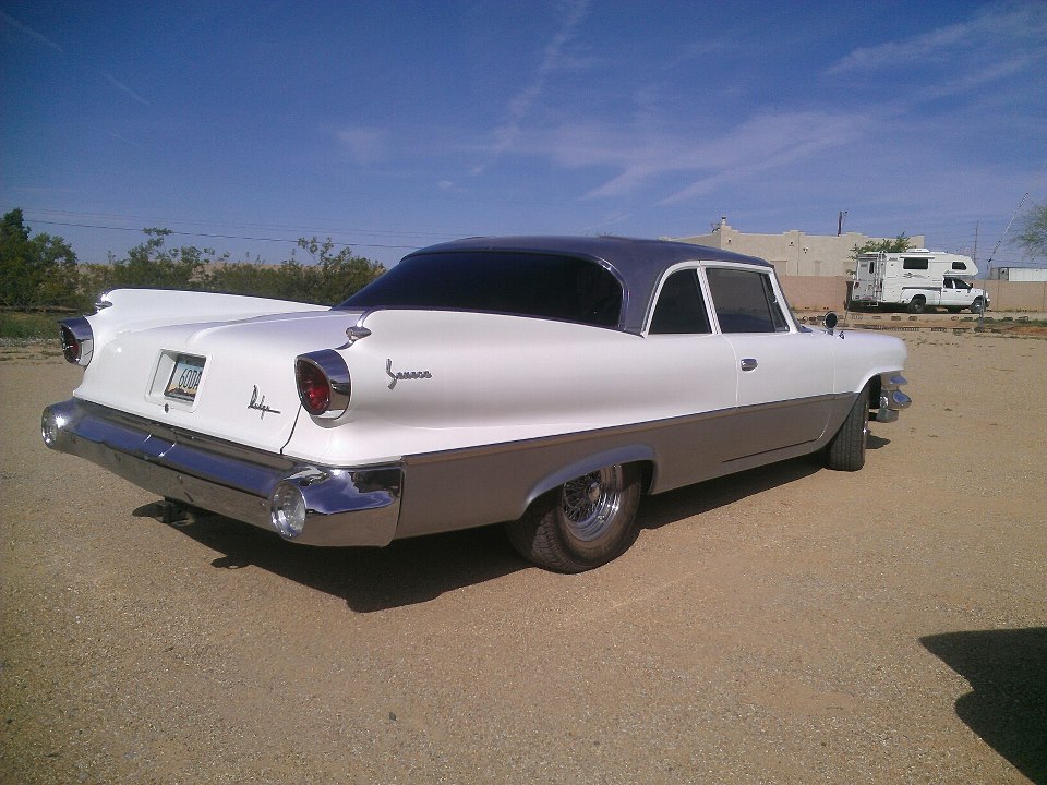

    I have a '60 Dodge Dart Seneca that had wire wheels when I purchased it. I love the look on this car, but I'm upgrading the motor to a 400+ HP poly and am worried about the wire wheels handling the power.
    Should I be concerned???
    If the wire wheels have to go, I'm at a loss as to what to put on the car that would look good, and still be relatively correct...
