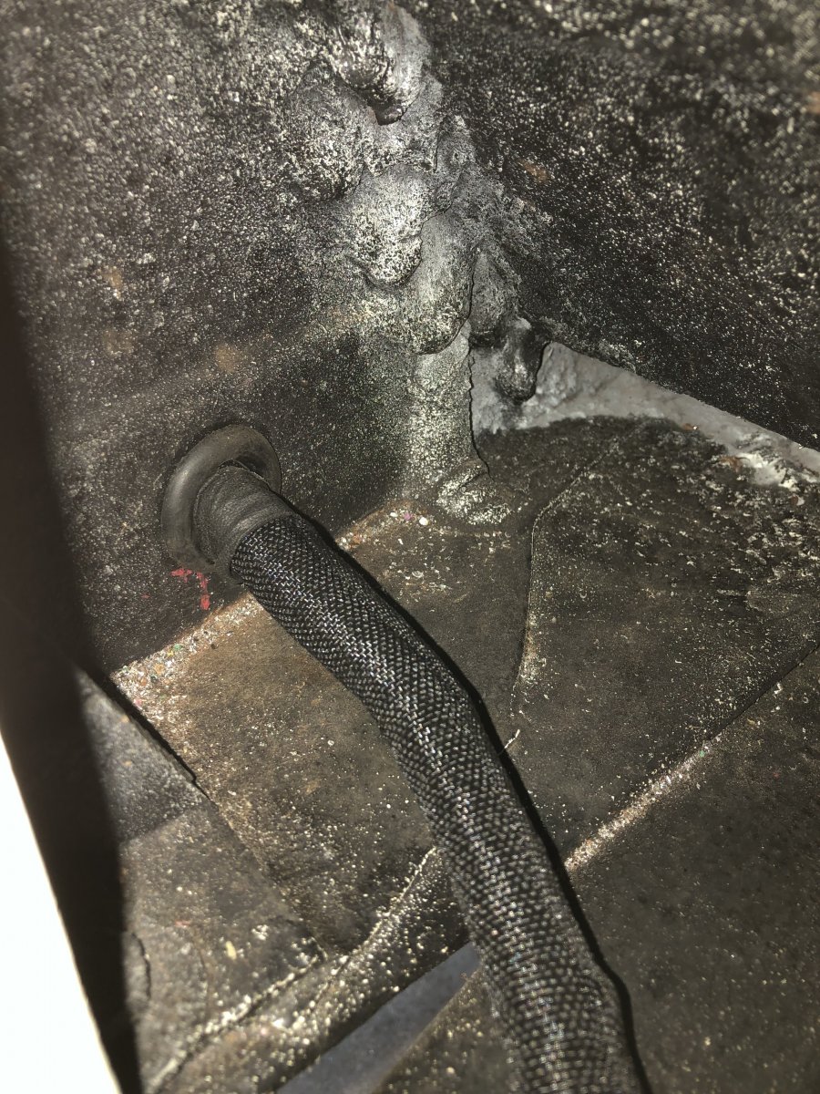

    I went way overboard on filling and smoothing the firewall on my '37 Chevy. I didn't want to put the wire through it. So, I bored a hole in the inner kick panel and routed the wires through there. They just disappear behind the front body mount. I used a grommet like the others have said, but I'm going to go with the next size bigger on final ***embly.
    I will post some pictures in the next couple of days.

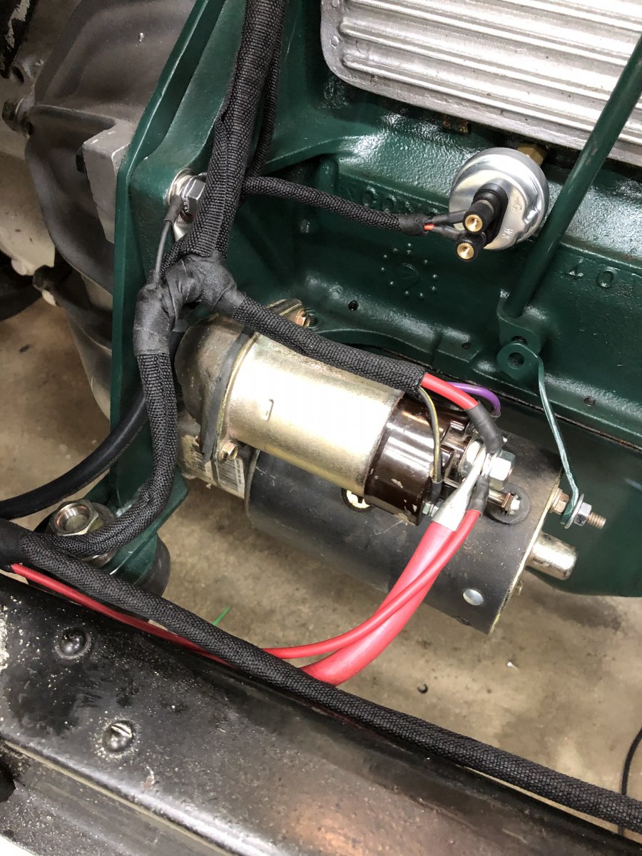

    Here is my '37. The loom is from Summit and the joints are friction taped in the best Hot Rod tradition.
    The harness comes through the inner kick panel and is hidden by the body mount.
    I see in the photos that I need to turn the loom so that the seams are to the back and do a better job on the taping.
    Boneyard51 and RDR like this.

    You also need a longer bolt on that motor mount!
    Edit: and a bolt in that starter brace!
    BONES
    HemiDeuce likes this.

    Thanx Bones,
    The motor mount bolt is hanging down underneath and the starter brace is awaiting a spacer ;)
