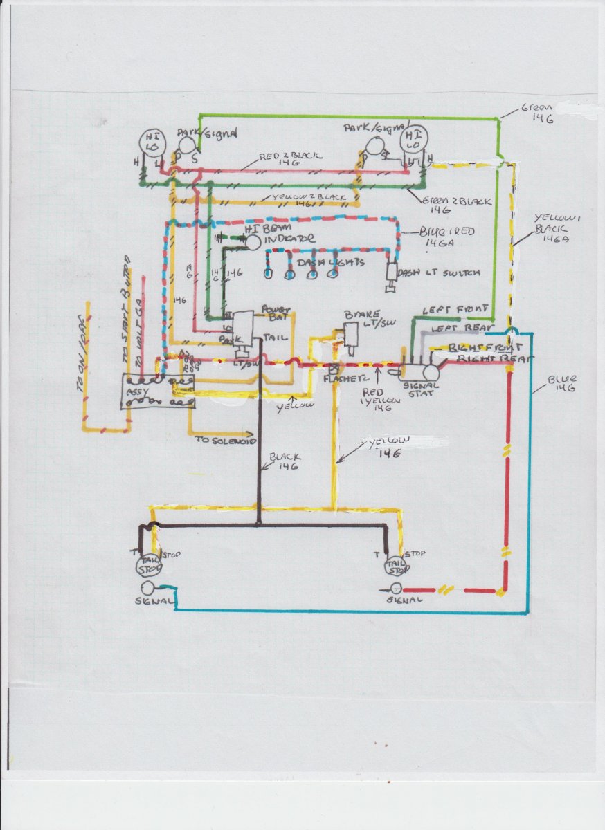

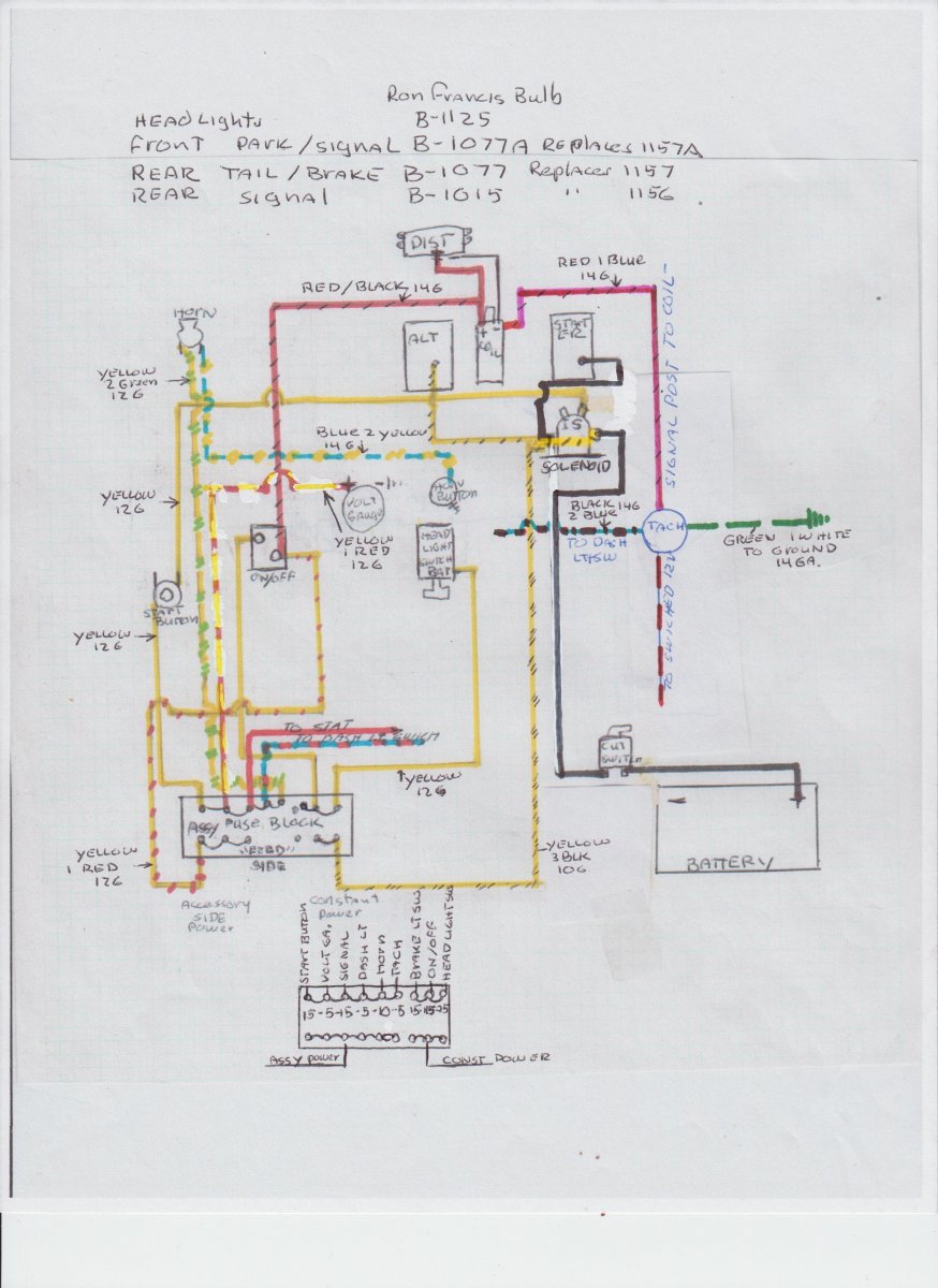

    I don't get what they are saying. The fuse panel is switched.

    It is switched! Don't think you are seeing it. Maybe my schematic is confusing?

    Your diagram shows the alternator and the power to the fuse panel connecting to the switched side of the solenoid. It can't work that way, there is no way to get power to the On/Off switch or to the key switch.
    Look at it again. Follow the path from the battery to the solenoid. What happens next? Nothing. Your alternator and your "Constant power" supply need to connect to the same side of the solenoid as the battery.

    It's not rocket science Bob, just follow the lines, and remember the basics.

    Oops:oops: It does look like it is going to the wrong side in the diagram. It is however on the other (battery)side. I will need to make that clear. This is what happens when you just got home from a Christmas party:rolleyes:
    Thanks for the catch.

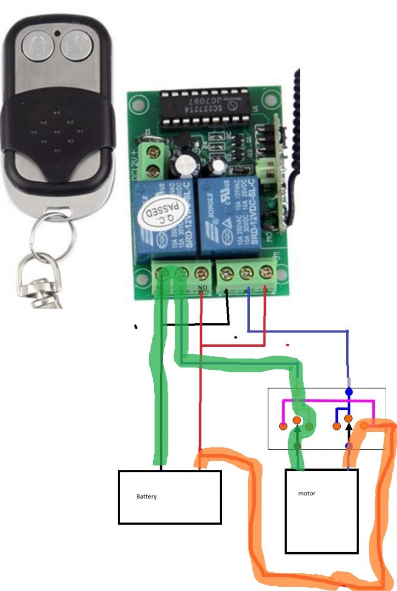

    Get a 5 pin GM power window switch and wire it in like this.

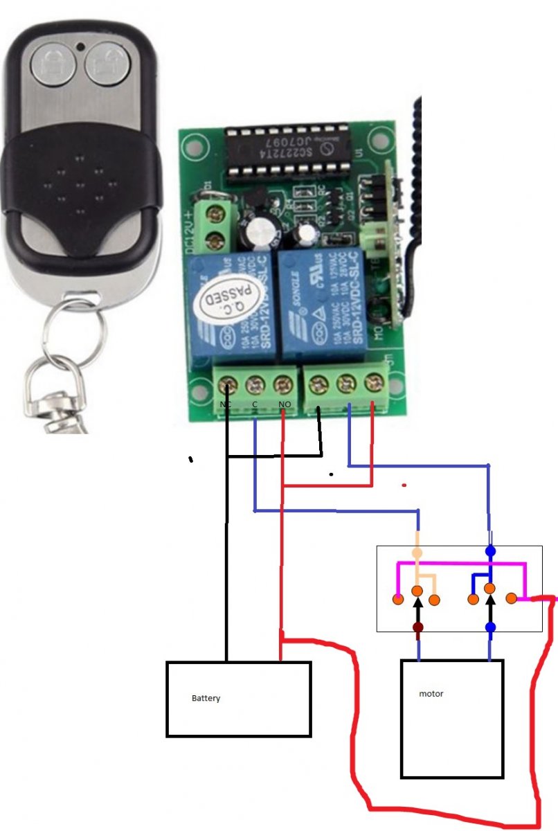

    Better? I'm going to hit the couch now!;)

    The diagram I showed is the way a p***enger power window is controlled by both the p***enger side switch and the driver side switch. I don't see how you could do it with diodes, because we are reversing polarity, current needs to flow both ways.

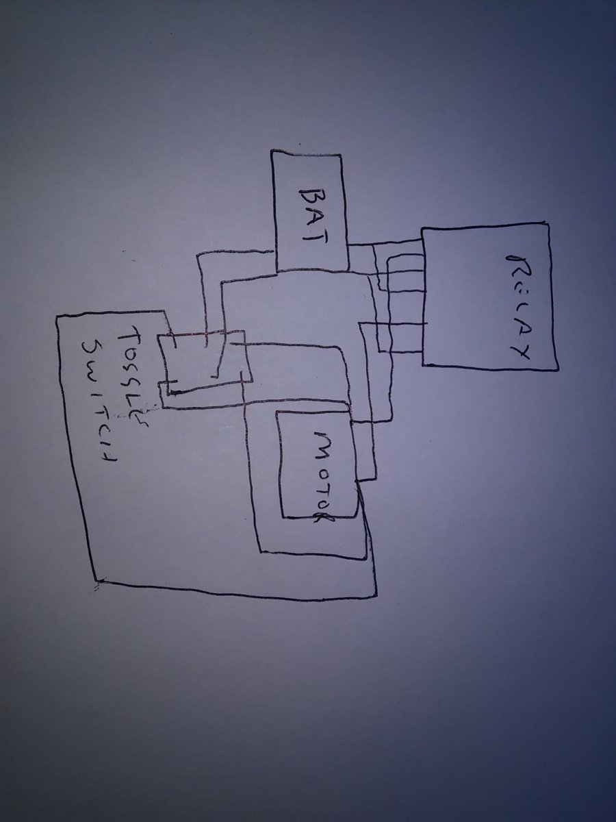

    Thanks Pinball. Well I got it working back in September. I put in two toggle switches. One toggles the power between the remote control board and the second toggle switch. The second switch operates the motor when the first switch is in the position that powers it.
    Basically I think what you diagrammed.

    I used an UP relay and a DOWN relay . Have the up wire from window switch and up wire from remote box on one relay.
    Down wire from window switch and down wire from remote box on the down relay. That way the two circuits are separated.

    Crude I know, but here is the current flow with the switch activated and the relay module not activated

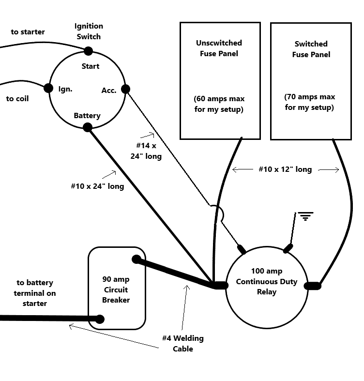

    In the meantime, is this schematic I drew up accurate regarding Steve's large relay system and the additional posts about protecting the #4 relay feed with a circuit breaker (rather than a fusible link)? Again, I'd be using a 100 amp alternator, and my system at 125% of total continuous loads would be drawing 85 amps. I like the circuit breaker idea because of the reset ability if I'm stuck out in the middle of nowhere and also because I could trip the breaker when parked as a theft deterrent.

    Yes that circuit will work as long as your acc terminal on your ignition switch is energized on the run and acc position. Most are.
    The only possible problem I see is your unswitched and switched loads combined are more than your circuit breaker, but the chance of having max load on both at the same time is kinda remote.
