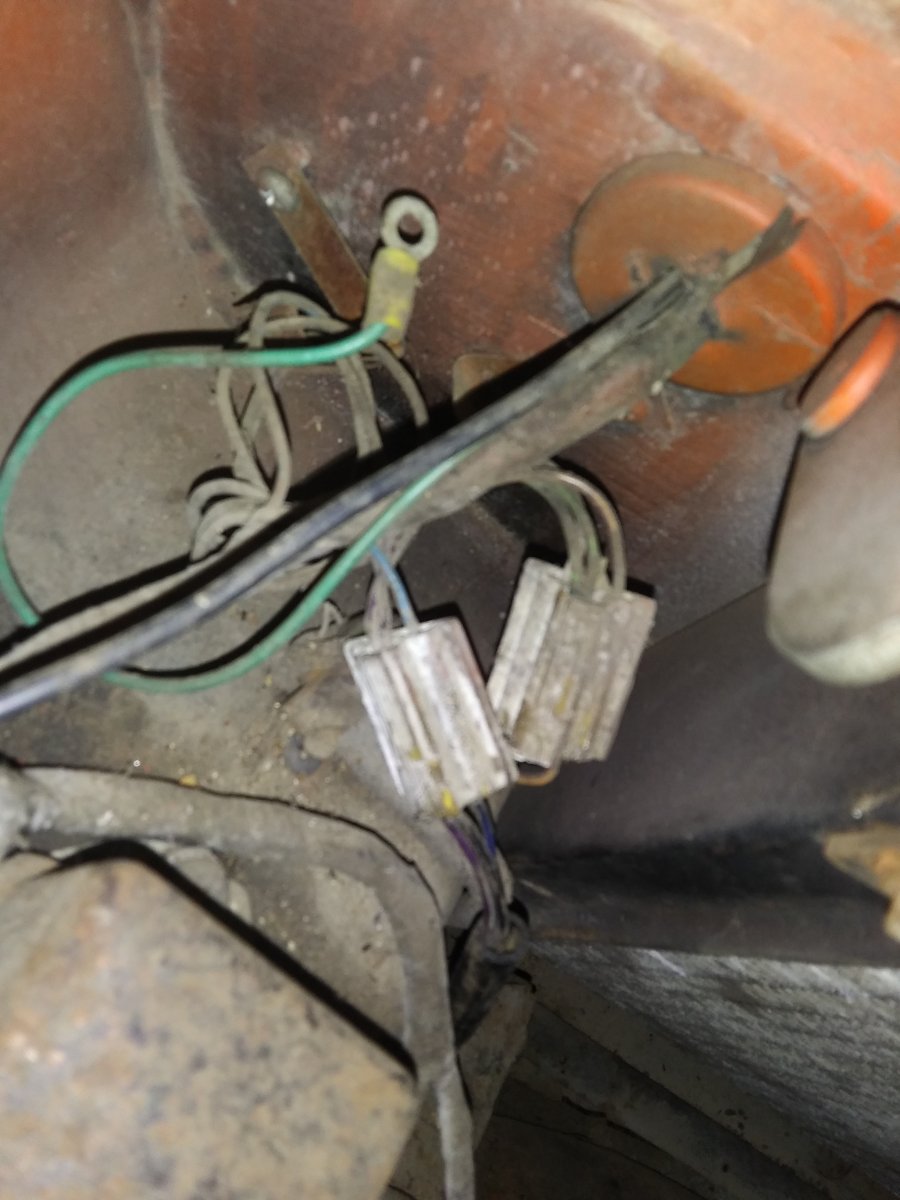

    Thanks ****. Now for something a little tougher. Are these connectors made to come apart? Only one piece of plastic as far as I can tell. Do the individual wires just pull out? '56 Chev.
