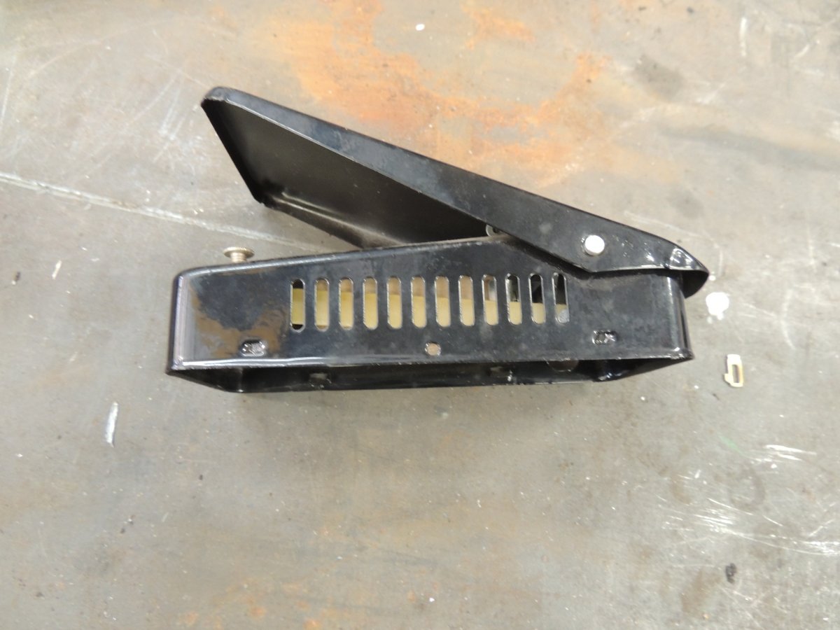

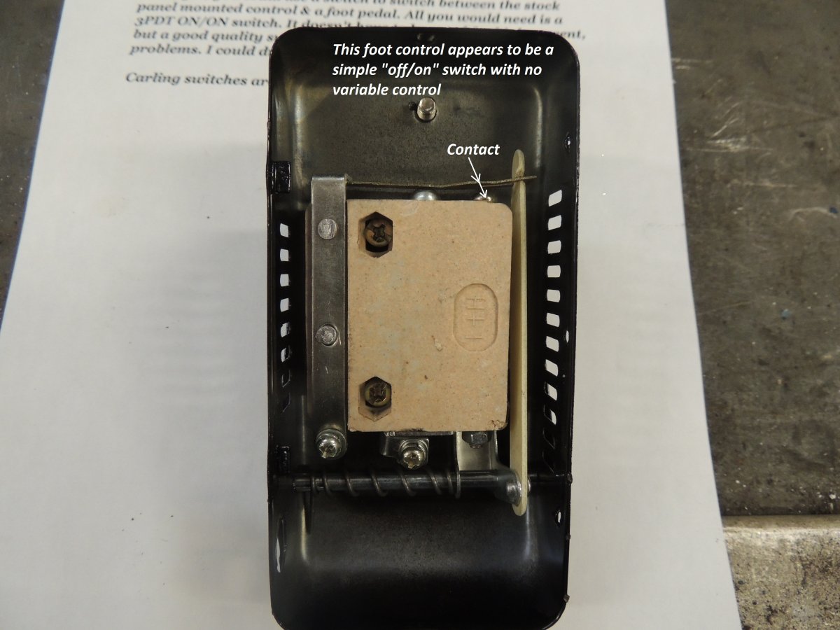

    I am way late to the party, but I was thinking that foot switch was a simple on off switch, as I have a couple like it and that is what they are. But.... I think there are some “ variables “ out there. Just not as common as the on/off ones. Might want to look around sewing machines, maybe.

    That is what I ended up going with. The foot controls I had in my stash are just simple Off/On switches. So I am using one of them ahead of the control box which has the variable speed knob. That should work just fine. If I need to go slower, I just stop......then adjust the knob slightly and step on the pedal again.
    I know my welder has a variable pedal, but not sure just how it works in conjunction with the torch output. Have a sewing machine too, so might look just to see how it works......but at this point I'm pretty well comitted to the Off/On pedal.

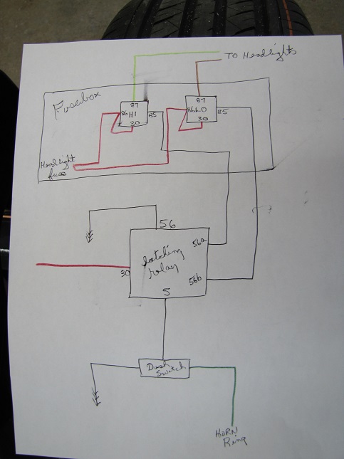

    On my coupe, I couldn't find a place for the dimmer switch. I think someone mentioned using the horn ****on as a dimmer .
    Excellent idea. Using a latching relay for the dimmer. could I switch the horn ****on from blowing the horn to dimming the headlights with a switch on the ground.
    I am having trouble figuring out how to wire this circuit. Any help would be appreciated.
    Reyn
  10. reyn
    Joined: Aug 31, 2006
    Posts: 152
    reyn
    I have two headlight relays in the fuse box. One for high the other for low beam. The more I think about this, I think the Latching relay will have to have all grounds to it. I will try to add a diagram.

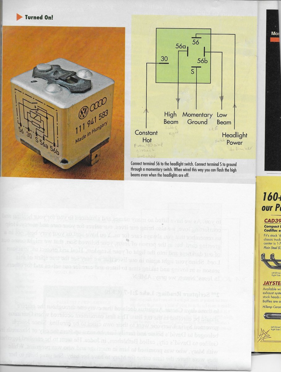

    @reyn , this might help. Post questions here.
    This is a VW locking relay for high/low beam. Using mementary switch, like your Horn ****on, each time it is grounded it switches from low/high or high/low.
    Just follow my hand written notes on the wiring diagram.
    Where diagram shows low, connect to low beam relay. High output on diagram controls your high beam relay.
    Hope this helps.

    Can anyone tell me if this will work.

    Your latching relay diagram is not the same as my diagram.
    The 'S' post is the momentary ground.
    56 is power from headlight switch.
    111 941 583 is part number for VW locking relay.
  14. reyn
    Posts: 152
    reyn
    It is the same switch. I am using 56, 56a and 56b with grounds. The headlight fuse powers the headlights through the relays so I have to run the grounds through the latching relay to control the headlights. Kind of a backwards situation which should work.

    Remember, the headlight switch powers the locking dimmer switch. The dimmer switch activates a relay turning on the lights. It's a series of switches.
    My diagram came from Rod & Custom magazine several years ago. I did the install on my rod and it works great.

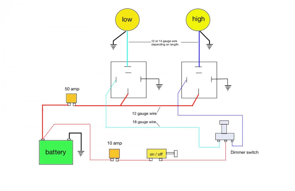

    Here is a headlight wiring diagram.

    No, it won't. On the latching relay you show 56 going to ground. It should be power from the headlight switch.

    That is exactly the way I had mine set up. The latching relay is the dimmer. There is power to the headlights already as the dimmer with a toggle switch to change to switch between horn and dimmer. Maybe a little hard to understand. I hope I am explaining it right.

    The latching relay is to switch from high beam to low beam, commonly called a dimmer switch.
    I suggest you need two separate switches (****ons). One for horn to ground, one for dimmer latch to ground.
    Using one ****on for two functions is probably possible, but ***bersome and dangerous.

    How would the lights turn off if one headlight relay or the other would always be grounded by latching relay?

    That is a good question. It will work if I just use the latching relay. Then the full power of the lights would go through the light switch and I am defeating the purpose of the hi and lo relays. Flipping the dash switch to the horn position would shut off the lights.
  22. RICH B
    Joined: Feb 7, 2007
    Posts: 6,298
    RICH B
    The relay stays in the last position (with either hi or lo beams on) until it is tripped the other way; so removing the ground would not effect it.
    If you removed the wires from the 30 & 86 terminals on your head light relays, powered both 30 terminals from your headlight fuses, grounded both 86 terminals, then put power from your headlight switch to terminals 30 and 56 on the latching relay, and wired your double throw selector (dash) switch with the horn ****on in the center terminal along with the horn relay & latching relay on the side terminals; it should work.

    I don't get the dash switch part. I think it would work the way it is.

    I thought that you wanted that switch in your sketch to enable the horn ****on to either operate the horn or act as a dimmer switch.

    With the single pole double throw toggle switch one way, the horn ****on will be able to ground the latching relay and act as a dimmer switch; with the switch the other way the horn ****on will act normal and be able to ground the horn relay. If the switch is in the center position the horn ****on won't do anything.
