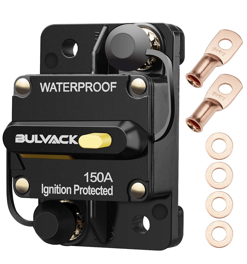

    So I have seen a few posts regarding master fuses, mega fuses, fusible links etc. I ran across these on Amazon and wondered if any one has considered one of these in their system? They seem user friendly, easy to reset and install and a available in many ratings. I have no experience with one - just throwing it out there for thoughts.
    https://www.amazon.com/dp/B08ZXK1KY...abc_X0S52S39HVK305N2323R?_encoding=UTF8&psc=1
  4. Boneyard51
    Joined: Dec 10, 2017
    Posts: 6,838
    Boneyard51
    My motorhome has a ton of these on it! They work and I have had no problem resetting one occasionally. So they should work great on any application if selected properly.
    Bones
    VANDENPLAS and 57tailgater like this.
