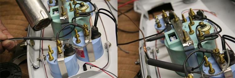

    The green stuff is more than likely oxidation and corrosion on copper. It should clean some of it off. It might take some light scrubbing with a cotton swab or something else that you can get to it with. then use the CC
  2. You won't find a spray-can product that will remove visible corrosion. Those are for removing oil, grease, light corrosion and dust/dirt mostly. That 'green' stuff is the copper/br*** equivalent of rust and is generally just as hard to remove. You usually have to get in there and physically clean it out, by s****ing, wire brush, media blasting. Sometimes the only real fix is to replace the connector and if the corrosion has 'wicked' into the wire, the wire also. I have seen limited success by using 'oxyclean' (yep, the stuff advertised on TV by cleaning a penny) by dipping the connector in the solution until clean but you have to be damn sure you get it all off after dipping or it'll keep 'cleaning' until the part or wire disappears. Rinse thoroughly with water then spray with WD40 to displace anything that's left.
    Most copper connectors are tinned to prevent this. OEM br*** types are where you usually have this issue.

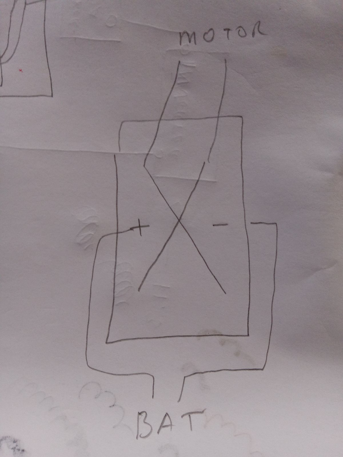

    Is this right for a dpdt switch to run a motor in both directions? 20221006_141918.jpg

  8. G-son
    Joined: Dec 19, 2012
    Posts: 1,553
    G-son
    from Sweden
    It'll be right for those that have the connectors in the right configuration. As far as I know it isn't standardized, so just going by position of the connections without checking what each connection actually goes to could get you into trouble.

  9. RICH B
    Joined: Feb 7, 2007
    Posts: 6,300
    RICH B
    DPDT switches always work that way.

  11. Uuhhh.... no.
    What kind of motor? There's a lot of different types....
  12. blowby
    Joined: Dec 27, 2012
    Posts: 8,664
    blowby
    from Nicasio Ca
    It's a DC motor, obviously, 12v reversible. I don't know if it is brushless, permanent magnet, etc., not here with me at the moment. Does that make a difference? Found this online.

  13. Blues4U
    Joined: Oct 1, 2015
    Posts: 8,221
    Blues4U
    from So Cal
    The problem I see with that is the switch is carrying the full load if the motor. Depending on the application that could over load the switch and cause it to fail. I would use relays to carry the load and use the toggle switch to trigger the relays.

  15. It can make a difference. There're permanent magnet types, series-wound (typically used for OEM heater fan motors and older starters), I've even seen some that have two leads where both are + leads and one is forward and one reverse with the ground supplied through the housings. Nearly any motor can be reversed as long as it has at least two leads, but the switch configuration and wiring can vary.
    The switch shown is a reversing switch and not a common configuration. A 'standard' 2PDT w/center 'off' switch can be wired to operate like that but will have six terminals rather than four. Automotive reversing switches are used for power windows and tops so they're not hard to find, but styles are limited and you'll need to make sure they can carry the current involved. If any of that is an issue, you can use a 1PDT w/center off switch and two relays to do it.
    Your drawing is actually correct but the lack of detail threw me...

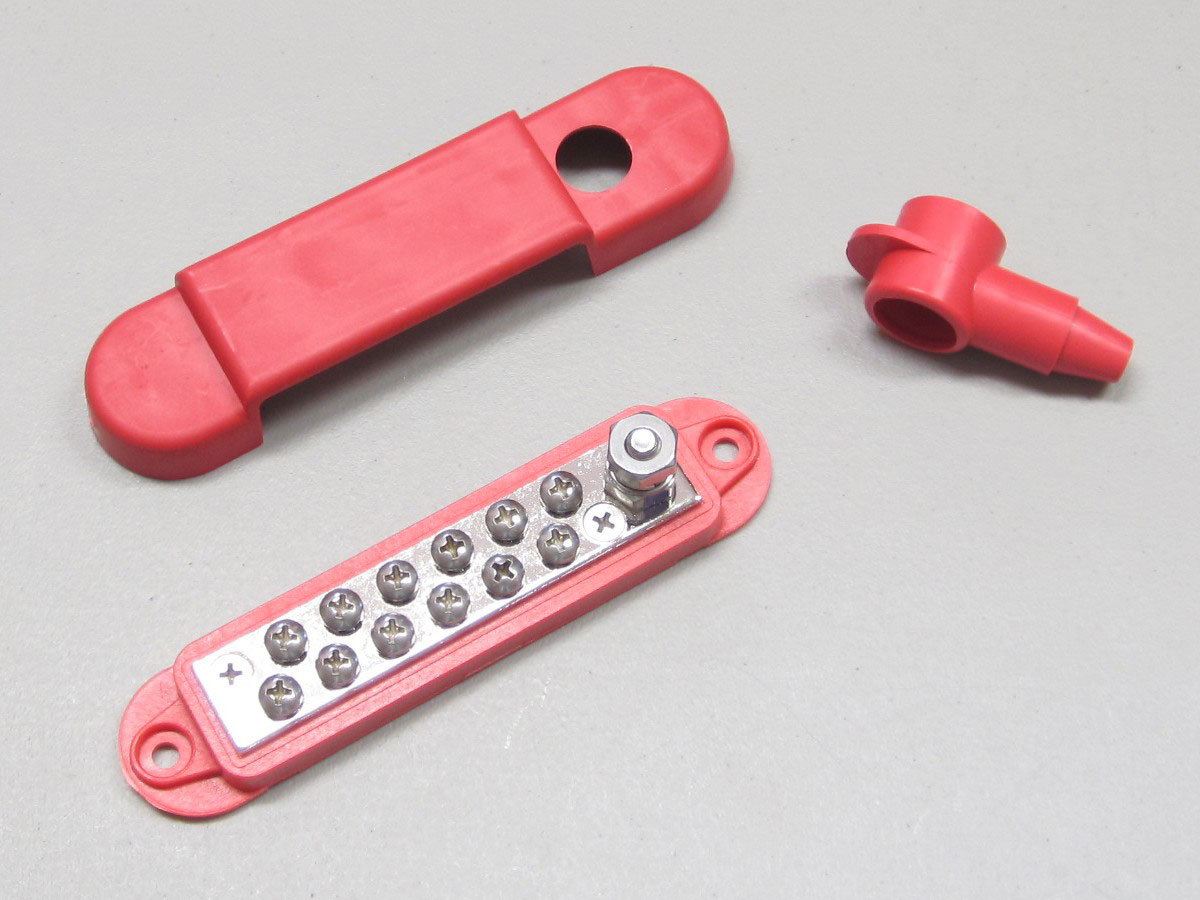

    I have a question pertaining to wiring up the dash, in particular gauges. Am I ok to join each gauge to each other for the power, earth and lights? That is, starting at the 1st gauge connecting the power, earth and gauge light power then making short loops to the next gauge and on and on across all the gauges.
    If not do I need something like this Power block?
  20. Go ahead and loop them, that's standard practice.

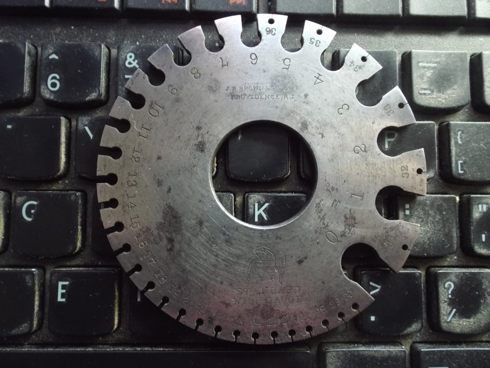

    DSCF0092.JPG Antique resale collector value item, or do people still use them?
    Bob
    Blues4U likes this.
  22. Pretty much just a forgotten antique these days. Useful back when wire was still cloth-covered and there wasn't any size/use info printed on the insulation or if it became illegible. Last time I saw one in use was by the 'old guy' at a motor rewind shop and that was 30 years ago.

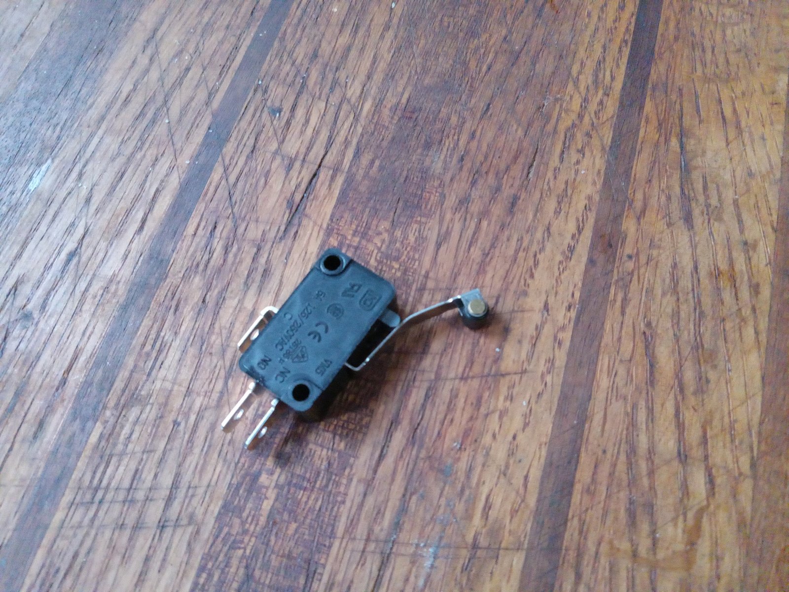

    I want to upgrade this switch from 5A but not change the two mounting bosses. Do they get bigger with larger amps?
    Miss Radio Shack..
  27. Blues4U
