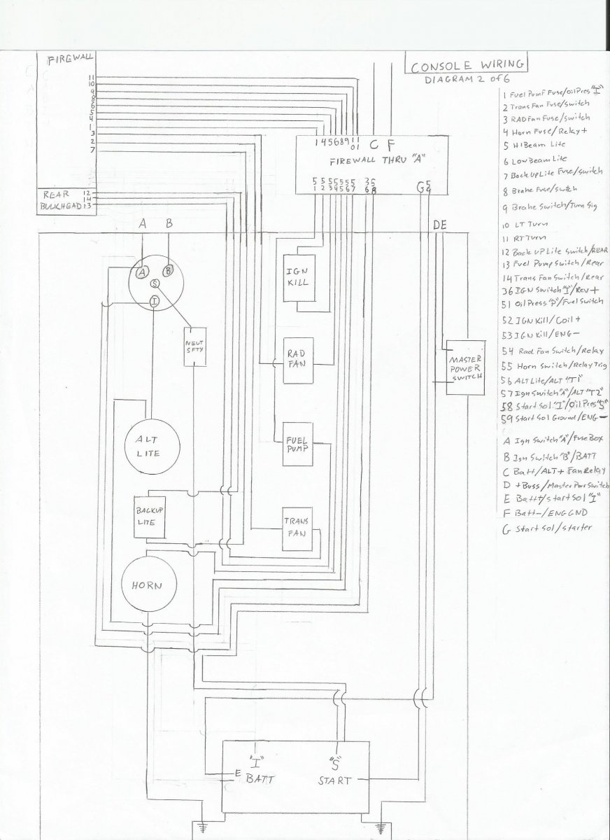

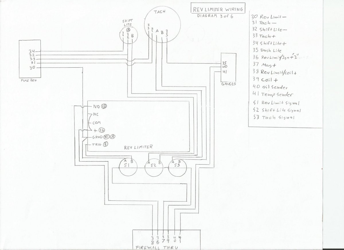

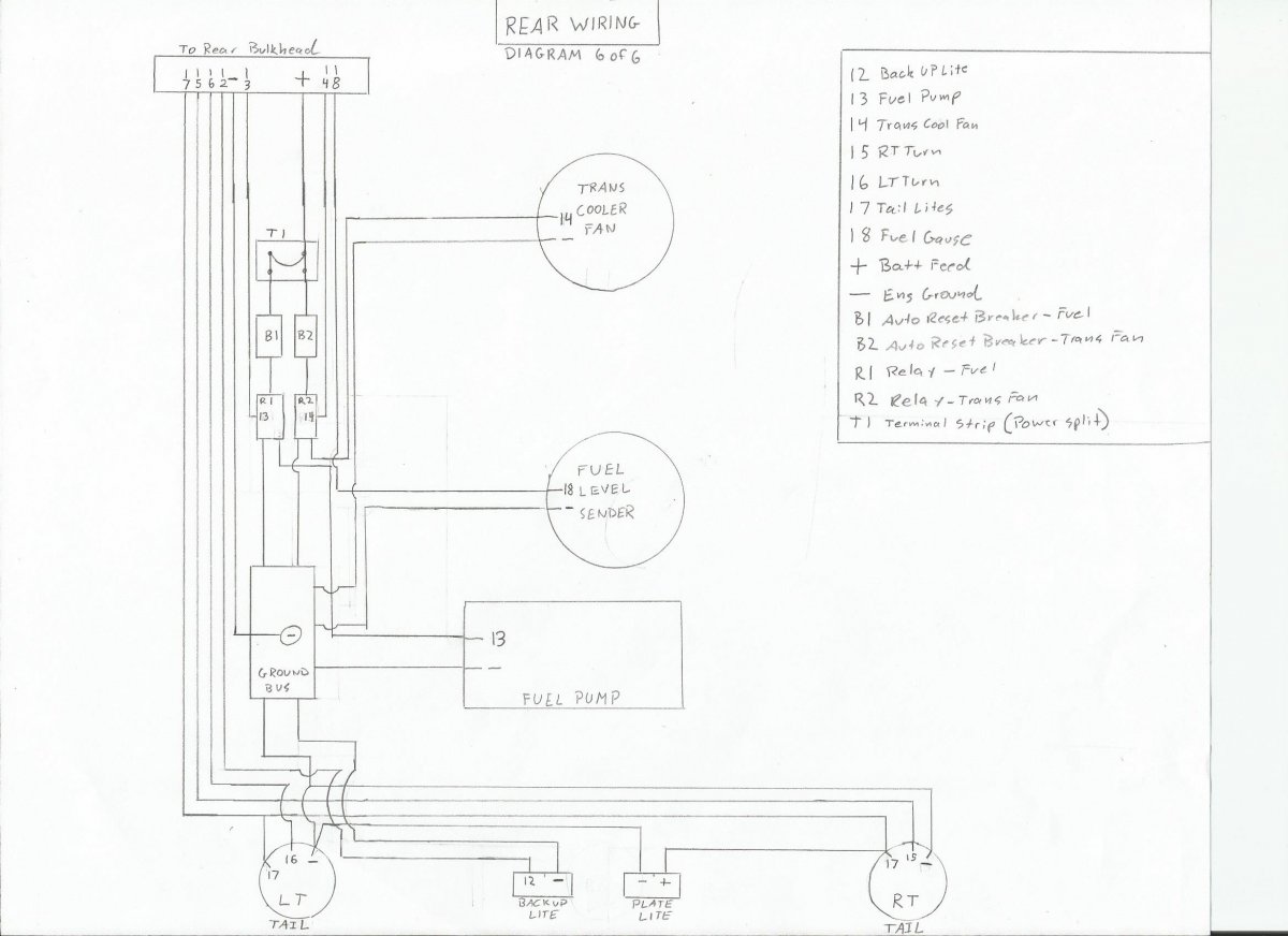

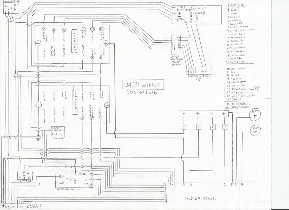

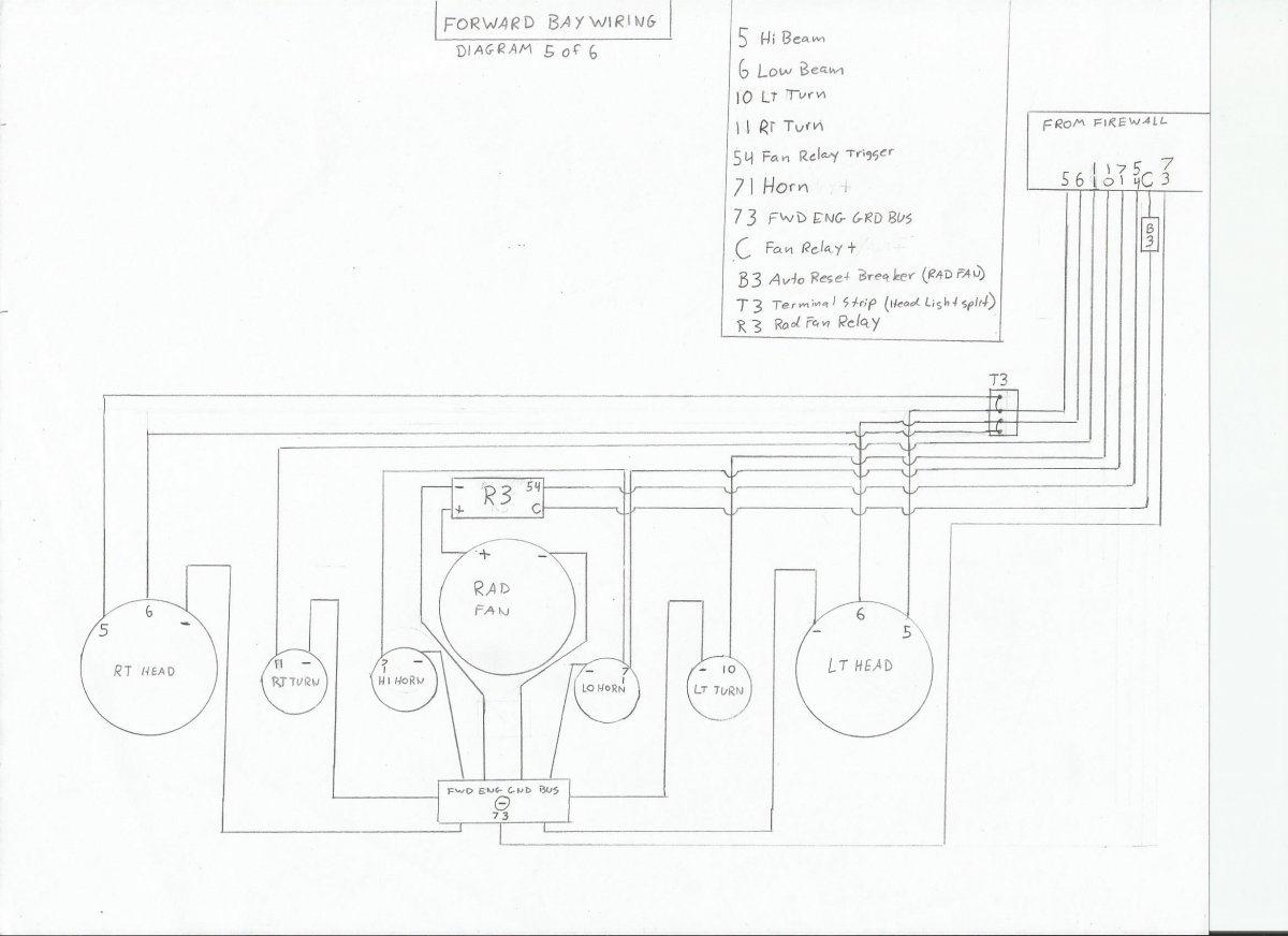

    Below is the entire wiring diagram for this build. It is a pain to look over on a computer and would love to hear of a decent program to put it into for easier review but paper an pencil still seem to work. I don't do this for a living so its not a perfect illustration but I'm looking for accuracy over pretty as long as its is useful.
    Feel free to look it over. Ask questions please. There are 6 diagrams.

  18. Blues4U
    Joined: Oct 1, 2015
    Posts: 8,068
    Blues4U
    from So Cal
    Question about your Master Power Switch, why on the positive side? Most all heavy earth moving equipment use a similar master disconnect switch, but the usual location is on the negative side.

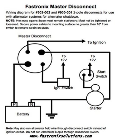

    Question for those who have or are running an external coil vertex mag. I'm running the mag kill switch as vertex calls for Coil+ to Engine ground. I would like for the battery master cutoff switch in diagram #2 to cutoff the mag along with the the rest of the batt power.
    Question: If I run a 4 pole cutoff switch instead of the 2 pole, I can use it to break connection between Mag + and Coil + to kill the mag and batt power in the same switch. Is breaking connection at this point viable?
  20. 01mikep
    Joined: Jul 26, 2014
    Posts: 125
    01mikep
    I drew it up that way because the install instructions had it that way. Are both methods correct or are the instructions wrong?

  21. 01mikep
    Posts: 125
    01mikep
    These are the instructions I was referring to.

  23. David Gersic
    Joined: Feb 15, 2015
    Posts: 2,812
    David Gersic
    from DeKalb, IL
    Disconnect should be on the hot side.

  28. Blues4U
    Joined: Oct 1, 2015
    Posts: 8,068
    Blues4U
    from So Cal
    I wouldn't say the instructions are wrong, I was just wondering why it was on the hot side. Having worked on hundreds, if not thousands, of pieces of heavy earth moving equipment, I'm just used to seeing them on the ground side and wondered why you had it on the hot side. Seems like the RV/Trailer industry puts the master disconnect on the ground side too.

  30. One suggestion I'll make about wiring diagrams.... Most try to do a single diagram with everything on it. If your harness is much more than a very 'basic' harness, these can be very hard to read and even harder to draw. What I find that works better in most cases is do a diagram that shows all the components and the harness (not the individual wires) representing more-or-less actual location of components and route of the harness in the vehicle. Then draw up individual circuit diagrams for the various sub systems (lights, gauges, etc, etc), the more detail the better. The individual diagrams will much easier to follow, and the 'main' drawing will tell you where to look for the circuit.
    The OP is on the right track by using multiple diagrams, but separating them into circuits would help.
