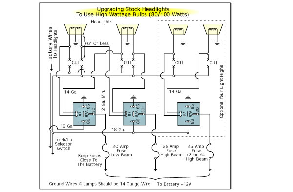

    I have upgraded my four headlamp system with relays. They are brighter and it takes the load off the old headlamp switch. Here is a simple diagram.
  15. ffr1222k
    Joined: Nov 5, 2009
    Posts: 1,458
    ffr1222k
    I did this on my daily driver ('88 T-Bird Turbocoupe). The factory light switch and multifunction switch had got hot enough for the plastic to be deformed. The relays made a big difference in my light output.
