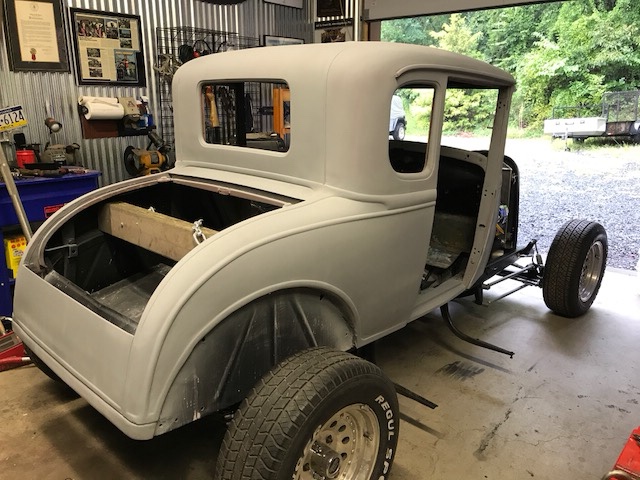

    Getting ready to start the wiring process on my Model A coupe and need some advise. I’m leaving the original gas tank in place for now so I have limited space under the dash. I have not seen anybody mount the fuse panel under the seat, reason? Any other pointers will be greatly appreciated. Also thinking of an adjuster for the seat so i can move it backwards and a hinge to so I can fold the seat forward to get at the fuse block. [​IMG]

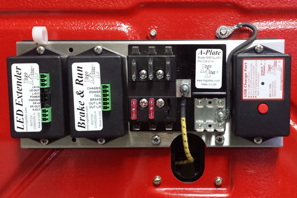

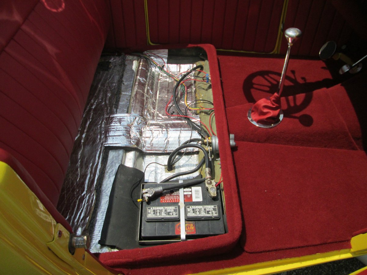

    First off cool looking ride. I plan to mount my wiring under the seat of my channelled roadster. Trying to get between the seat and floor under the dash I feel would be a pain. I pulled a few pictures off the web for ideas.

    Thanks for everybody’s responses, I like the underseat option with the starter selonoid very close on the p***enger side. Never thought about the drivers side kick panel, great idea which I will have to explore mounting options. Nice to hear from the “Pro’s “ on this site.

    FYI, this is my first Model A, it’s an all steel full fendered stock body car with very little rust ,always been a muscle car to tri five guy. Been very enjoyable process learning new things.

    Wired a few A's ..always put under the seat
