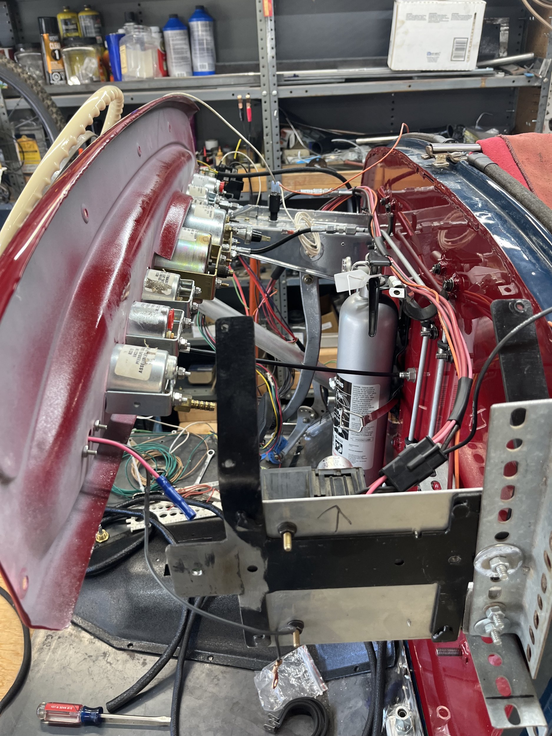

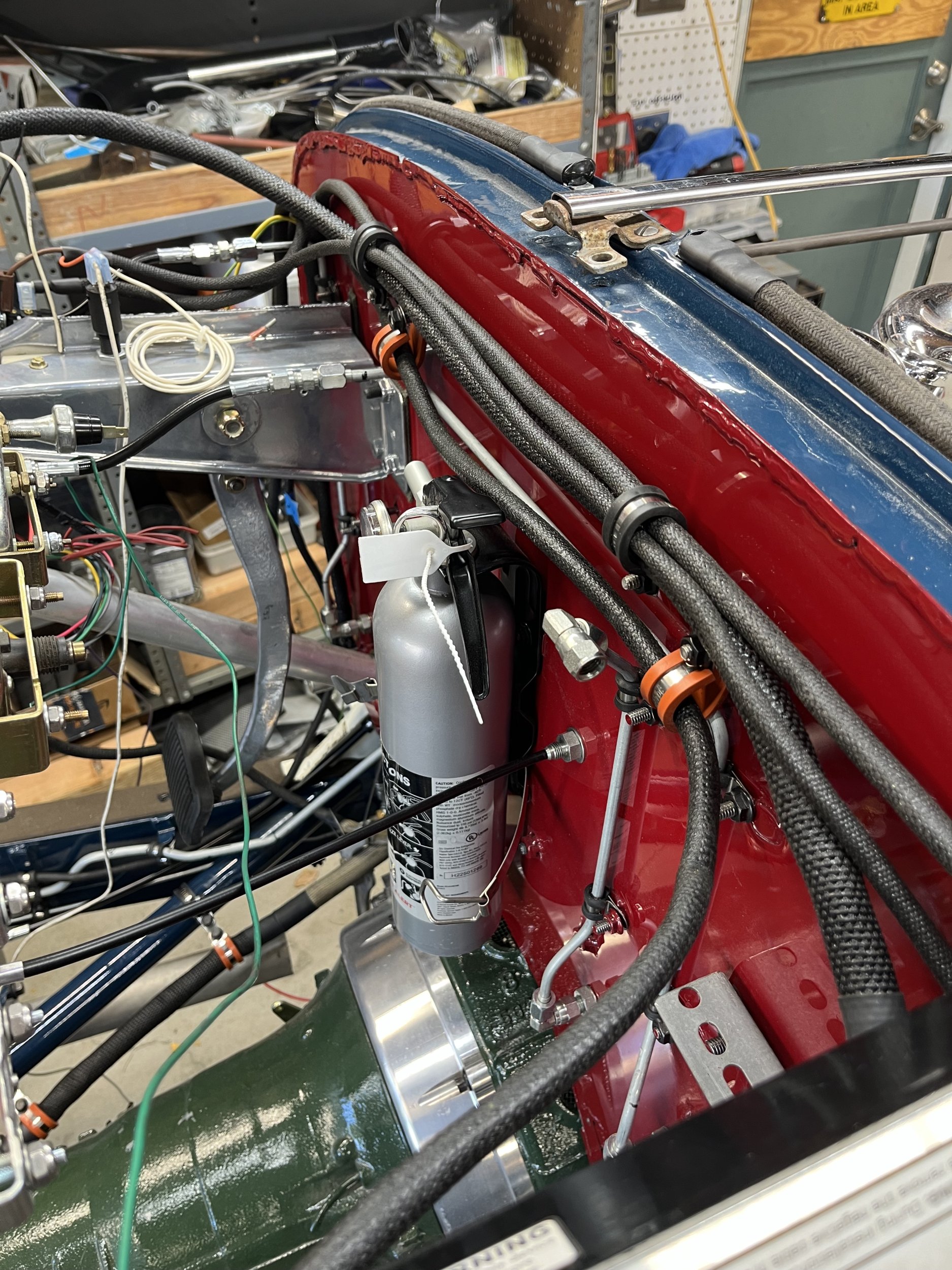

    Put the fuse panel and other ***orted stuff in the trunk behind the seat. I've wired a couple roadsters that way and it works great. I use Coach Controls Roadster 18-circuit Kits for the simple stuff. They offer a "long wire" option on all their kits and I've never had a problem putting the panel in the trunk, even on full-size cars. Mount everything on a 1/4-inch sheet of ABS on your work bench and go from there! Ship the car to CA and I'll do it for ya! :D
    Here's one example that I did on Joe Kugel's AMBR Roadster from 2022...

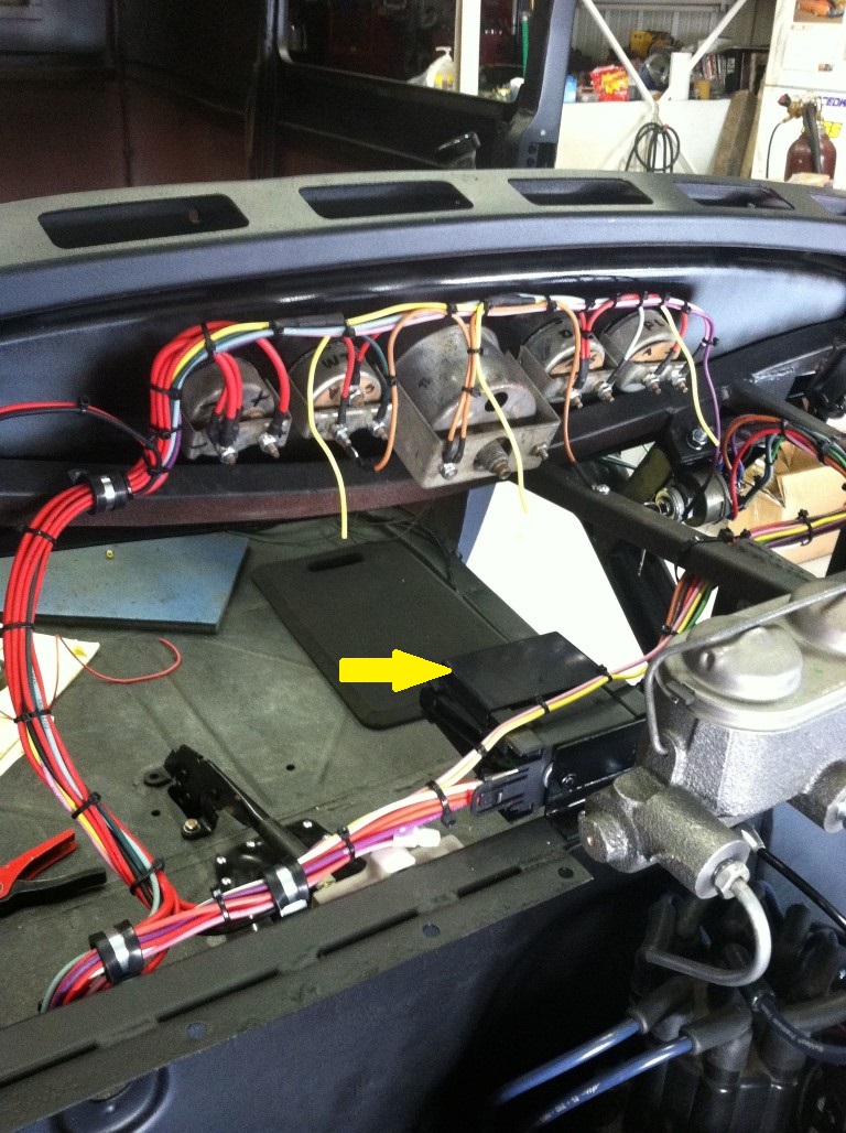

    I wired my dash on the bench and put some plugs ends on the harness. Now when the dash is mounted I have 2 plugs to plug in, I am to old and fat to lay upside down under the dash.
