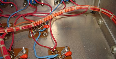

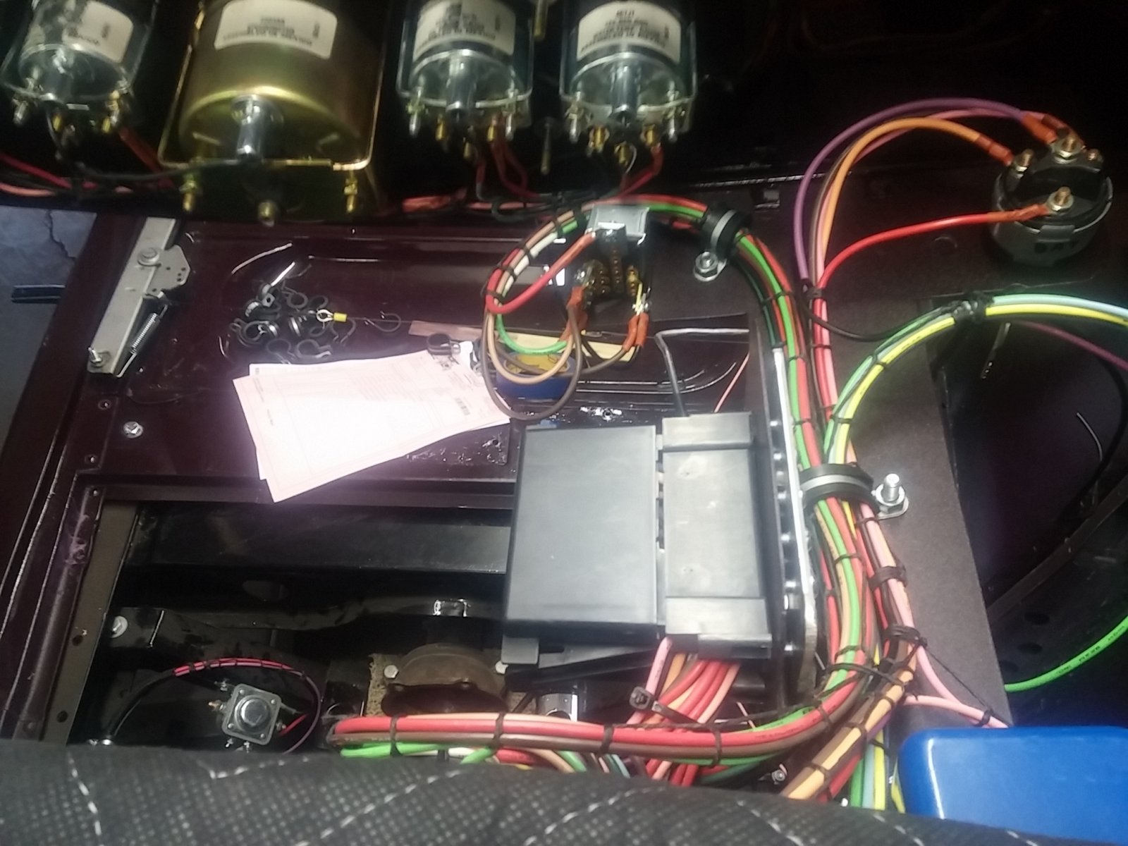

    anothercarguy, WB69, Huge and 13 others like this.

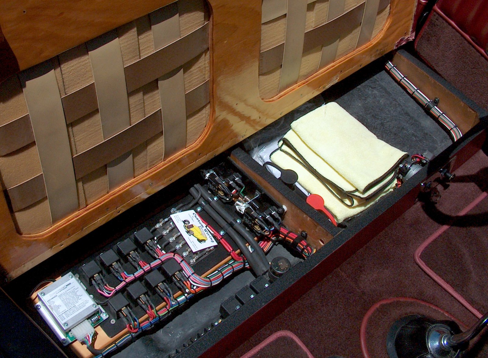

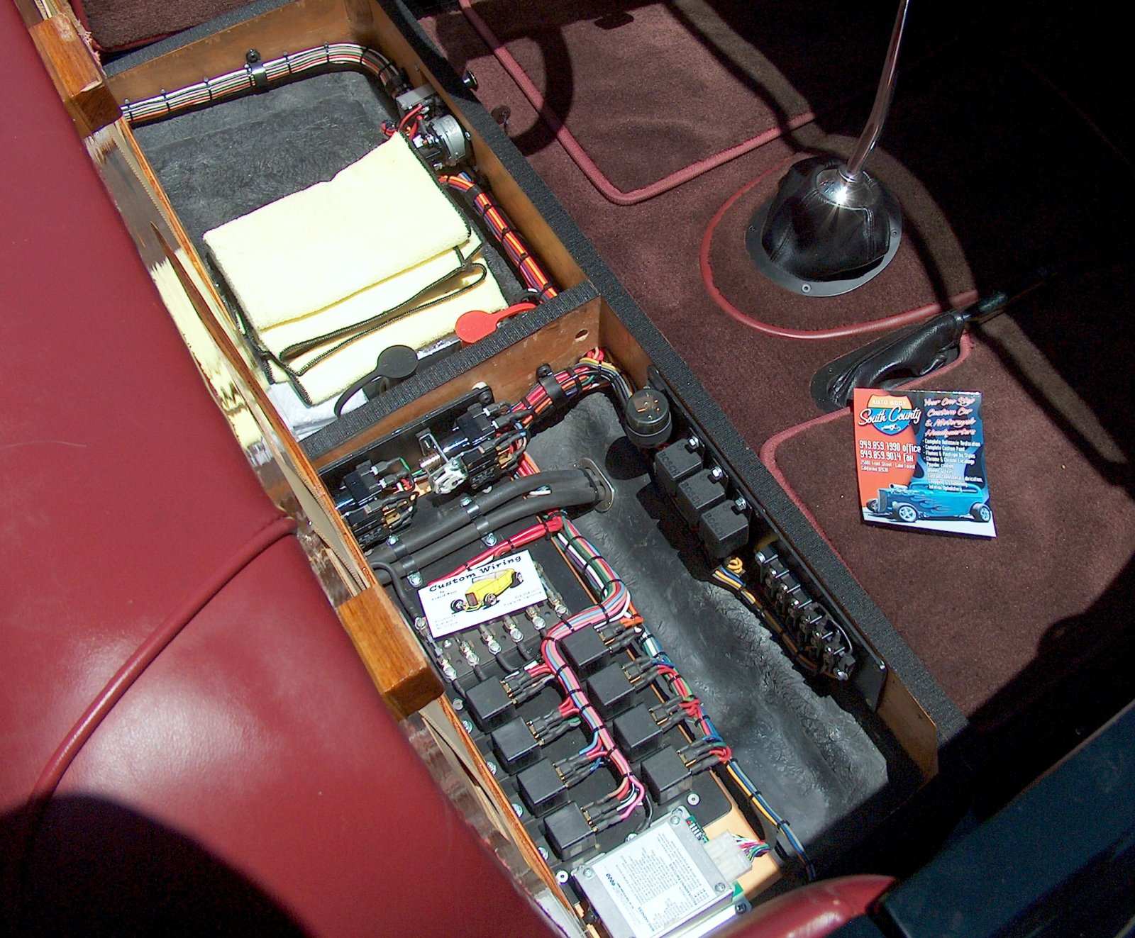

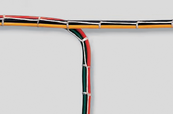

  19. 90EBFF63-F474-4AD5-B13D-9E883E11D7BB.jpeg E76CD51B-4C9E-43B7-B481-B0A3C195D091.jpeg
    cable lacing
    Friction tape
    This stuff is cool we use it on forklifts and equipment very good flexibility and it won’t rub through or chafe
    Or plane old convoluted tubing . Not traditional , but still a clean look .
    The 39 guy likes this.

    Pics of the week for me. Excellent work. Makes me feel all calm and settled, and that the world is as it should be.
    Thanks, man........:)

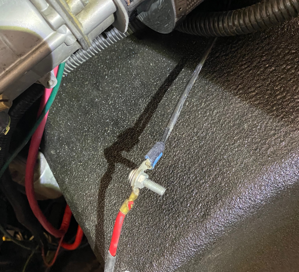

    I am trying to locate the wiring faults on my OT sand thing and I started with any where there is tape or a lot of wire ties. So far that technique has yielded some interesting finds. Here is a good one, peel back the tape and see what you get. It is like opening an Advent calendar without the candy. Oy yeh!

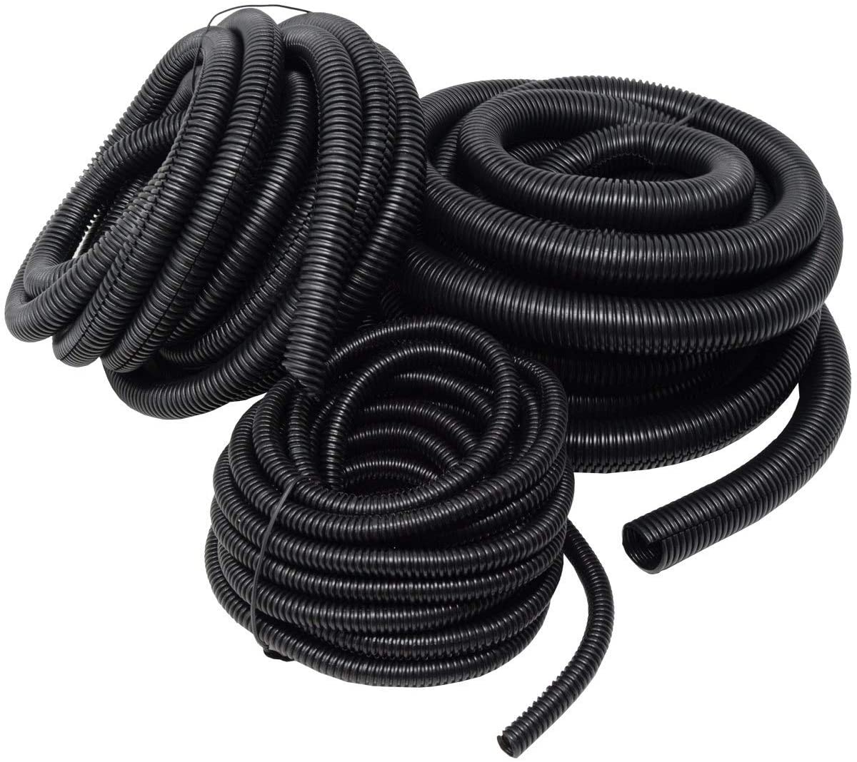

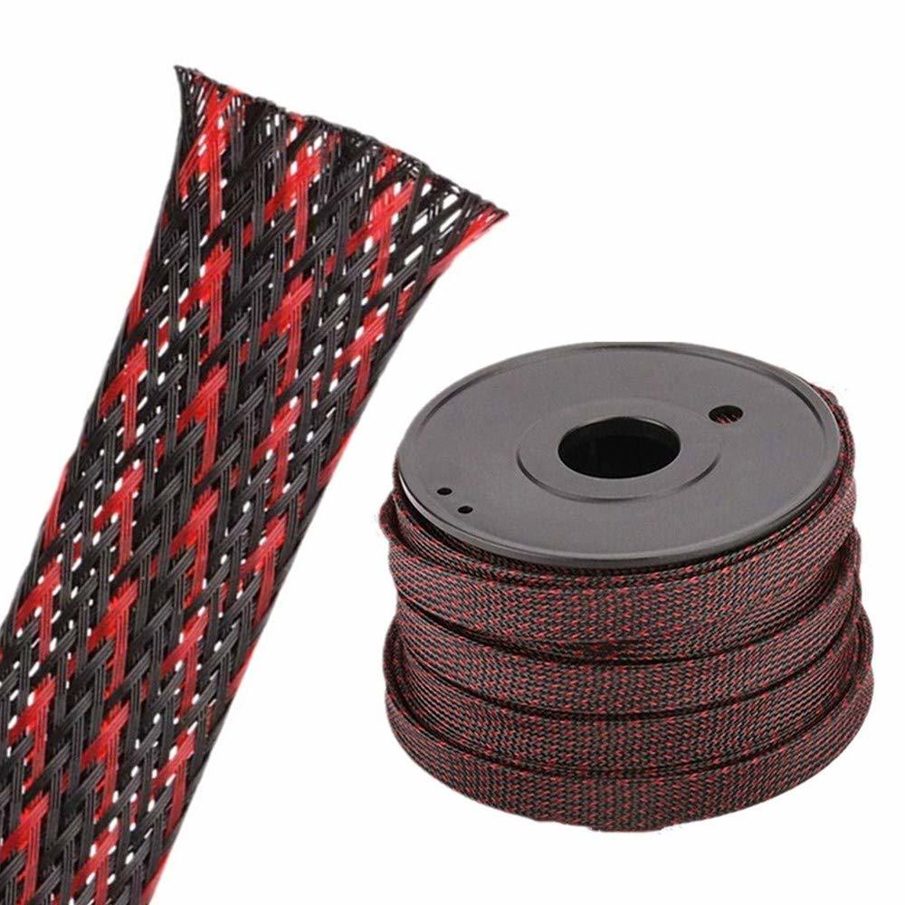

    I bought some split loom off of eBay like in Vandenplas's 4th pic down. Got three different sizes according to the wire bundle size. It being black woven it doesn't stick out like the convoluted loom does.
    pprather and VANDENPLAS like this.
