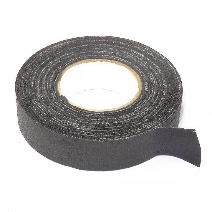

  1. Friction tape:
    Spiral cable wrap:
    Self fusing rubber tape:
    I wanted to be able to add wiring or repair it easily on my panel, so I used split cable sleeve:

    You can get non-adhesive electrical tape, both in a modern smooth style or in the old fashioned fabric style. You have to come up with a way to secure it at both ends (a short section of shrink tube is one way, in the old days they would just tie a knot in it) but it has the advantage of not getting all sticky and can be unwrapped without making a mess. I bought some years ago from Eastwood but I don't think they carry it anymore.
    Going the other direction, you could use silicone self-fusing tape. When wrapped tightly it fuses to itself and can make a watertight seal, but doesn't have any adhesive that will get sticky over time. Here's one example, but most hardware stores or big box stores sell it - you may have to look in the plumbing section, since it's used for sealing up leaky pipes. https://www.homedepot.com/p/Nashua-...sing-Silicone-Tape-in-Black-1743082/100206050
