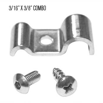

  25. Run it where you can fix it easily, if your running it outside use a cover and strap it to the frame. The covering like Gimpy showed is hydraulic hose cover, available in different sizes. On my '28 It's going to be along the frame rail by the brake line (to front and rear) and into the interior through the floor on the p*** side next to the cowl.
    I'm going to use these, brake line on the bottom and wiring in the top and then paint them black.
    nochop likes this.

    I use the cushion clamps, something like this arrangement. I have a **** load of them image.jpg
    1oldtimer likes this.

    If you can bend brake line, why not bend conduit to run the wires through and attach it to the frame rails?
