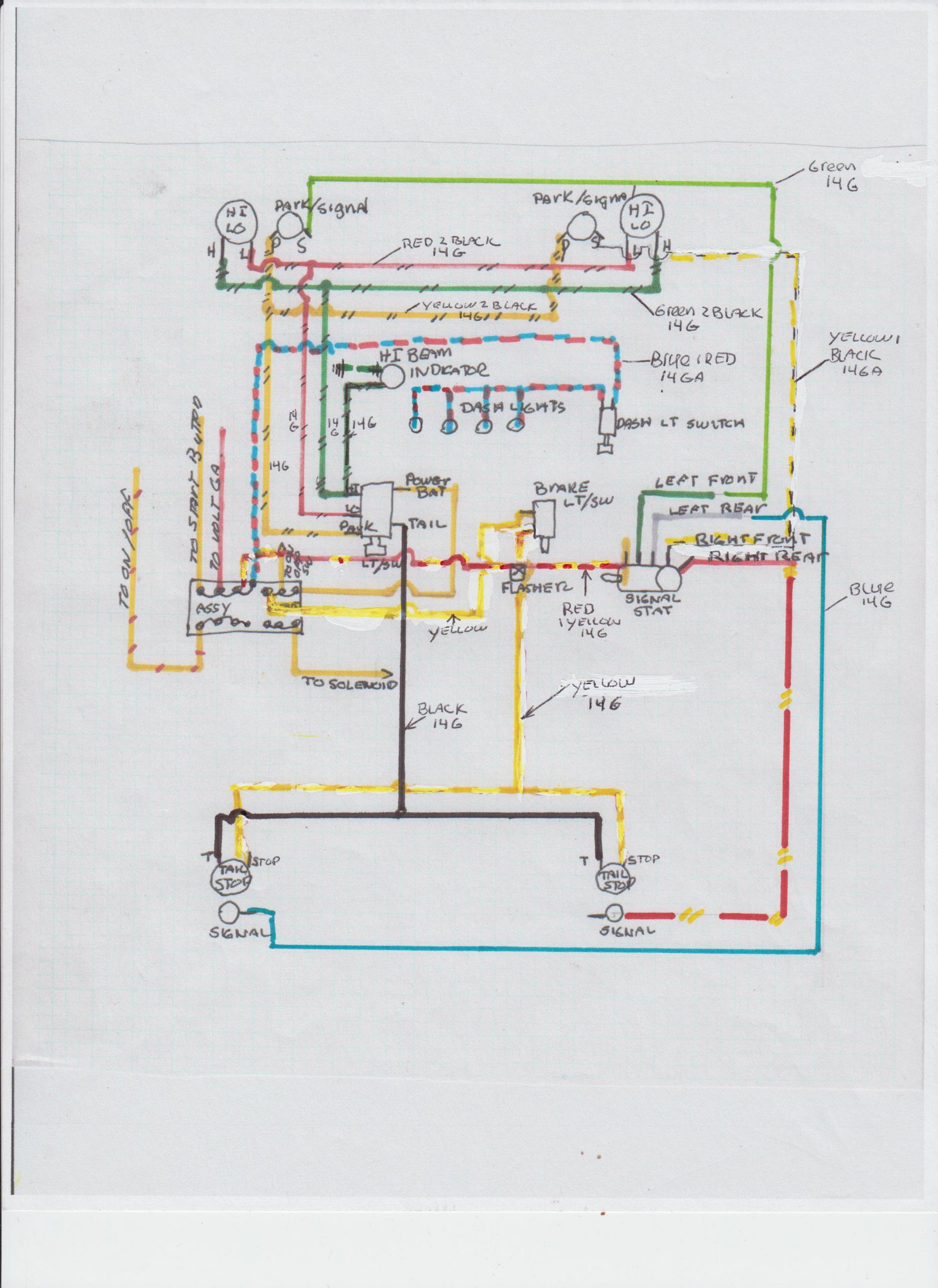

    Here is what I did for my roadster. It is simple No air, radio, cd, power seats, power top, mpd, xwc##pd.:eek: You get the picture BASIC:cool:
