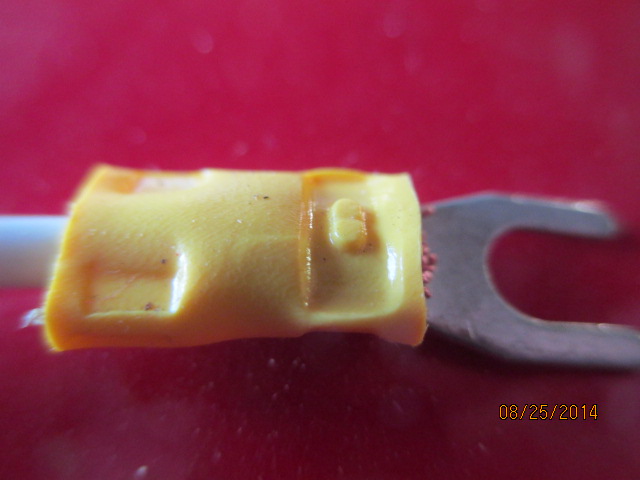

  12. elba
    Joined: Feb 9, 2013
    Posts: 628
    elba
    Use aircraft crimpers. They are the BEST !
    lothiandon1940 likes this.
  13. elba
    Joined: Feb 9, 2013
    Posts: 628
    elba
    Here is a pic of the crimp. Terminal will never slip off.
    Jet96 and lothiandon1940 like this.
