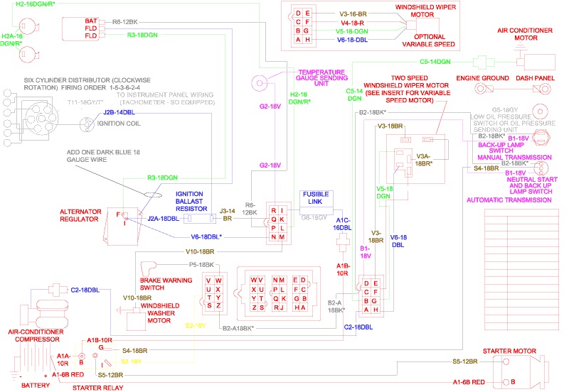

    Can someone please help me with this. Have no wires in place and wiring diagram is confusing the hell out of me. I should be able to do this in my sleep but I just can't get it right for some reason.I need the most basic simplest diagram to get this darn thing to start, run and charge. All stock but new parts 1966 Plymouth Fury 318, auto, 2 wire alternator, field/ign mechanical voltage regulator, ballast resistor, points ignition, 4 wire relay, 2 wires on starter and a battery and 5 pin starter switch. I'm 75 now and memory isn't what it used to be. Big thank you in advance.

    that's the wrong regulator for what he has...
    I'll see what I can find after I get going this morning.

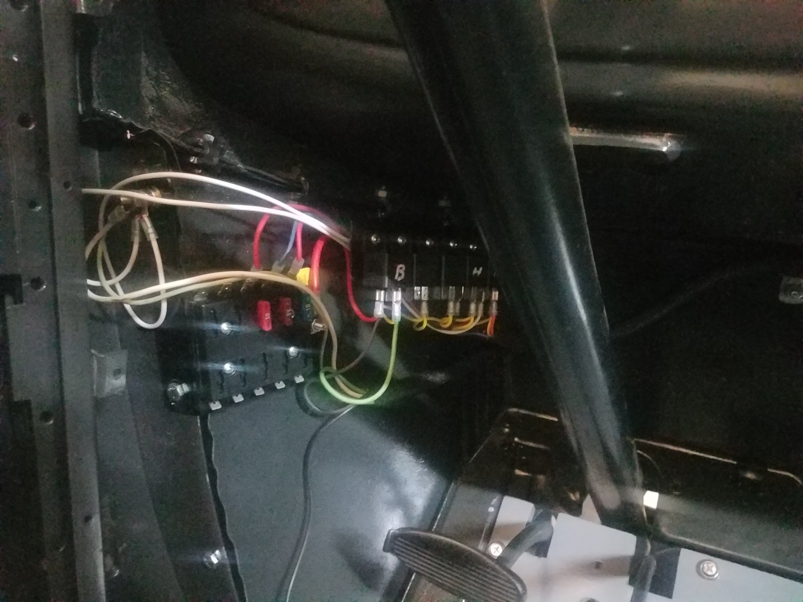

    5C991172-3AFA-4614-B8FD-FBA4A0B6416E.jpeg Old knuckle dragger heavy equipment mechanic, you don’t need a pocket protector to custom harness a car. Modern electrical systems use low amp switches to control relays, each circuit fuse protected.

    Alternator: connect the screw terminal to the battery. Connect the field terminal to the field terminal on the voltage regulator. Connect the IGN terminal on the voltage regulator to the IGN contact on the ignition switch.
    Coil: connect the negative side to the distributor points wire. Connect the positive side to the cold side of the ballast resistor.
    Ballast resistor: connect the hot side to the IGN contact on the ignition switch. Connect the cold side to the IGN 2 contact on the ignition switch (this contact is engaged only when you are cranking the engine)
    start relay: connect the big stud to the battery, and to the starter big stud. Connect the small stud to the starter small stud. Connect the Start terminal to the Start terminal on the ignition switch. Connect the GND terminal to the neutral safety switch on the transmission.
    I wish I could make it more plain, I"m on the road again and can't really draw anything right now.
    maybe someone else will?
