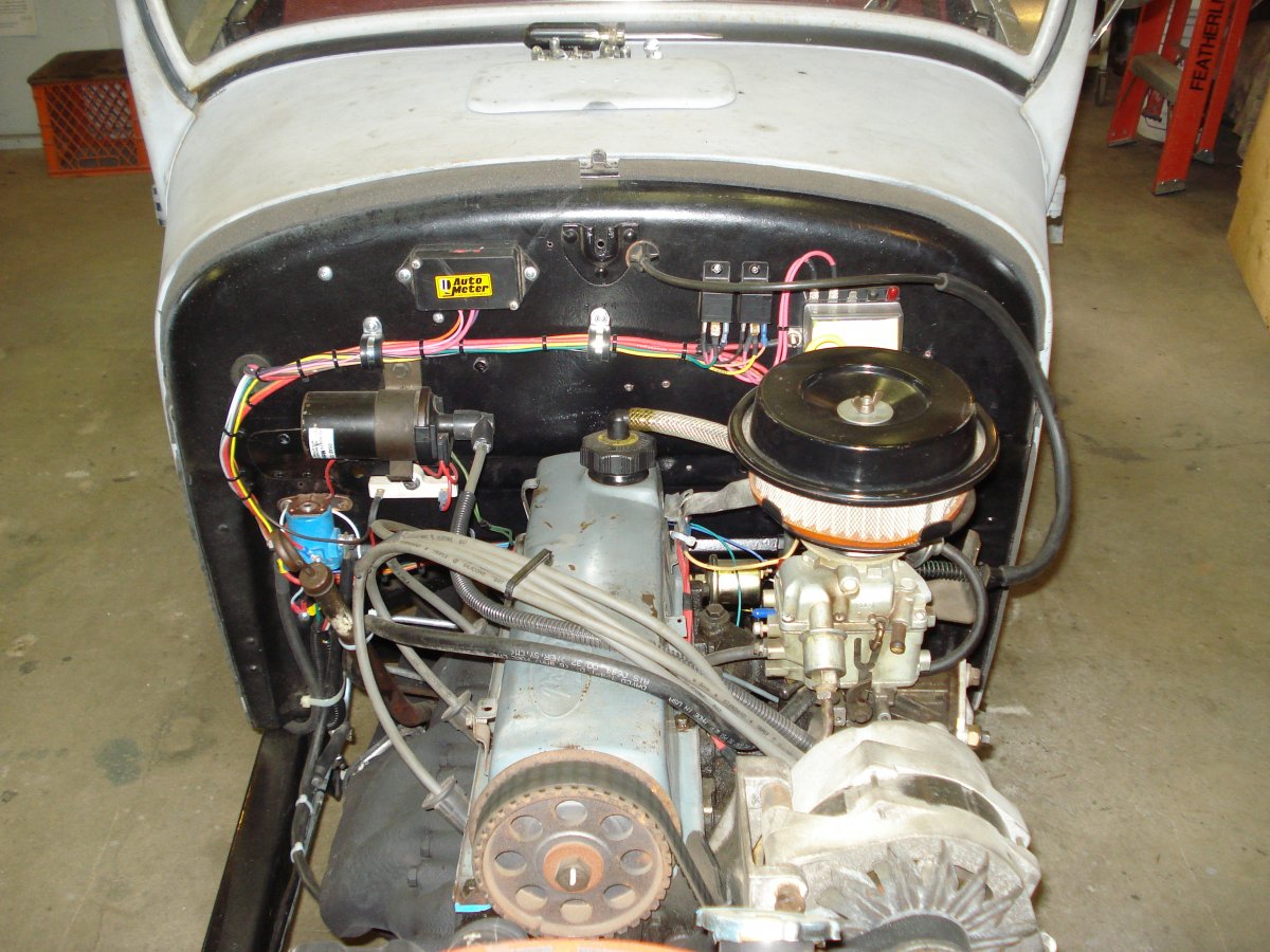

    They're wrong, as you know, using a relay in the light circuit re DSC05876.JPG moves some of the power (heat) from the switch, and gives the lights more and steadier power making them as bright as they can be.

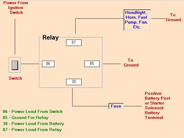

  13. lothiandon1940
    Joined: May 24, 2007
    Posts: 32,713
    lothiandon1940
    Just thought I would post this. Maybe it will be of some help to folks wiring in a relay for whatever reason. relaywire[1].jpg
    2Blue2, ekimneirbo, Just Gary and 4 others like this.
