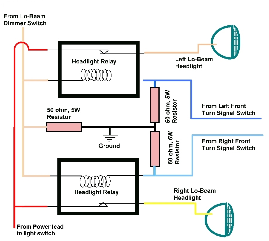

    Also like to use them for fun stuff like this circuit I put in all my builds that turns the car's headlight low beams to turn signals. Serve double duty by powering the headlight signal lights while protecting the turn signal switch and dimmer switch from high current. I have fried dimmer switches before with out relay protection.
    They aren't solely for the purpose of protecting circuits and switches. Relays aren't intrinsically good or bad. They are great where they serve a purpose.

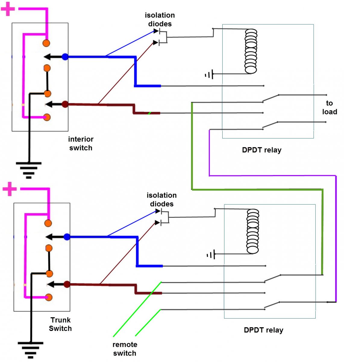

    And on my Mysterion cloning project I used this relay based circuit to allow the top and ch***is to be raised and lowered in several ways; by remote control; by switches outside the car in the 'trunk' (more like a glove box on this car!); or by switches on the dash. The circuit is hierarchical - the trunk switches over ride the remote, and the dash overrides both the others so the drive doesn't get locked in by some joker outside! One of these circuits control each of the two functions.

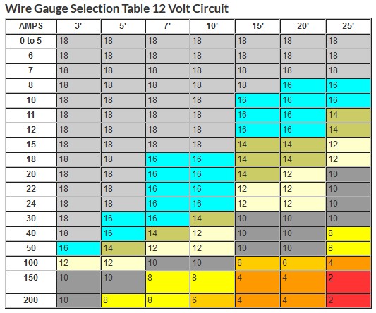

    try to always use stranded copper wire no gauge smaller than 14, less resistance with more strands!

    14 ga for the majority of circuits in a car is m***ive overkill, but other than an alternator charge you'd be hard pressed to fry it.

  24. That chart is an invitation to a fire..... And will also give you large voltage drops at most of the lengths shown, some well above 5%. It's this sort of misinformation is why guys need relays to 'fix' issues in their harnesses.
    Maximum wire ampacities: #18 - 6A max fuse size, 5A max load. #16 - 8A and 6A, #14 - 15A and 12A, #12 - 20A and 16A, #10 - 30A and 24A, #8 - 40A and 32A, #6 - 55A and 44A, #4 - 70A and 56A, #3 - 85A and 68A, #2 - 95A and 76A.
    And while these amp numbers will give you a 'safe' install, they still don't guarantee that you won't have excessive voltage drops on longer runs. I do a voltage drop calc for virtually every circuit/wire, and keep the drops to below 3% max, preferably less. If I have to bump a wire size up to reduce drop, that's easier than adding a relay and yet another circuit.
    It is possible to 'cheat' a small wire in sometimes, but only in very short lengths. As an example, a #10 wire can carry 50A in a 6" length and only have a drop of .14%. This will produce almost no heat, and while I wouldn't recommend it, will work. But by the time the length gets out to 10 feet, the drop is up to 3.6%, enough to start affecting circuit performance. At 16 feet, it's now up to nearly 6% and you WILL notice the voltage drop on most circuits. And voltage drops add up; if you lose 3% between the battery and the fuse panel, everything downstream from the panel is short the 3%. Lose 3% from the panel to the device, and now you're down 6%. Use that chart and you could have drops in the 10-14% range or more by the time you get to the last device. And the larger the load, the bigger the drop. Checking this with a meter without the load connected and energized will tell you nothing.
    Voltage drop calcs can be involved, but luckily there's calculators available that make it easy.... I like this one best...
    http://www.calculator.net/voltage-d...nce=10&distanceunit=feet&amperes=50&x=76&y=25
    Plug in your wire size, material (copper), voltage (I use 13.8 as that seems to be a common value when the system is charging), DC (not AC), single set of conductors, circuit length, and load amps. Note that this ***umes the distance is one-way, so it doubles the wire length. For use here where your ground path is probably through the body/ch***is, cut the length in half. If you have a fibergl*** car and/or are running ground wires, don't cut it in half.
    Personally, I wouldn't use anything smaller than #14 in a harness. The cost difference is minimal, it will reduce the number of different connectors you'll need, and the wire is physically stronger compared to 18/16.
