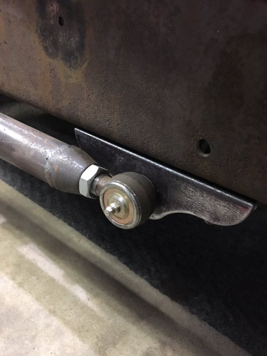

  2. burl
    Joined: Nov 28, 2007
    Posts: 911
    burl
    from Minnesota
  3. 48fordnut
    Joined: Nov 4, 2005
    Posts: 4,215
    48fordnut
    That's what I want to do. Just wondering if the angle will be too extreme. Burl do you have a pic from a few feet away? Nice looking bracket.
  4. burl
    Posts: 911
    burl
    from Minnesota
    EFB1D830-D91B-4AED-829E-1170682BFC99.jpeg Here’s a pic. It’s a mopar but kinda the same
    Stogy, bct, kidcampbell71 and 2 others like this.
  5. 48fordnut
    Joined: Nov 4, 2005
    Posts: 4,215
    48fordnut
    That's about what I want . I think I will have more of an angle than that. BTW I shared some pics of yours from 2013. awesome photography and pics.

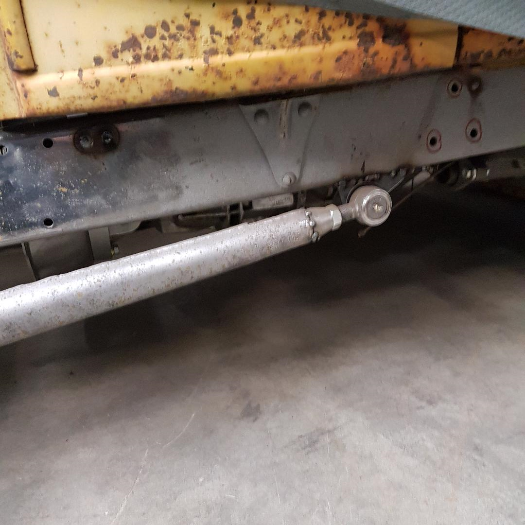

  8. burl
    Posts: 911
    burl
    from Minnesota
    It’s just a piece of heavy wall angle iron with a bushing with a tapered hole to accept the tie rod end. The radius detail was cut on my rotary cross slide table on a bridge port mill but could have been cut out and blend the radius
    Stogy likes this.

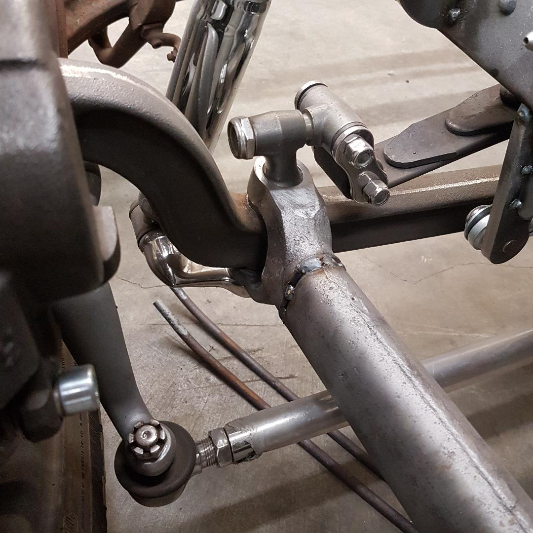

  11. akoutlaw
    Joined: May 13, 2010
    Posts: 1,641
    akoutlaw
    Mine tacked together.
  12. 48fordnut
    Joined: Nov 4, 2005
    Posts: 4,215
    48fordnut
    looks like mine. Need to get some weight on the ft end so I can see where they need to be,
