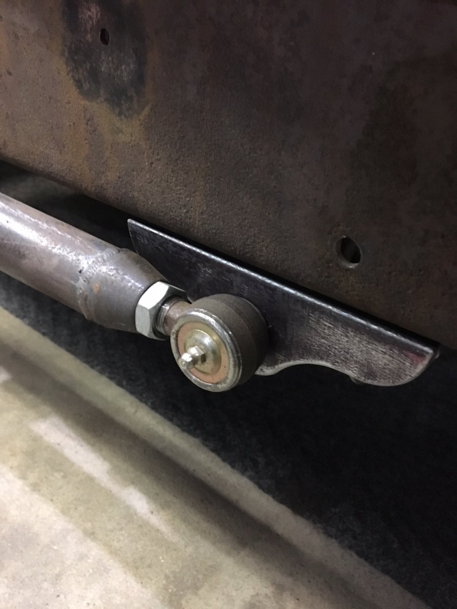

    Ends are a twin to mine.

    Your brackets appear to be what the "factory" would have done if splitting wishbones had been an option.

    Thanks Gary,
    I like to make things look like they belong or could have been factory
    48fordnut likes this.
