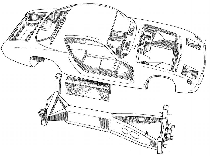

    While still using Lotus for an example :
    For a T Roadster [or Bucket] with their flimsy ladder frame.
    If you're going to have a low seat position, fold up a reasonably high driveshaft tunnel out of sheetmetal[ >-< shaped looking from above]
    Use this as a "backbone" frame [stiffener] similar to Lotus Elan frames [pic attached]
    This would do wonders in the ch***is handling dept.
    If you're going to use a rear cross-member or "X" shaped cross-member for the rear trans mount , you might as well get it to contribute to the overall torsional stiffness of the whole frame
  7. GEGE

    Firstly, with regard to your post #29, are you saying that the suspension should be setup/tuned to match the conditions the car will see most? If lower speed cornering is all that is required, a little bit more of a soft ride can be incorporated. If high speed cornering is needed, it should be stiffer, thus sacrificing ride quality. Seems to make sense that the faster you want to corner, the stiffer it all needs to be.
    Re the Lotus Elan frame idea, if a "traditional" look was needed for the frame, could the folded tunnel be used between the rails, attached by some sort of mini K member/X member each side that is rotated 90 degrees? Also, the tunnel attached at the rear crossmember.
    In your picture, is the tunnel structure the dark piece in the middle, or is it part of the lower backbone frame?

    In the picture I posted, I am referring to the backbone frame at the bottom. If you could use this section between the traditional frame rails it would increase torsional stiffness [and be hidden]

    Ok, so it is a case of tune to intended use. Makes sense. I will want mine for open road use. It will be definately a "driver" for long trips (winding roads included), not just a Saturday night special.
    Could the tunnel ***embly be fabricated as shown at the bottom of the picture but with the ends trimmed off so as to make an X member, and then fitted as a unit between the frame rails (hidden)?

    That is exactly what I'm suggesting. You're going to need a rear cross-member and driveshaft tunnel anyway, so why not use it for structural integrity.[roll couple doesn't work correctly with the ch***is twisting]
    Years ago when I was a kid, I remember seeing a speedway midget that had a ladder frame [probably model T rails] and a Holden Grey engine in it.
    I remember it having a deep cross-member in the centre of the car [it had high side rails of that era]
    From that cross-member it had 4 x diagonal braces going close to the corners of the frame creating an upside-down pyramid.[this frame would've had good torsional strength for it's simplicity]
    You want to do similar on the top of the frame [being low] , by triangulating down towards the corners at the ends of the tunnel.
    Fold up a cardboard tunnel etc to go around the bellhousing and over the gearbox etc and replicate it in sheet metal.
    Sheetmetal is stronger [and lighter] than space frames, which is why race cars have been using monocoque "Tubs" since the 60's.

    That's sort of what I have suggested.
    Build a high folded sheet-metal tunnel , and go out and down diagonally on the 4 corners to the frame rails.
    The height of the tunnel gives it the torsional strength, you don't need to use heavy steel.
    If you filled in the floor between the tunnel and the rails with swaged sheet metal floor you would increase the lateral strength also.
    Most modern ******* cars use a High tunnel or High sills for beaming strength, but splaying out the tunnel at each end gives torsional strength [attached an example] 111 frame.jpg
    Torsional stiffness is needed to make the roll-couple work correctly. The last thing you need is for the front of the car to body-roll 5 degrees and the rear of the car 4 degrees. It would be difficult to balance/tune
