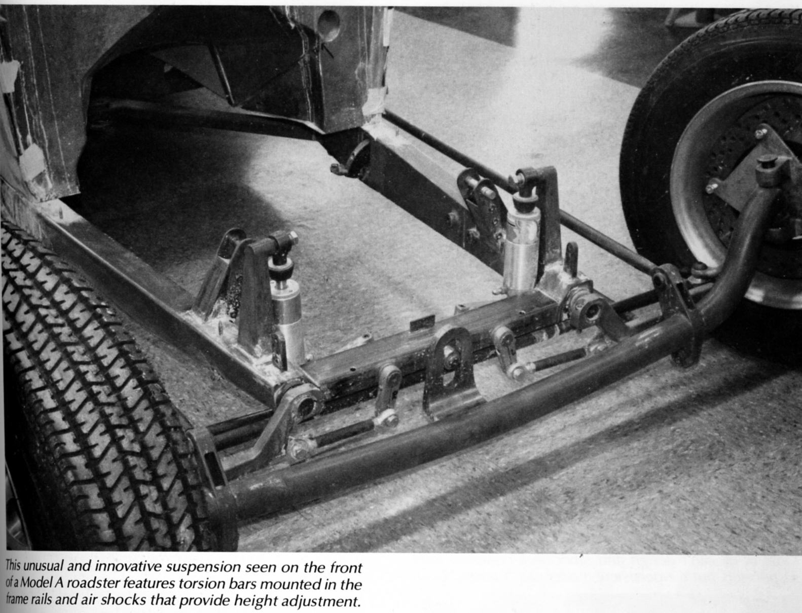

    No reaction or comment from anyone about the Model A Roadster torsion bar front end???
    Thought that picture would ignite some curiosity and debate. Maybe you are all too busy searching the net for more pictures and ideas.:) The HAMB has quite a bit about it if you search.

    Seen it. It's not anything new...

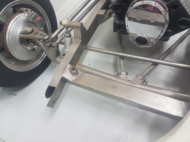

    Kinda' like this? I started building this '34 frame about 18 years ago, but got sidetracked over the years. Don't know how it was gonna work in practice, but I had it all worked out in my head at the time!:D
    Biggest issue is oilpan and tie rod clearance ( if you want to get a low ride height). Not really HAMB friendly, but more traditional than a Mustang 2! (By the way, this is at bottomed out height)
    I'll probably get back to it as a retirement project someday...

    Good example. Some may correct me here if this is wrong, but could the centre lower links be changed to a single wishbone arrangement with one attachment point on the axle and a semicircular (horseshoe) shape at the back to go around each side of the oil pan back to the rear side mounts? Sort of like -(

    Yes it can be changed to a true "A" frame.
    The main difference is the A frame has the roll-centre at the "exact pivot" and it never changes.
    Having 2 triangulated bars puts the RC at an imaginary point where the 2 bars meet [slightly in front of the axle] The RCH is dynamic [meaning it moves up/down when the suspension moves]
    Due to the cantilever effect of the bars being behind the axle and the RC in front of the axle , the RC will move upward during dive [hard braking] which would effectively stiffen roll resistance.
    This can cause induced understeer on corner entry with trail braking techniques.
    On a street car, a correction could be made by using softer springs [getting the benefit of a better ride] and the RCH goes up and CGH goes down during dive [increasing roll stiffness]
    If this scenario is switched to the rear [common theme on upper triangulated 4 link] the rear RC would move down more during dive softening the rear stiffness causing the rear to be "tight"
    The combined affect of front and rear Roll Couple would aggravate the understeer even worse.
    On corner exit, during acceleration the opposite happens, the front end will be "pointy" and the rear end will be loose [and aggravated more with torque applied to the rear tyres]
    If you like "hanging the *** out" on corner exit, this can be a fun setup.[but slower]
    Please understand, these traits only happen at the 100% limit of the tyre's capabilities. Any less than that and most drivers wouldn't even notice
