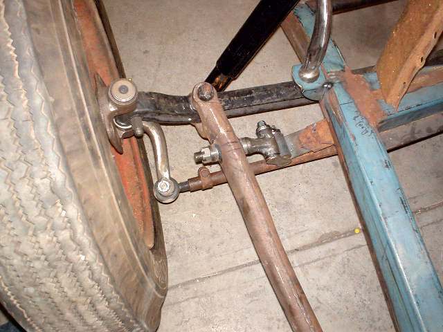

    67ImpWagon posted these pics in the Q&A section...
    I really like this setup...though I might do it a bit differently. I think I'll make my hangers wrap all the way around the bones. Maybe cut it from one solid piece, then after I split the bones, slide the hanger over the end of the bone and up to where it needs to be. I wouldn't have to worry about the bones getting weaker by drilling through them.

    Kustom & Rockets those were my wishbone hangers but of course anyone can copy them, thats why I posted them!
    Heres another photo:

    I don't care who's hangers those are....
    but those welds are scary!
    You guys better be tig'in that stuff!
    Yikes for sure. [​IMG]

    Thanks Levi, he didn't know who posted them originally either. It's a good idea, I like it!!!

    Yeah Visor they are ugly tacks! Will be cleaning them up latter.

    Yeah I was telling Elrod and KR about those mounts and had saved the pictures. I thought it was a good idea.I could'nt remember who posted them.

    I kinda like those mounts. I had cut some templates somewhat similar to them for mine but I made them drop lower so the spring hung below the bones. I ended up scraping the idea though.
    On mine I used spring mounts designed for a T bucket with a spring behind the axle set up. I got some with a 7 degree turn in them so the spring would not bind. I then made up a couple of threaded bungs and welded them into the wishbones. Then just screwed them in. The setup does work great and looks clean. I have had the car on the road for two years now and there is no evidence of stress on the bones or the perch.
