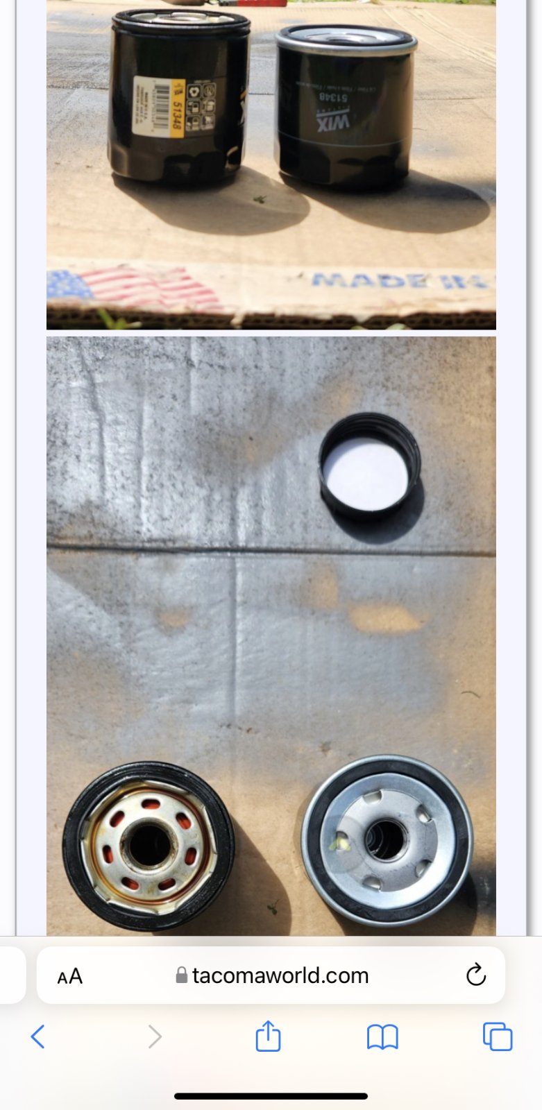

    From the pic the anti drain back diaphragm is right up against the plate. It is probably flipped upside down and doing its job, just that it's now preventing flow.
    Its a m*** produced item, there will never be 100% perfect product run nor a 100% Q.C. that will catch every fault.
    "Trust, but verify."
    I prefill my filter which gives me a chance to inspect the filters functionality. Fill the center hole to the top, a proper check valve will not allow oil to fully drain/fill the filter quickly unless drainback diaphragm is pushed on allowing air to escape allowing oil fill.
    If the filter is easily filled or difficult to fill I'll suspect something us internally faulty with the filter and not use it.

    The orange rubber is the check valve portion of the filter. I would say someone screwed up on their first day on the ***embly line. I am pretty sure that either WIX or the parts supplier would replace it with no issues.

    Doing a Google search of “Wix quality control for oil filters” shows all kinds of folks with quality issues. This one post from Tacoma World is interesting as it supposedly shows a new and old version of a Wix filter. Like folks commented, the new one appears to be inferior, and perhaps even a knock-off. Who knows, but one thing is for sure, quality is ever declining across the board as businesses care less and less about their customers in pursuit of the almighty dollar.

    So yes, the underlying message here is check the part before you run it.
    I took the offending filter to the parts store not expecting anything but figured I'd kindly let them know "hey you might want to give this to your Wix rep, this is what happened" They said they'd warrantee it back to the factory and promptly refunded my money. So that's good! More than I expected.
    Out of curiosity I did take the previously run wix filter to the band saw and didn't find anything that wasn't expected. I'm done. Lesson learned and thankfully no damage was done.
