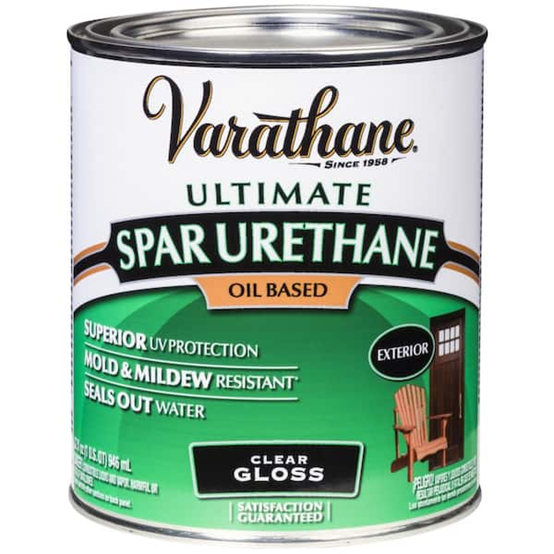

  10. jnaki
    Joined: Jan 1, 2015
    Posts: 11,671
    jnaki
    Hello,
    We have used this product or variations of it over the years we have worked with wood. When my wife and I had an old folding oak high chair we purchased at an antique dealer. We had to strip it, then coat it with polyurethane for a strong finish.
    The three coats had fine sanding between each coat and it looked like natural wood, but we knew it was well protected. When our son was eating “his foods” in his hands or tray surface, the sealer was almost non-destructible. When we gave him a baby fork and s**** for his bowl items, he could scoop them up and if one fell on the surface, it just stayed there until the fork came banging down. We both, initially thought of holes in the surface and were amazed.
    When we looked at the surface, not one scratch or mark where the baby fork hit repeatedly. Durable is shown in the coats I had put on to the surface. When the high chair was in the low position, he could not tip it over and most of the time, he liked being close to us as we worked in the kitchen and he was right there doing his toddler thing… in a well protected high/low chair.
    Jnaki
    So, what did we do after he was finished with his “eating style” in his chair? Well he was cleaned, first and now I took the high/low chair outside and hosed it off. The splatter of foods came off instantly and not one scratch or mark was anywhere to be seen. The sun dried off the items and yes, even the small metal wheels were coated with the hard liquid coating to make it one fast spray to clean off every particle that got into the stray spots. YRMV
    Note:
    Since those early days, we have used the same polyurethane in upgraded variations. The wood surfaces on our long line of sailboats wooden rails, doors, and hatchboards were well preserved. They lasted a long time in the harsh salt air/water splashes, constant moist air attacks daily and nightly, plus our constant bumping left no marks on the surfaces. It was one tough surface protection.
    No need to mess with any other oils or finishes. The polyurethane is the one always on display at hardwoods stores. The Varathane brand is probably the most reliable and strongest product. Minwax is also very good. For boating surfaces, those are good coverage products, but not as strong as the Varathane products. I still have one can each.
    Oil based is stronger than water based.
    1952henry and alanp561 like this.
