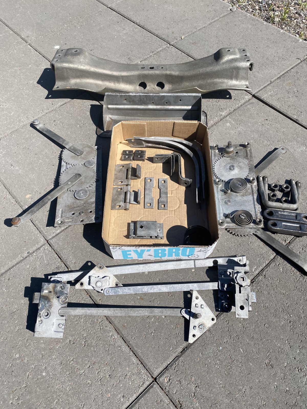

    TheTexas dry rust was a pain and it took a full day remove most of the bolts.
    I still strugle with some ( ex on one door its 2 of them try to stay there...
    I did use heat, oil and going back and fort.
    Wood was not easy get rid of either, hundets of small nails.
    Question.
    Where its best way find all this special screws/bolts to doors, wood, dash, door handles etc and the wood.

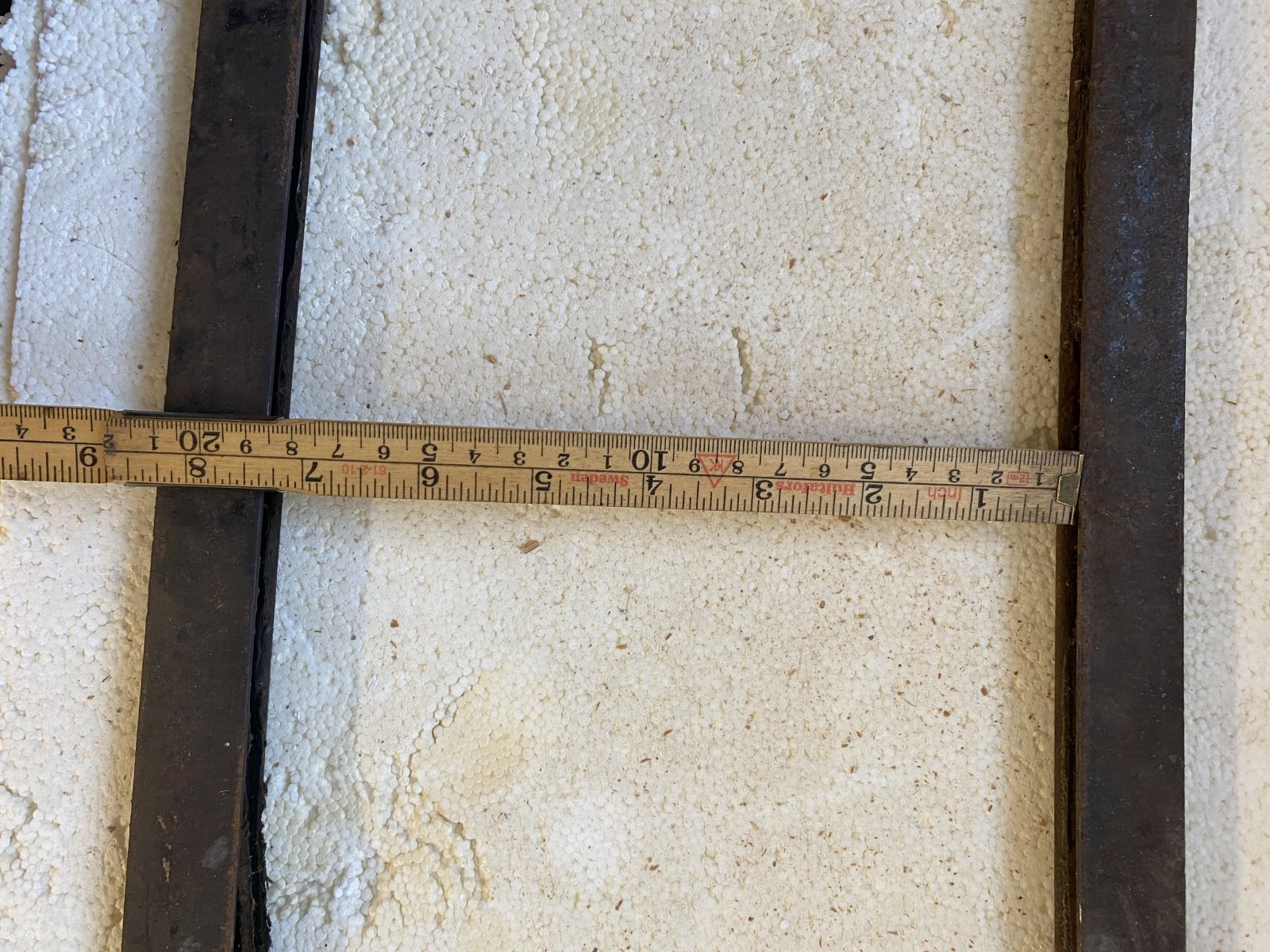

    I'm 1.82 cm ( 71.65" ) and the seat I got with the car ( std but tuck n roll = now sold ) but at this chop it was working at my height but not much more.
    Side window std is 13" on a 5W but here its around 10" so its 3" chopped, but it might be 3.5" when body guy is done. Front window ( gl*** is = 7.5", se picture )
    I don't like go 4" or 4.5", even if I use bomber seats.
