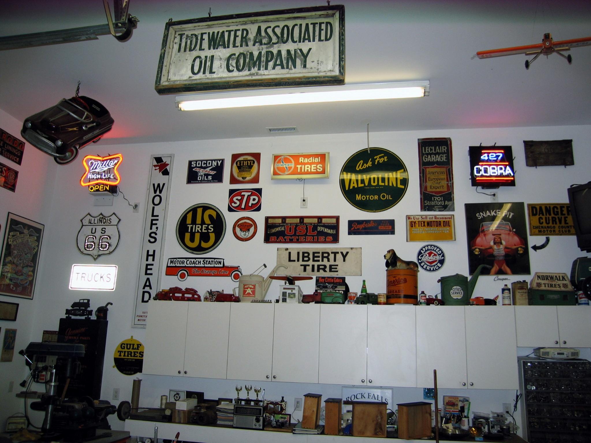

    I'm sure I have them,somewhere, but here's a brief view of one wall.
  7. HOTRODPRIMER
    Joined: Jan 3, 2003
    Posts: 64,878
    HOTRODPRIMER
    That's cool!:) HRP
