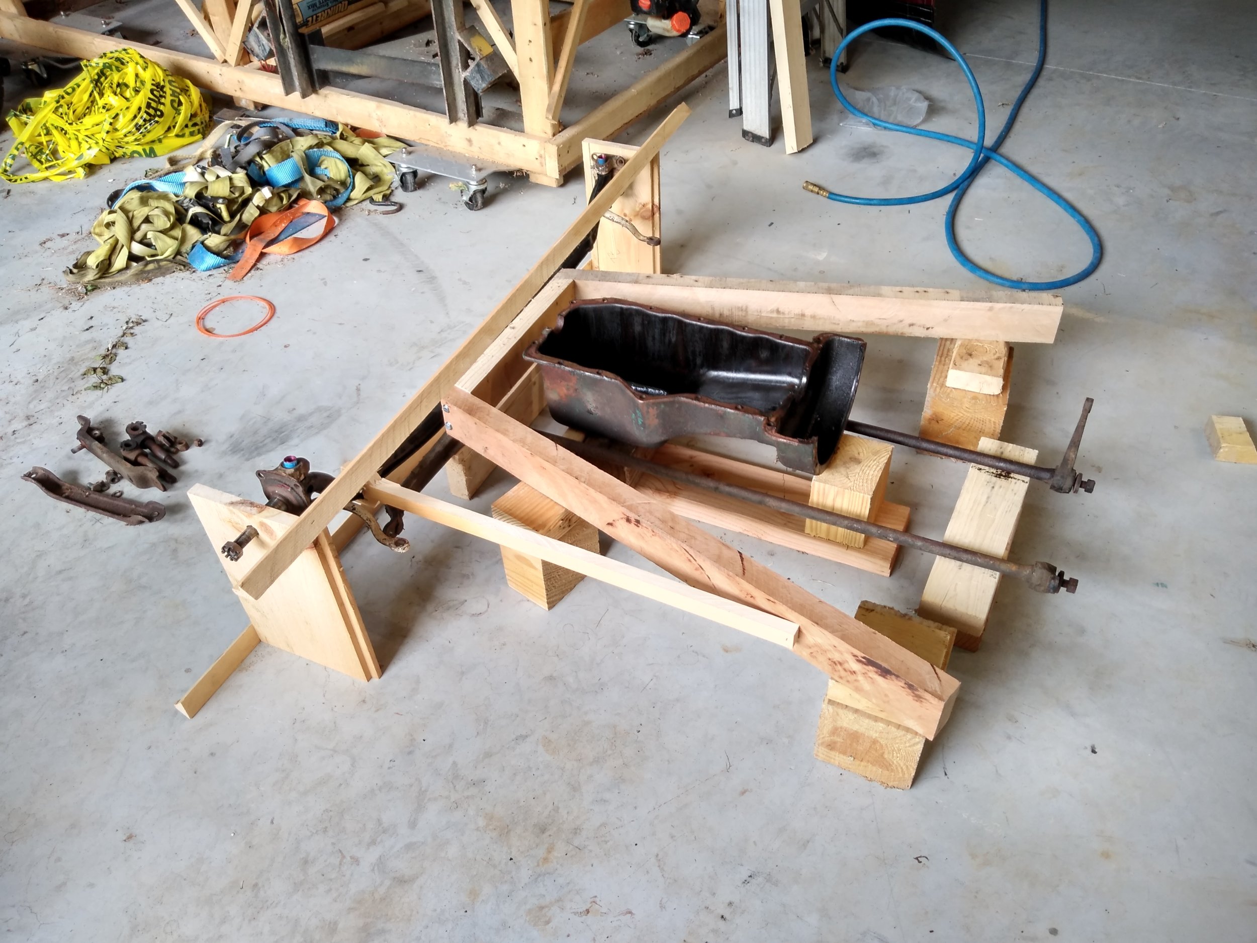

    I've currently got my fuel cell propped up on a pair of 2x4s so it's level and the sump isn't hitting. Does that count?:D
    It will eventually get proper mounts made, but a selection of 2X4s and 1x2s is invaluable in the shop. Some 4X4 is useful too for bigger, heavier stuff.
    I don't have a nice selection of woodworking tools so the fine model making isn't normally part of the process.

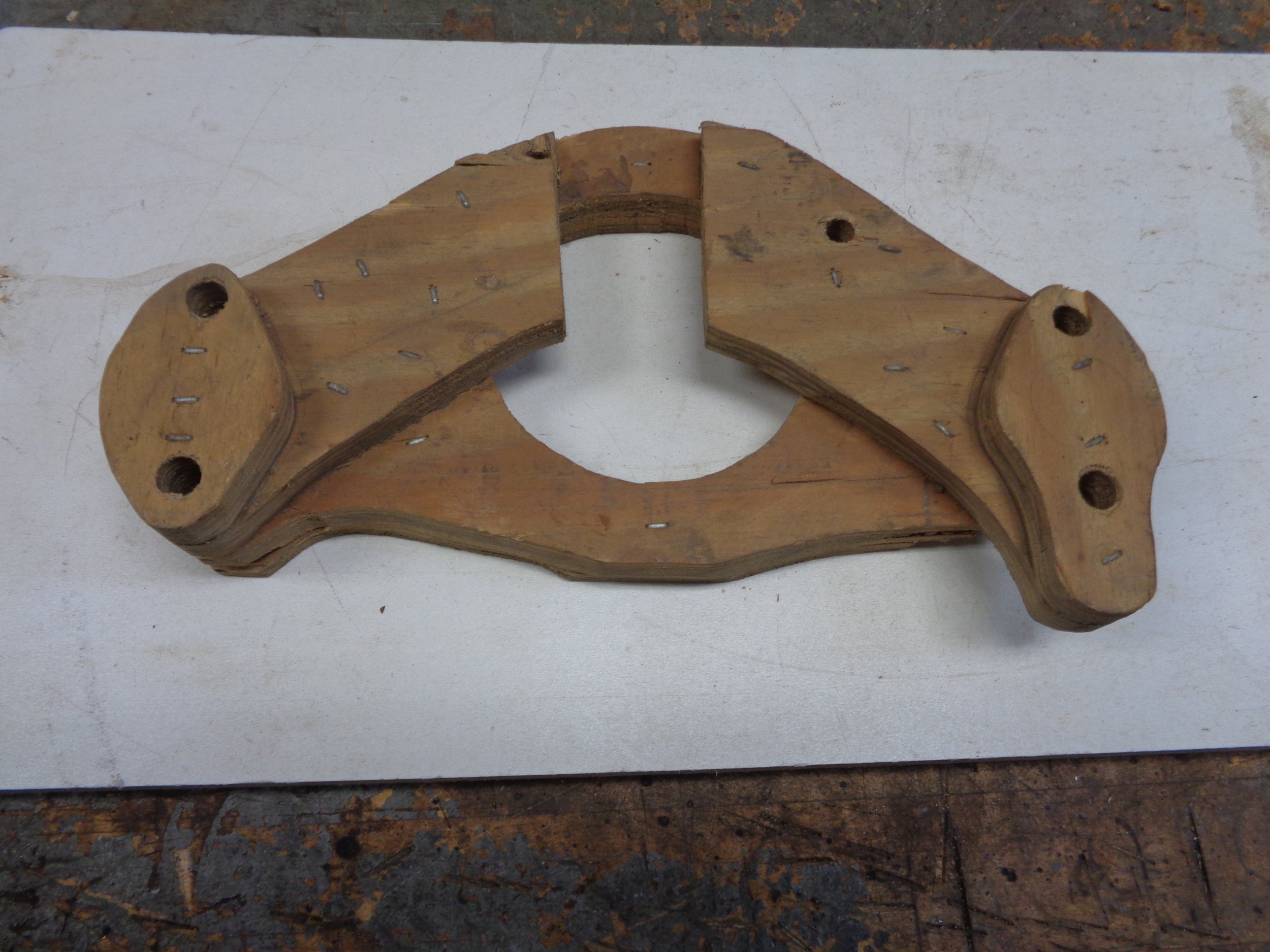

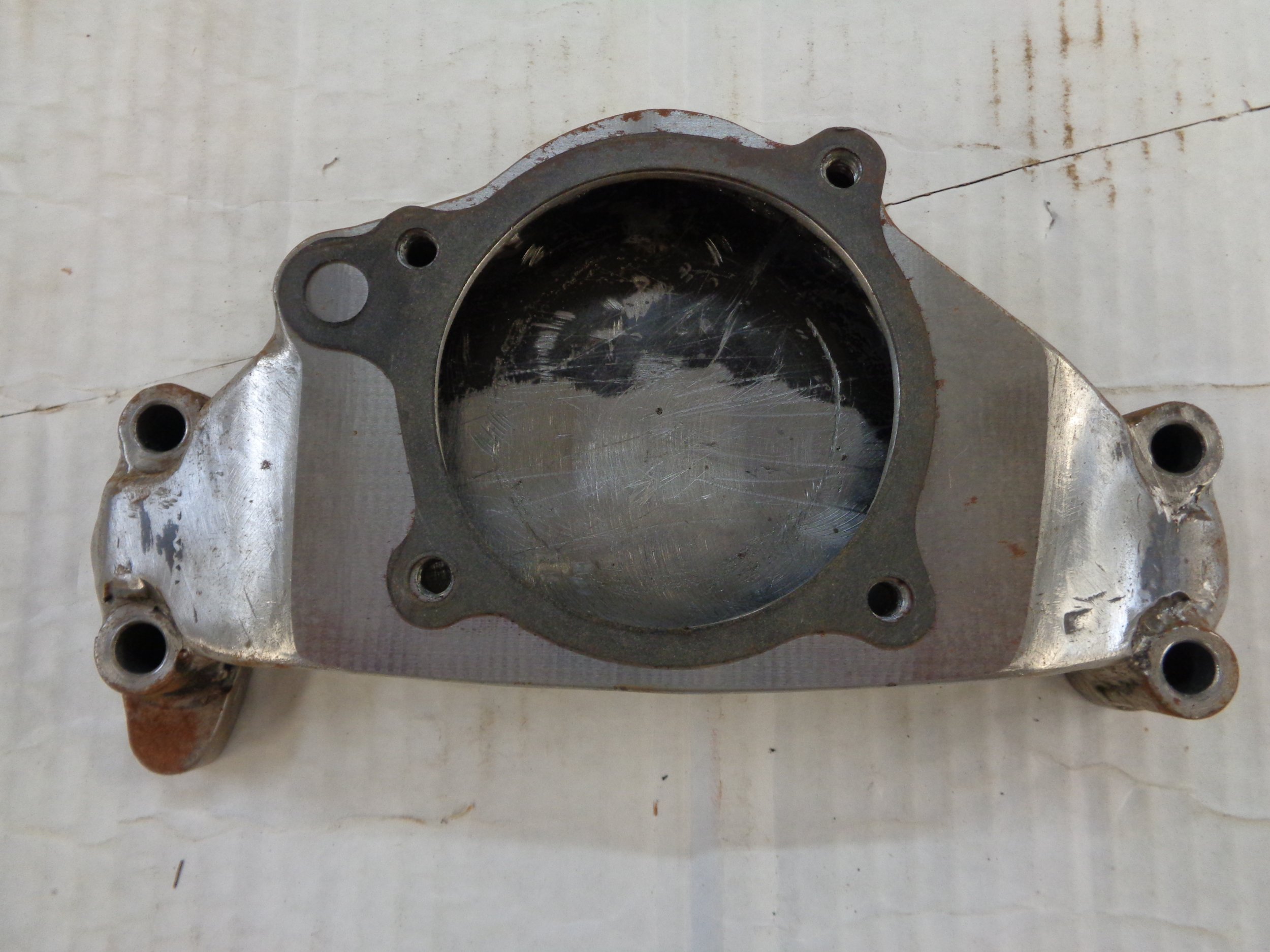

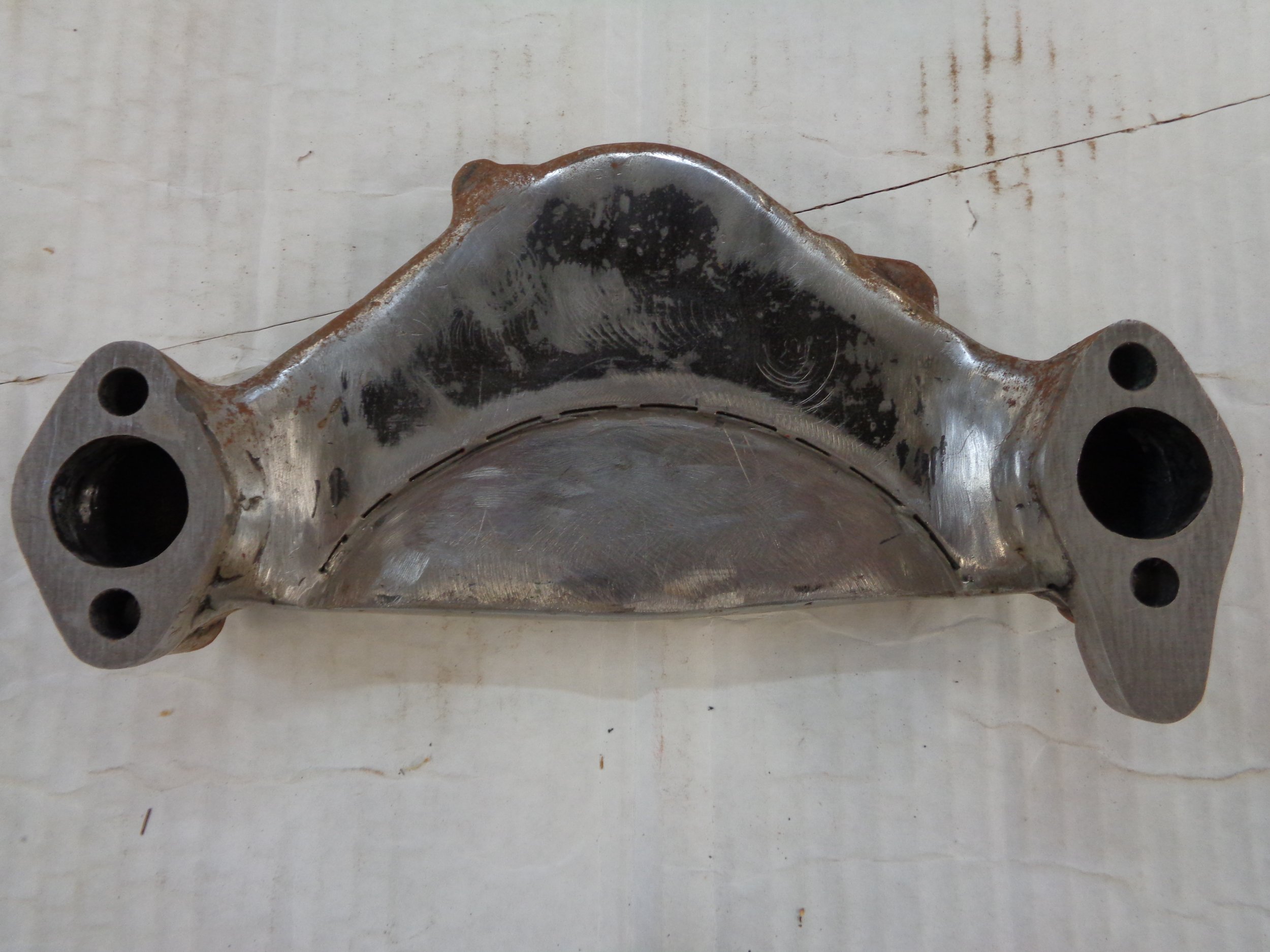

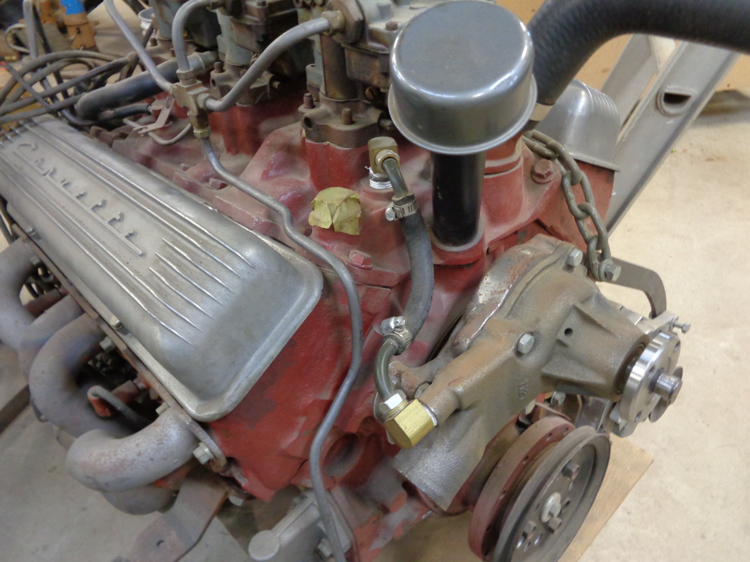

    Rough mock-up/proof of concept for 1" water pump riser.
    Front
    Back
    Finished riser, sans paint
    Front
    Installed

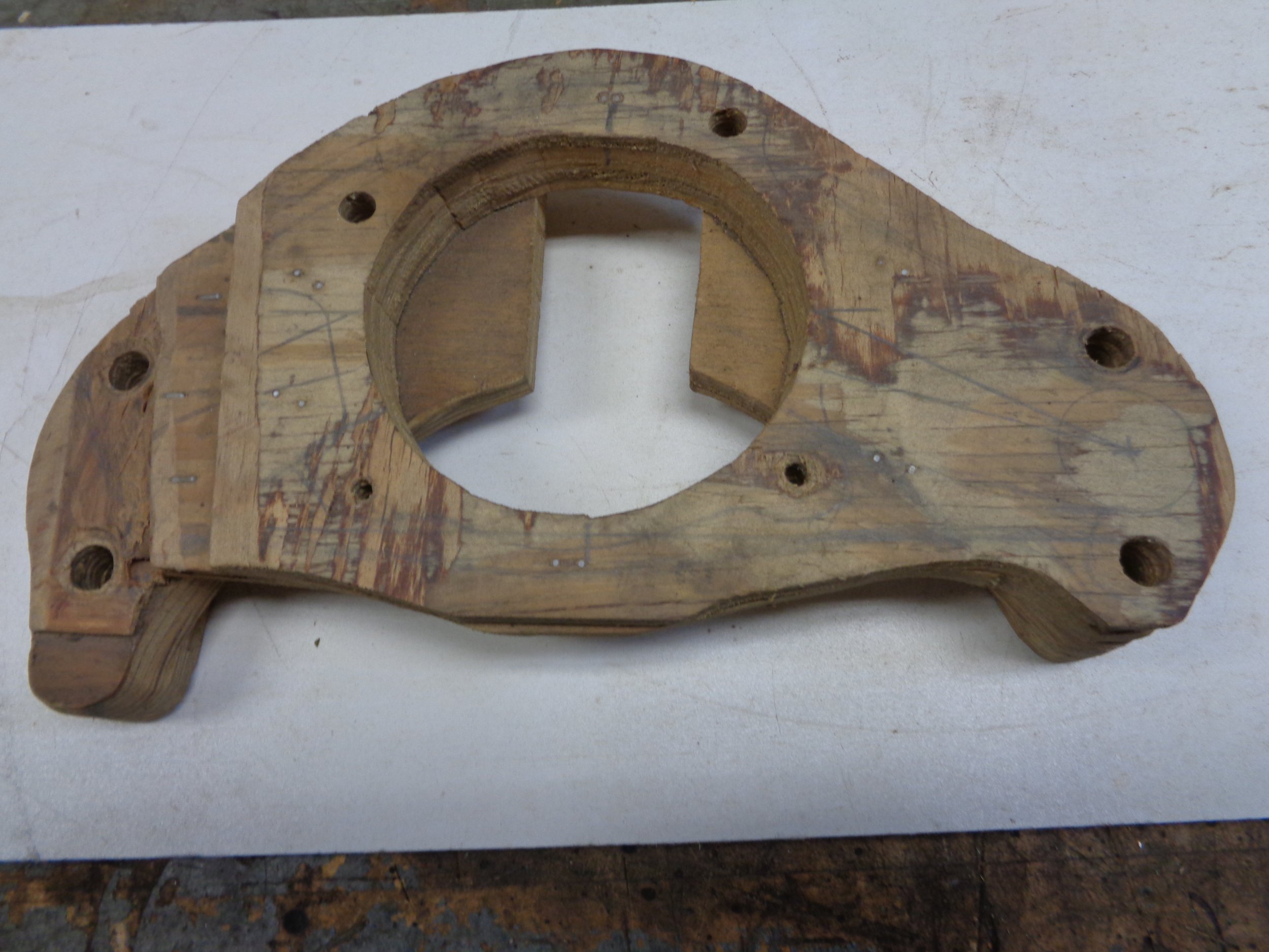

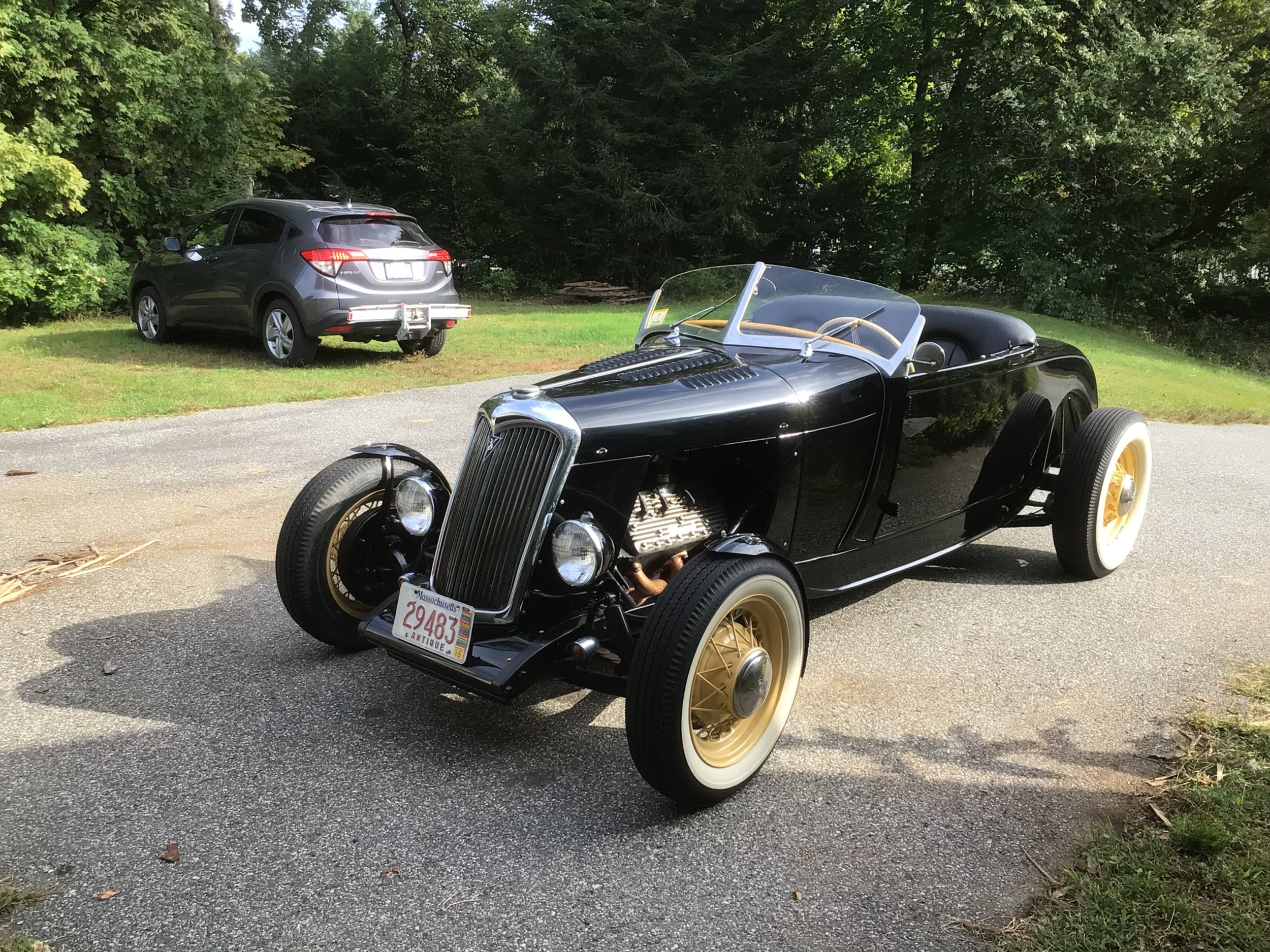

    IMG_5633.jpeg I made patterns for my windshield, first in cardboard, next with 1/4” plywood and finally in pine. My patternmaker friend added a bit to compensate for shrinkage and I brought the patterns to a local foundry and had them cast in aluminum . IMG_5448.jpeg
    Way more than 2 pieces. If someone wants build one here is my basic process.
    Stood a spare block on the floor with 4 bolts and jamb nuts in the bell housing holes, leveled it and marked the spots on the floor. Bought a digital level for this.
    You need the water pump and pulley you are going to use on hand because they are not all the same. (I had an old used pump someone gave me. Bought a generic pump for it and my pulley hit. Found out I had a 79 PU 250cid pump. The SBC pulley works on this with out hitting)
    Mostly material from my s**** box. Had to buy the 3/16" plate for the main body.
    All welding done with the riser bolted to the block.
    Took the back off an old SBC water pump so I could mimic the necessary cross sectional areas.
    Half inch bar stock for the bases with drilled out heavy walled 3/4" tube for the bolt bosses.
    Rear plate was cut out to include the sides. Then cut slots on the bend lines leaving 1/4" uncut tabs to maintain alignment and welded the slots shut. Bent the ends of the rear plate to fit up to the bases/bolt bosses and welded.
    At this time I made the cut out in the back to clear the timing cover and welded in the piece of 16 gauge. If I was doing it again, I would leave the back solid and put a 1/4" spacer behind the crank pulley instead of the 1/8" I had to use use. Of course if the lower edge of your riser is above the timing chain cover you can go as deep as you need with out spacers or cut outs.
    Use the level to trim the sides to parallel with the block.
    I cut out the top plate following the upper contour of the water pump and leaving a couple of tabs on bottom to rest on the sides. Also, weld nuts on the back side for the lower water pump mounting bolts.
    Lay the top plate on the riser and mark where the top water pump bolts will intersect with the sides. I had a piece of 5/8" rod, so at each location I made starter cuts into the top of the sides to mark where the rod would be welded in. After the top plate was welded in these cuts are finished into slots for the rod, which after it is welded in, is drilled and tapped for the top water pump bolts.
    Clamp the top on, using the contoured top and the small tabs on the bottom to keep it from falling in, and use the level to check that it is parallel to the block in both the X and Y axes. Then it is a game of tack and check. Getting the ends fitted is a matter of heat, hammer and cool several times.
    Last piece is a small reinforcement under the bump out for the unused by-p***.
    On the water pump I drilled out the heater hose connection for a 90* fitting to run a byp*** back to the intake.
