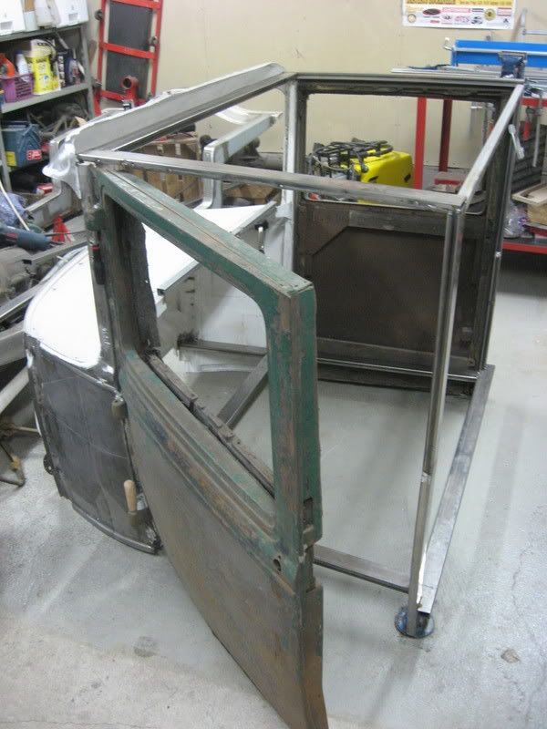

    I am starting to replace all the wood in my project with steel. This is not going to be fun. Does any one know any tips that might help.

    measure twice, cut once.
    its time consuming, but not a huge deal. make sure your car is SQUARE before you start... :D

    Square.... the damn thing is in pieces........
    I think I will be fine I knew this was going to be the worst part of the build.
    I am happy to be replacing the wood with steel. I can work with steel. I always mess up wood.

    Slave the pieces together on a relatively flat/level floor. Tac-weld the doors in place. Fab stabalizing structure to hold in place and then tweak to form a shape. I use mostly 1 inch square tube and 3/4 inch square tube. Tack weld everything, don't final weld until you are confident of fit and alignment. That makes do-overs easier.
    AFter the cowl/body form is rigid, you can remove the doors to make access and work a little easier, keeping in mind that when welding things tend to move from expansion so refit the doors periodically to ***ure things aren't getting too far out of shape.

    Thanks guys. I got a few pieces made and a good game plan now. It helped alot to start with the floor first. I'll post some pics later.

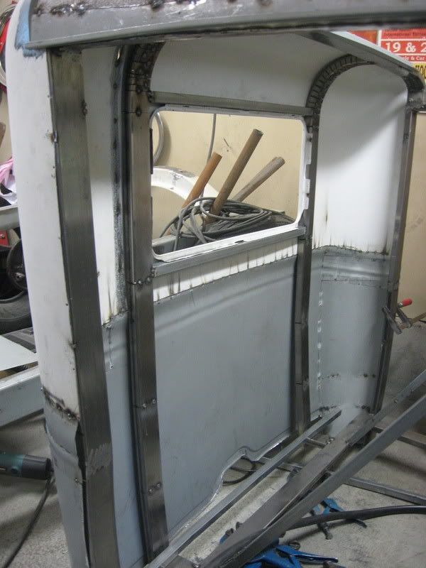

    My project was only pile of rusty parts, all wooden parts were only a memory from the past... so I decided to do them all over again, and use material that would have even some kind of strength if I ever (get this car on the road and) crash into something.
    Every other pic is linked.
    So, we bent some 20x40x2mm tubing
    Shape of door was copied and tacked to that place
    http://i23.photobucket.com/albums/b352/OttosGarage/Project -31/IMG_0510.jpg
    Shape was copied and seams fully welded
    Seems to fit...
    http://i23.photobucket.com/albums/b352/OttosGarage/Project -31/IMG_0515.jpg
    Then comes part where you need garage with even floor, measuring tape, and time... possibly also cigarettes? :D
    It is important to measure everything from corner to corner. Everything effects to everything...
    Bent tubing was also fitted over doors
    http://i23.photobucket.com/albums/b352/OttosGarage/Project -31/IMG_0844.jpg
    I'm skipping a bit... But here you'll see inside sheetmetal.
    http://i23.photobucket.com/albums/b352/OttosGarage/Project -31/IMG_2026.jpg
    Not happy with those tubings which are apart from sheetmetal under rear window... gotta alter 'em. Also, I'm thinking to build pieces from door to door to get more strength.
    So, that's it. Hopefully this gives some ideas?

    I thought I would post and update since it has been a while.

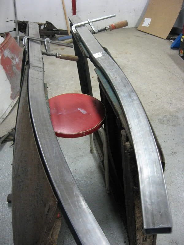

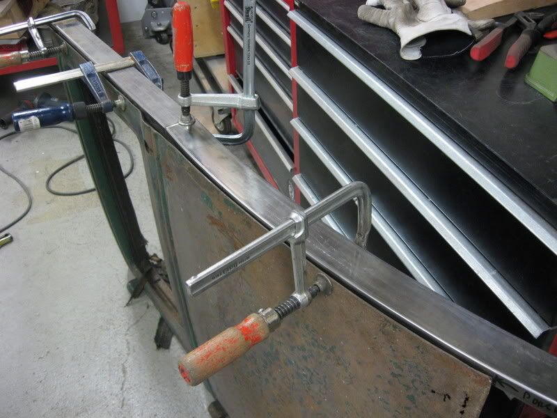

    It has been a while so I thought I would give ya an update. Here are a few pics so far.
